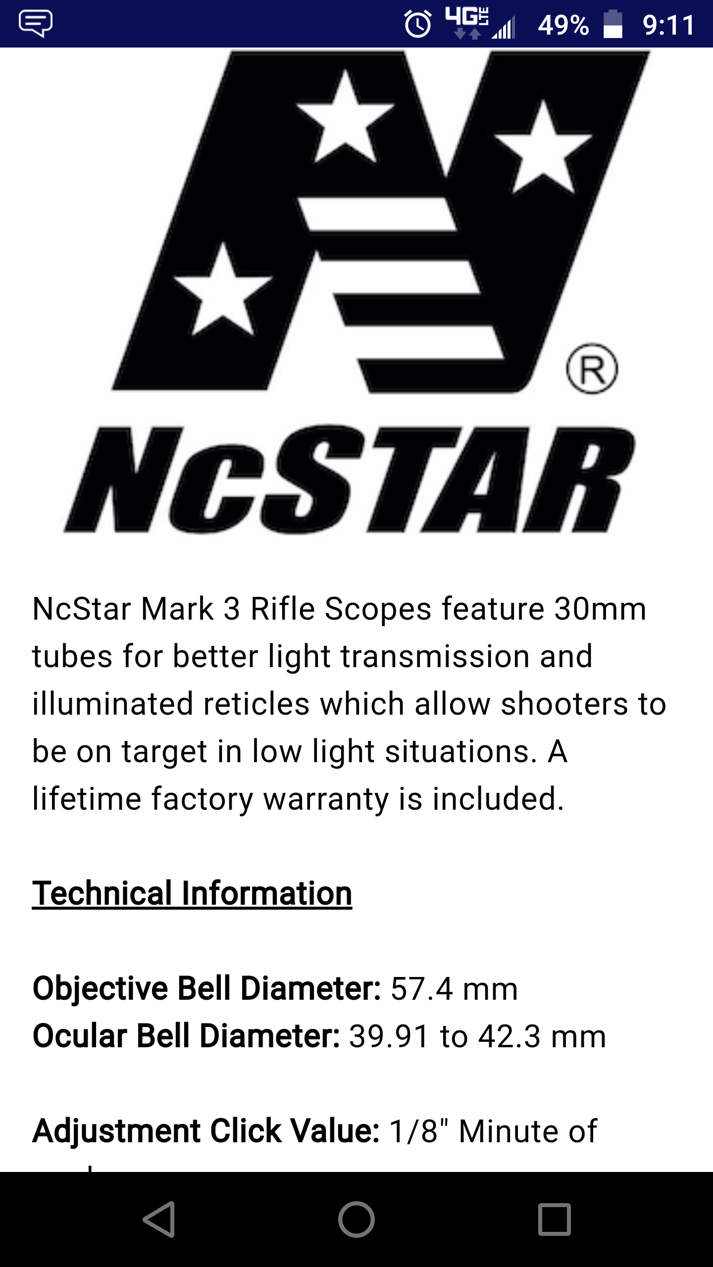

I’m far from an expert here, but my immediate thought was that the OP was shooting using a second focal plane scope. Changing points of impact at various magnification levels is exactly why I don’t like them for hunting, especially for short to medium-range hunting. The necessity of learning and writing down various holds for different distances is a bit much. Remembering it all is quite the task. Imagine that it creates a similar task for those that like to dial turrets.

Your center zero should not change with magnification. If it does, you have a bad scope. If you are using the Mil Dots or ballistic reticle for holdovers with a second focal plane scope, they will only be accurate at one power level.
Agreed, center stays centered but the dots no longer represent the same placement.

Ill try to read everything here and understand it, all i want to know if the scope im using is broken or if this is normal with a sfp scope. When I put my ffp scope back on i hit where i aim on any magnifications, thats not possible with my sfp
It sounds like the scope is bad. There's a factory lifetime warranty, so sending it in would be ideal.
