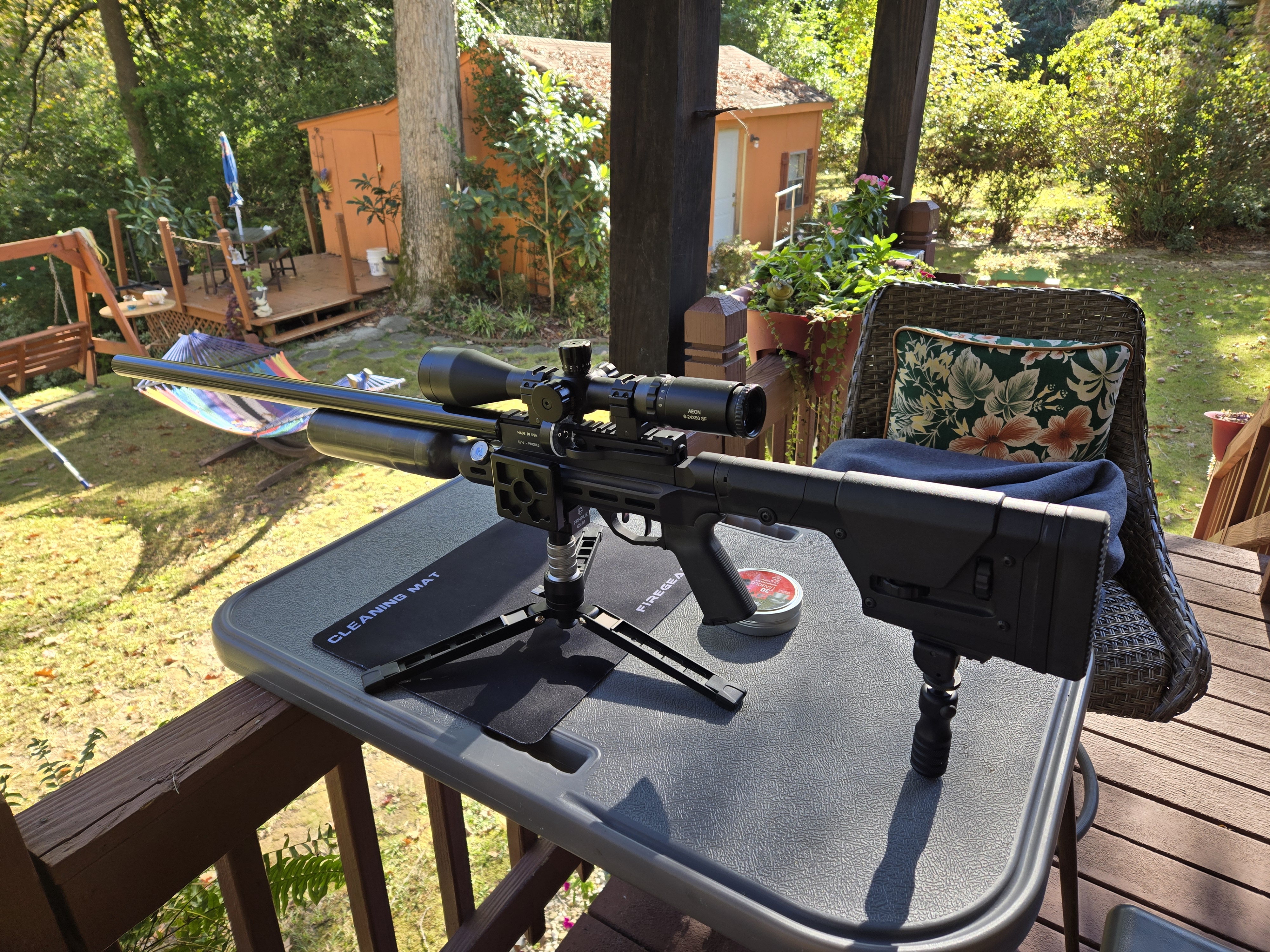

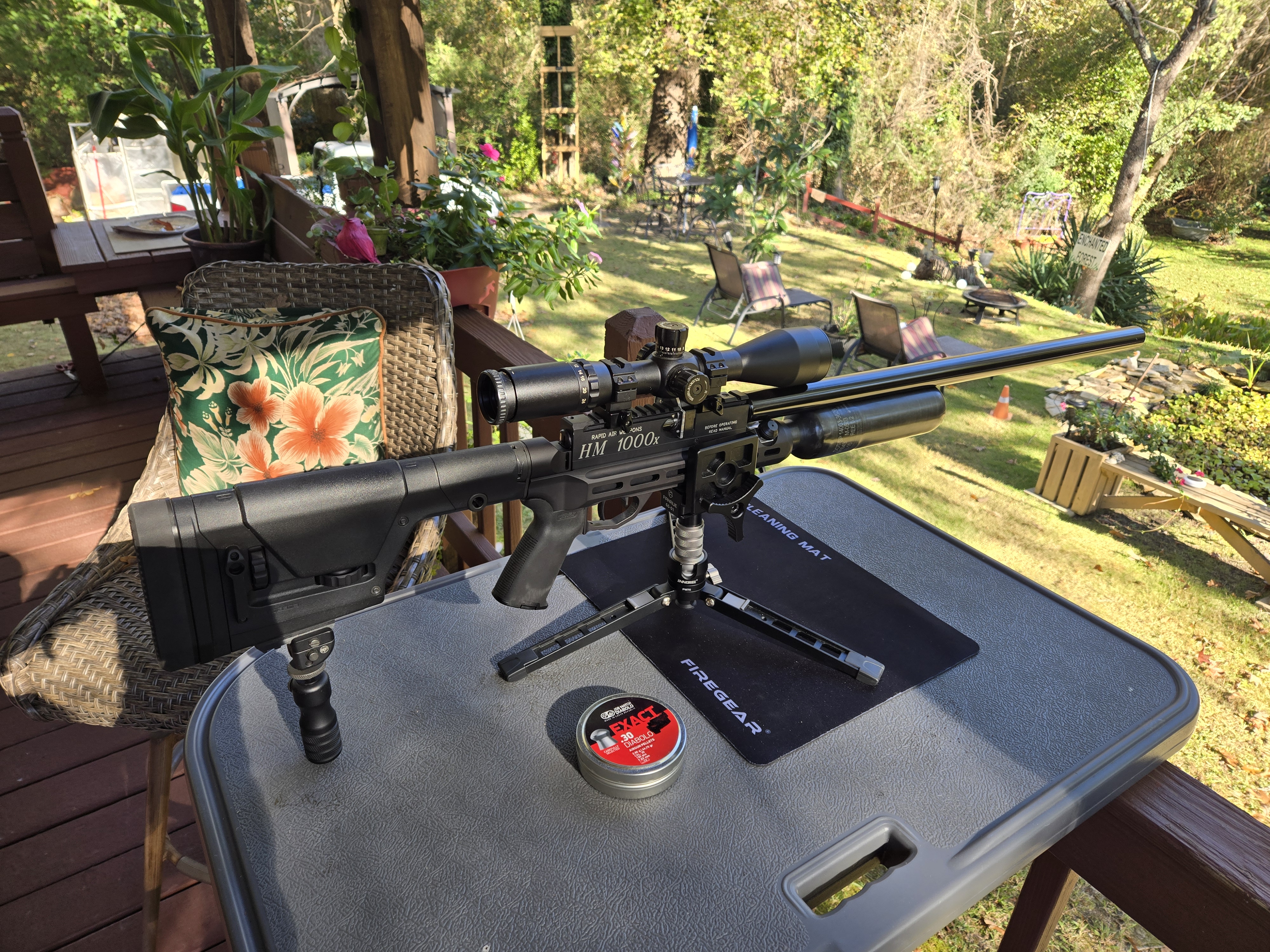

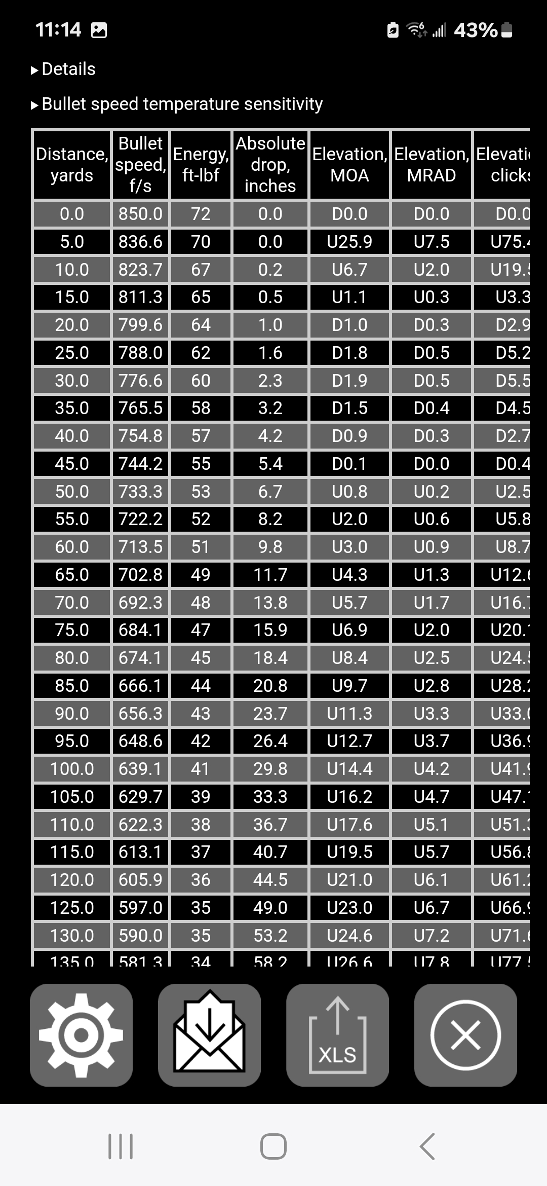

My Raw 25/30 setup by AZ. Both barrels shrouded . Reg @ 160 for both. Just swap and both shoot lights out.

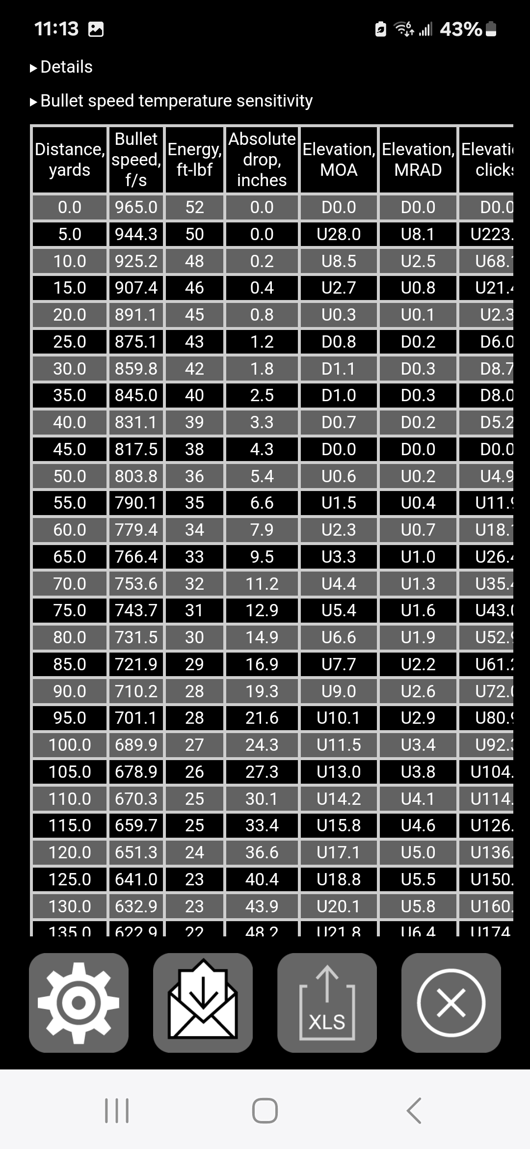

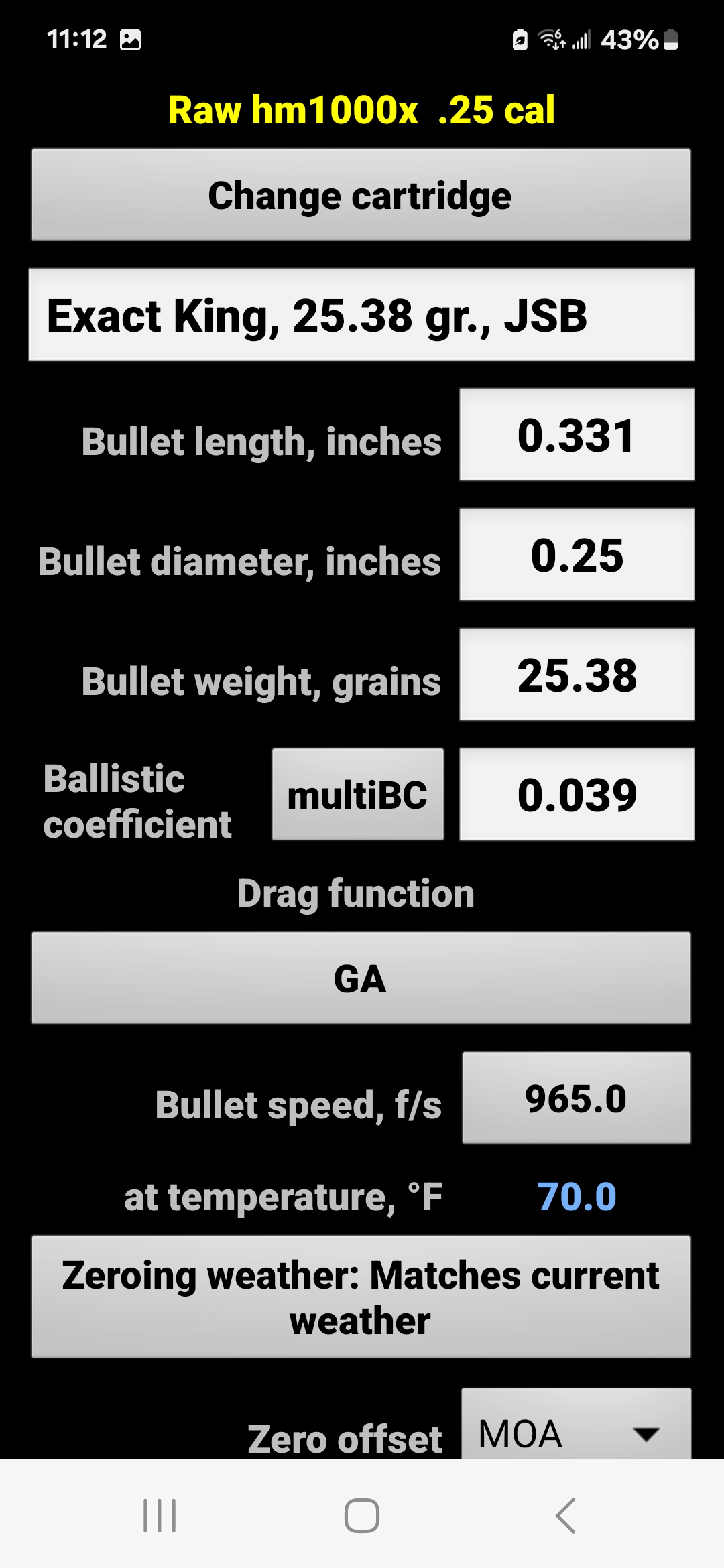

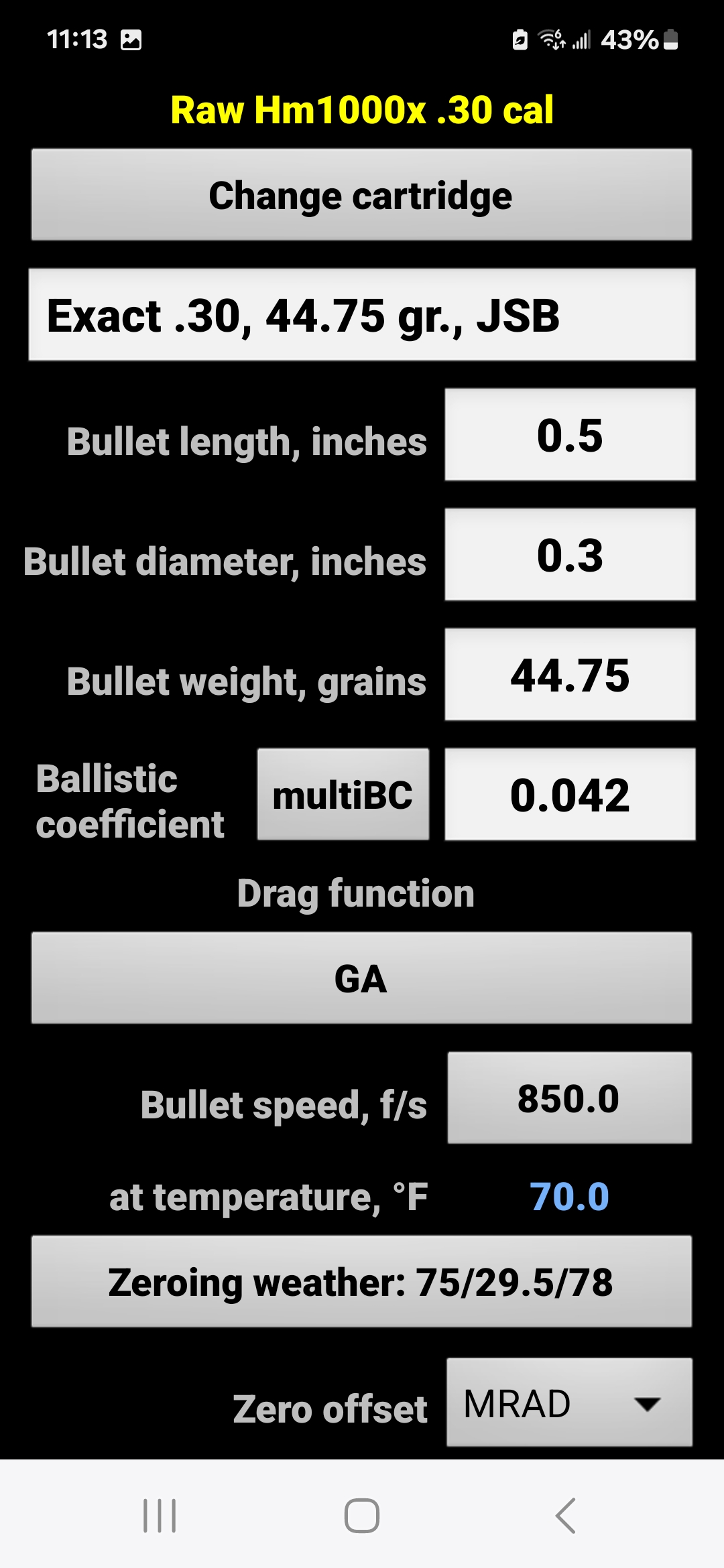

Ok thanks,
in your .25 it does 52 ft-lbs that is about 70 joule
In your .30 it does 72 ft-lbs, about 98 joule.
My reg is at 150, so I will try it first without changing the regulator.
As my .25 does 79 joule joule I can assume that in .30 it does about 103 joule. A bit over 100 joule that is more than sufficient.
