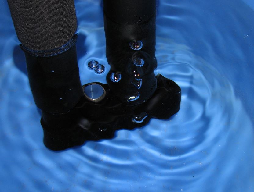

Guys on the Edgun Facebook page suggested submerging the detached stock in a tub of water to locate the leak.
Has anyone done this? If so anything I should know before proceeding?

I just fixed a leak that I created by changing the upper tube and cutting an oring during reinstallation. It was a very slow leak and would lose 50 bar over a week. I filled my bathroom sink in water and submerged it. Found the leak right away. Just make sure to get rid of the water when done. If you have a hair dryer at home , they work great for exactly that.

Just don't use hard water, it may scratch the finish :eek:)
Start with the easiest part to dry out, the back end - then the front end with the valve housing, after that I would recommend to take the valve housing apart to dry the water out and lube it up again

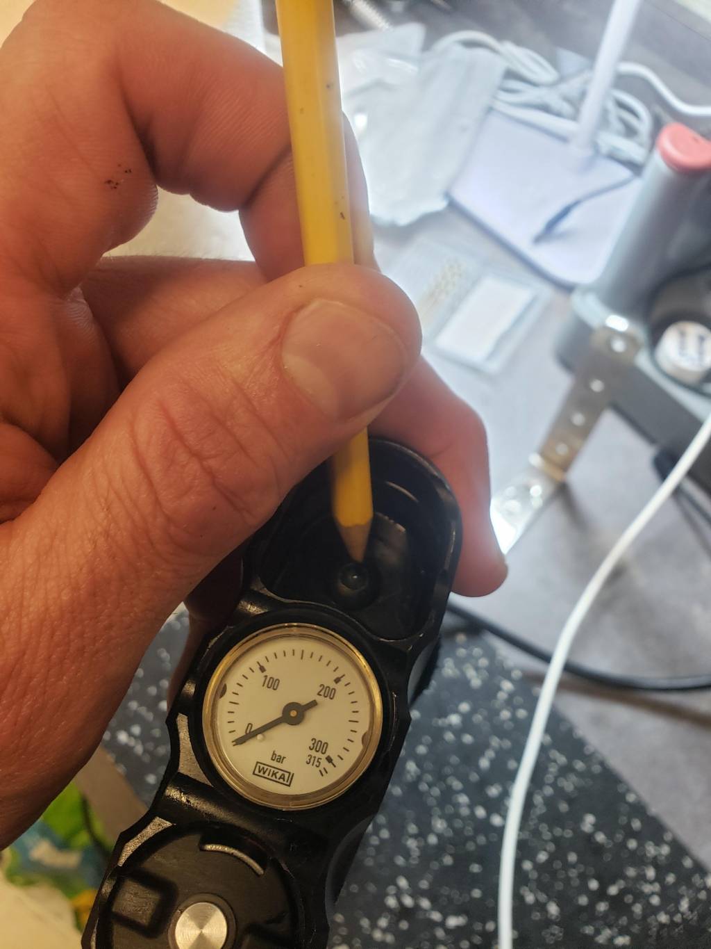

Okay found the leak. I'm getting air bubbles around this bolt.
I changed those O-Rings on my last tear down. Perhaps I damaged one when putting it back together.
Either way we will see if it holds air this time.
I had the same problem. This is the weakest spot of this rifle. I wish there was a threaded connection instead of slip joint. So if you connect single point sling to the buttstock, the whole wheight of the rifle with equipment is held just by that slip joint holding with ONE 4mm screw? No bueno.
