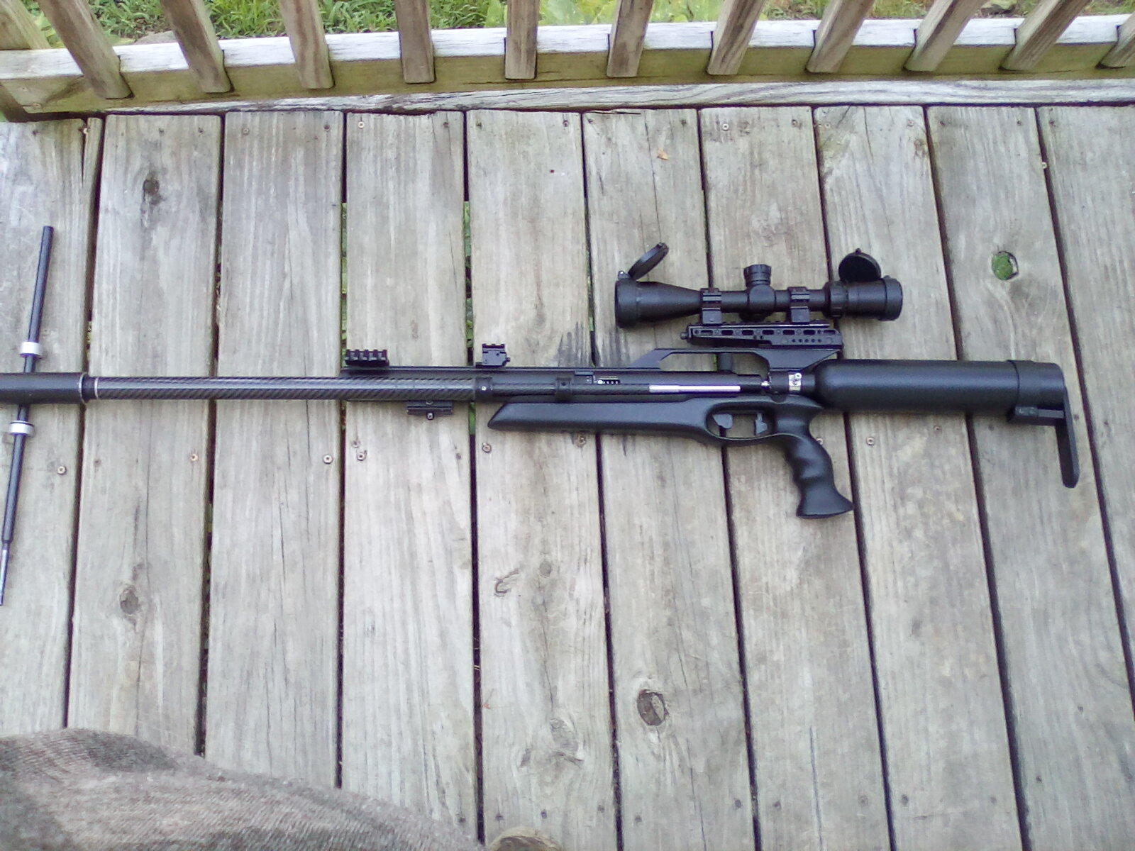

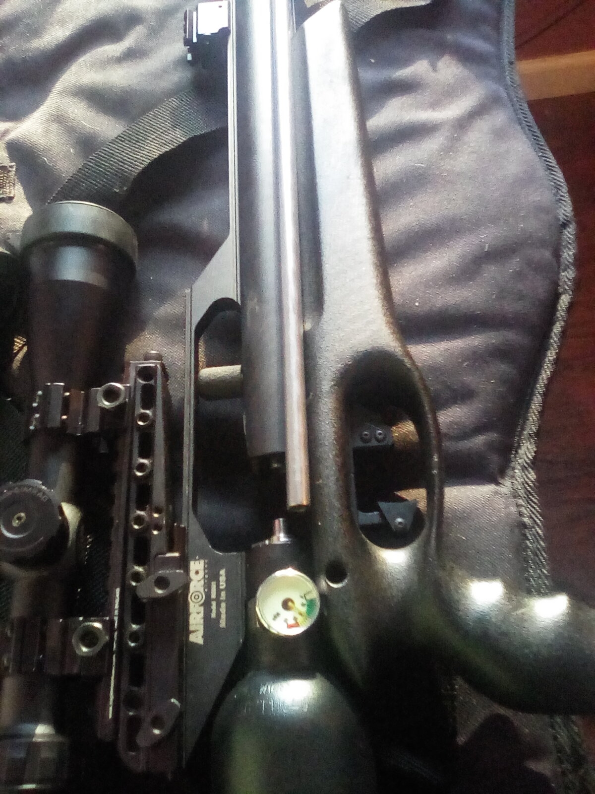

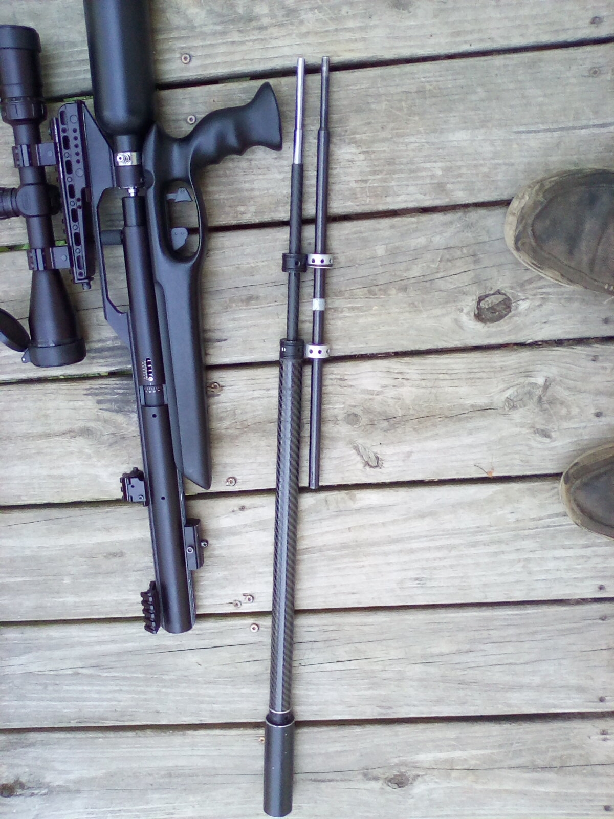

I been wanting a fast twist slug barrel for my Airforce Condor.. Been watching several different barrel liner manufacturers and green Mountain barrels too... I have a lathe but I really didn't want to turn down a 1.00 plus barrel. I wanted atleast 28 inches... So Chaszel .224 barrel liner at 28 inch long and .386 diameter 12 twist was $68.00 plus shipping... I'm going to sleeve the barrel full length with a 10 mm I'd and 12mm od carbon fiber sleeve....Thread the barrel and get a 3/8-24to 1\2-20 thread adapter.... Then sleeve barrel again with full 1 inch carbon fiber sleeve to barrel bushings and tension.... I'm hoping the 12 twist will work out...I'm wanting 1050 fps with hopefully 45 to 60 grain slugs.. I will hand lap.the barrel liner.... I bought this liner because of the price,length, and twist rate....Will let you now how it works out....

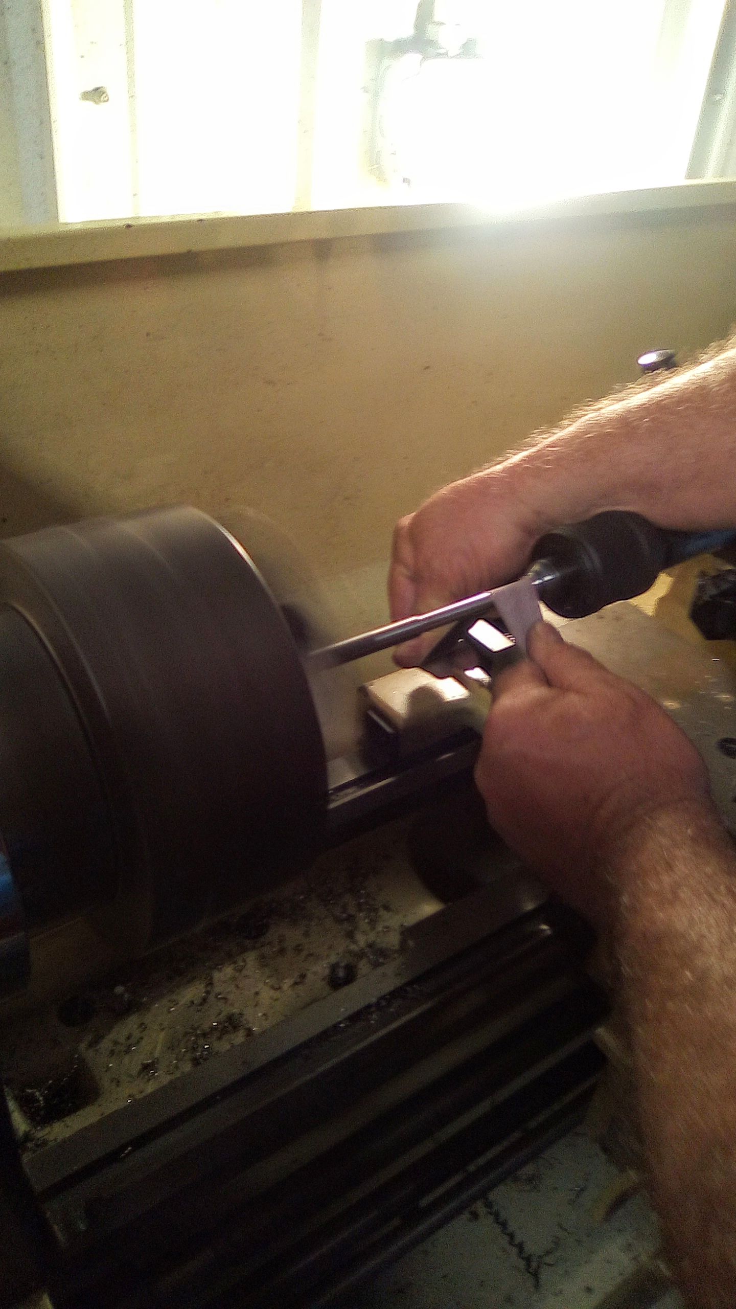

I bit the bullet and finally bought a bigger CNC lathe. Not specifically for airgun stuff... but being able to turn down barrels was a bonus. I just finished a 27" 357 barrel yesterday so the previous barrel will be a test dummy for my first try at lapping.

I have a jet 13x40 lathe..It's good for most all.threading and reaming I need...But........Turning down a barrel takes hours.... Slow....That's the reason I bought a barrel liner instead of regular barrel...Stepping out of my comfort zone.lol. Practice hand lead lapping.on your old barrel. Heat lead in a small ladle.and pour directly in barrel...Use.regular valve.lapping. compound start at120grit,220 git, 320grit...Here to help😀

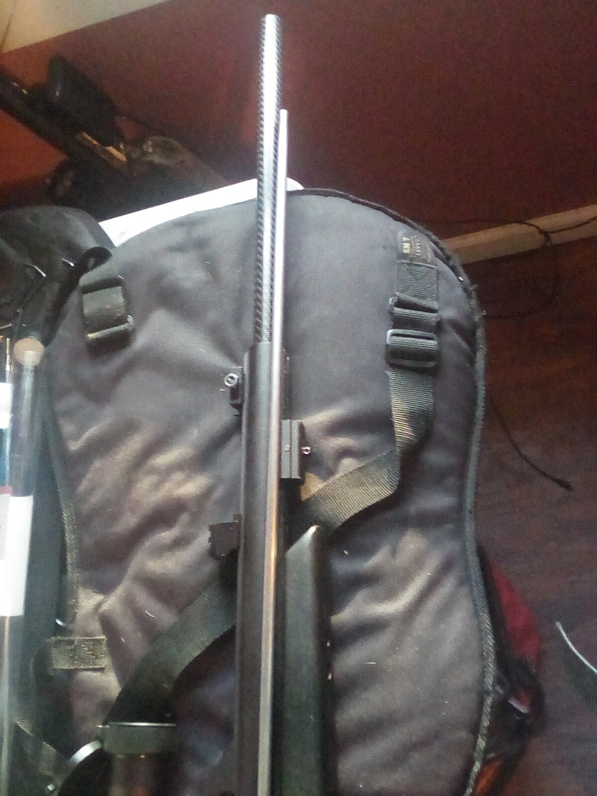

I received my Chaszel barrel yesterday... Fast shipping good packaging.... It's interior bore was exactly as I would expect from.a.normal production grade barrel....on par with green Mountain or ER Shaw barrels.. It was crowned and chambered for LR...I'm just going to.cut off the 22lr chamber and use its throat..Only loose.under half.inch of.barrel.. So.will get 27.5 inch finished length 12 twist....It was supposed to be .224 diameter but it is..222 diameter.... That is fine...I just have to buy my cast molds.and sizeing dies accordingly... It had a little chatter in rifling at.both ends, nothing horrible... I hand lead lapped.for 3 hours last night.......120grit,,,220grit,,and 320 to.finish..... The Chaszel $68.00 22 barrel blank looks and feels.like a Krieger or Benchmark barrel...Waiting on 10mm to 12 mm Carbon fiber 1000 mm tube to fully sleeve barrel liner in...
