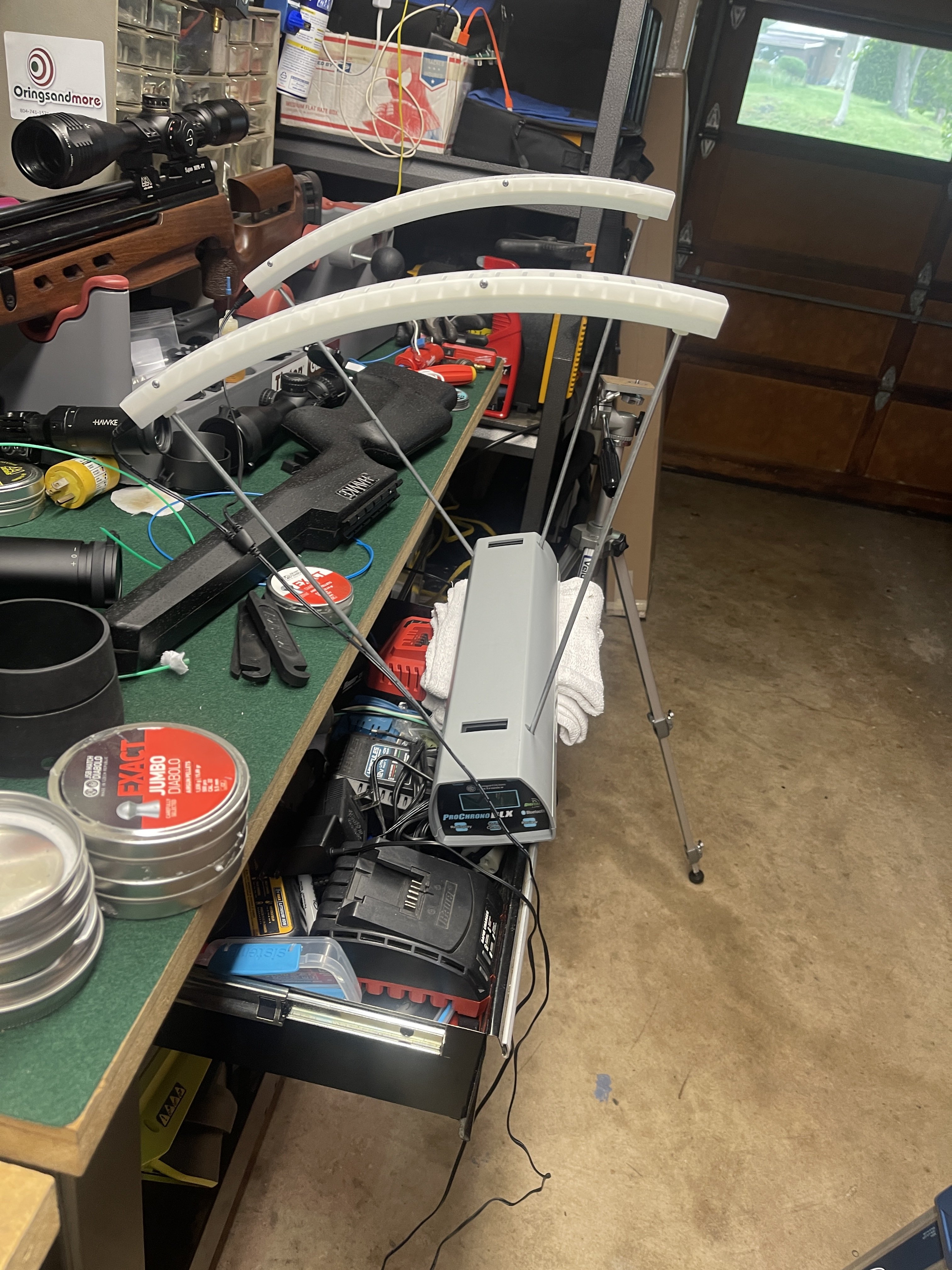

I bought the little chrony off aliexpress pictured below. I think I paid $28 shipped. I set it up inside the sensors on my Pro Chrony Digital and fired about 50 shots. The readings were, amazingly dead on. The farthest descrepency was an astounding 1 fps! Since the sino-chrony reads in tenths of fps, it was normally less than 0.5 fps difference. I was amazed at the precision. I was a little apprehensive about shooting thru the small opening, but at around 18" - 24" or so, it was no big deal at all. If you group shoot while chrony'ing you'd need to readjust between groups.
I had bought one before and it was real flaky from day one, but after emailing the this seller back and forth, I decided to give this one a try. I was also told that if I contacted the original seller they would refund my money, but I should have done it a long time ago when I got it, so that's on me. Glad I tried again. I tried to video the shots but messes it up.

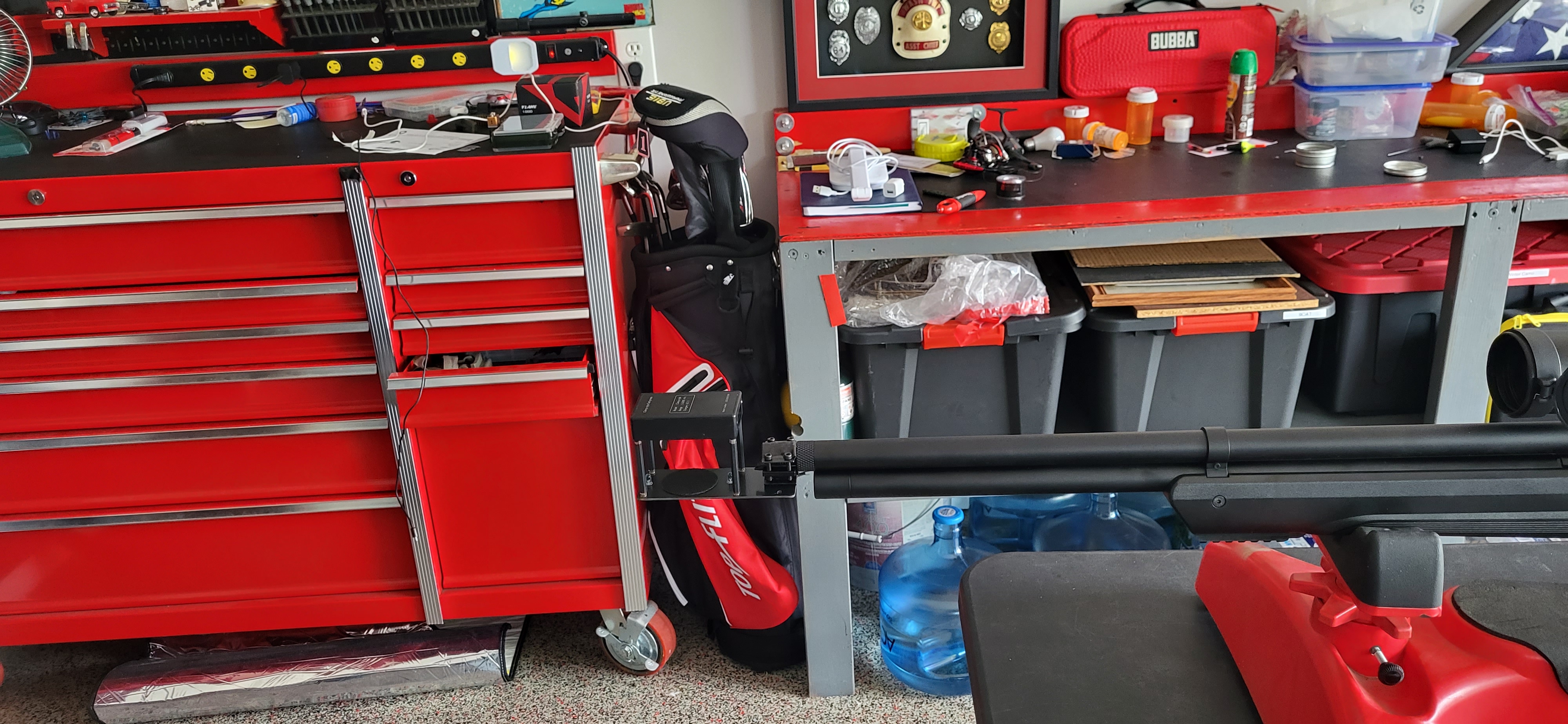

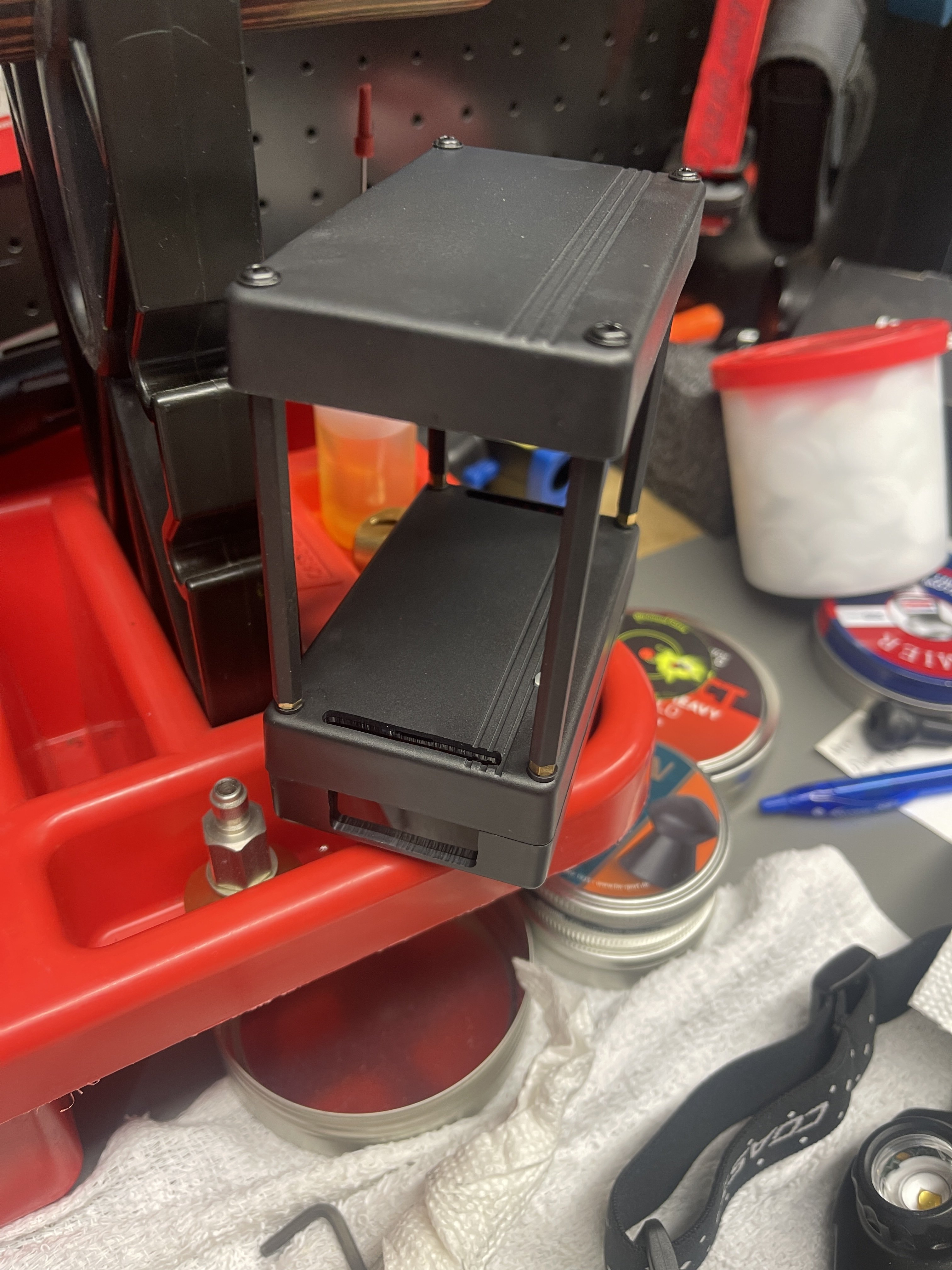

Here's pics of the two chrony I used.
I use the one pictured usually because I can set in on my porch rail and shoot through it while shooting groups. I also have the clamp on one. I shot my old conventional chrony so it doesn't work any more so I don't know if either of these inexpensive ones is completely accurate but I pretty much don't care.
They give readings about 10 fps apart. Mainly I need to know when things change and about what velocity I'm shooting. They are so inexpensive I don't see why all airgunners don't have one.

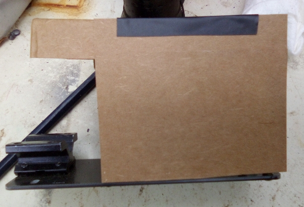

The only time my cheap Chinese chronys fail to give a reading is when the sun comes in from the side and “lights up” the bottom where the leds are. Otherwise, it always gives a reading.
I made cardboard side panel sunshields to quick tape on as needed.👍
Like so. Roof over display helps that alot ..
