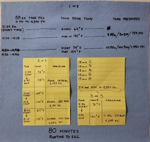

I was going to throw this data into some sort of spreadsheet before post it,
but, since we're all sharing info, i might as well post the pic I have. =D
I used my Yong Heng comp. [RP lube, 5 gal tap water w/ one 2-ltr bottle of ice]
I needed to fill a brand new / empty 88 cubic ft carbon fiber tank to 4500+psi.
Here's the data that I ended up with.
It'll show the start/stop time, the comp temp, and the tank pressure.
Blue shop cloth, then left yellow paper then right yellow paper. haha
I converted the thermometer on my comp to F,
and didn't get the chance to convert back to C for everyone with the OEM C display.
Sam -
