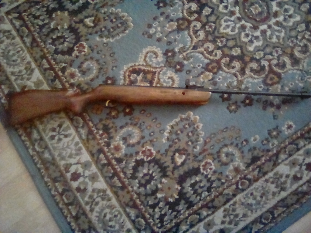

For an inexpensive project gun I've been working on my old Crosman Storm xt in .177. The Crosman Quest and Optimus are the same rifles and use the same parts so you can still order what you need from Crosman or other places. This is a very common design. These springers are usually priced a little over 100 bucks so they are in your price range.
On my Crosman I added the GRTIII trigger which has made a huge differance. I lowered the comb of the stock just a little so I can use the iron sights and I've also refinished the stock. Just recently I took the whole rifle apart for a clean and lube. I would really like to replace the rear plastic sight with a Williams peep.

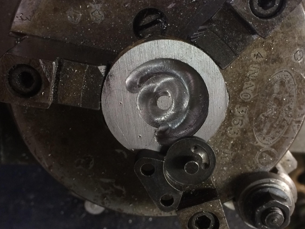

Send the spring with necessary dimensions, and a piece of Delrin and I'll make a snug guide for you. Just send an extra piece of Delrin for in my stock rack.
Delrin is so easy to machine. It cuts like butter and it's too easy to get a good finish. Cool stuff.
Sorry, I'm not going to make any experimental pistons. Top hat, yes. Delrin, steel, brass, NP. Give dimensions
