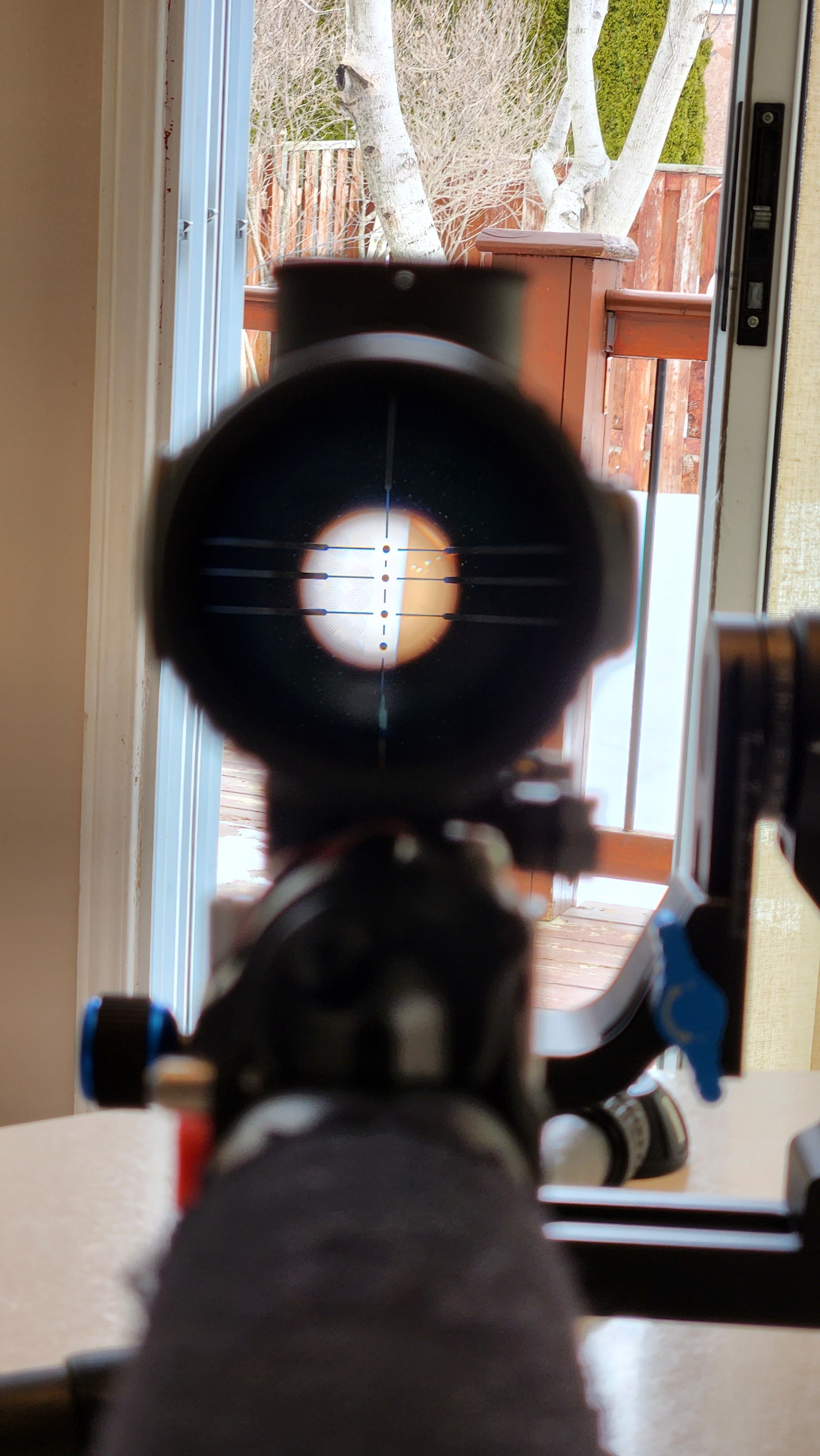

Having just gotten the newest generation Athlon Ares BTR "G3" 2.5-15x50 I can confidently say that this scope is getting up there so close to tier1 scopes in quality that it almost doesn't make sense to buy the most expensive, or neither the least expensive, of scopes anymore. Yeah it's 3-4 times the cost of the cheap scopes, and 7 times less than the most expensive, but you are getting an incredible value.
So it absolutely apexes the cheap scopes and isn't near as far behind the best scopes as one would think.
The relative feeling I get when using a cheap scope(sub $200) is intolerance because nothing is standing out as exemplary.
The relative feeling with tier1's is most everything is exemplary.
The feeling I get with this G3 is everything is exemplary too. With IQ almost like my tier1 scopes. Man I can't hardly tell the difference between this G3 and my $3850 S&B with both on 15x which is pretty crazy if you think about it!
Ha, it's a little frustrating for me right now because part of me wants to sell a bunch of my scopes so I can by the newest gen Athlon scopes. Nah my Helos G2, Midas TAC, and ETR are fine, but it is tempting knowing what I do now about this G3.
If you have a cheap airgun, sure put a cheap scope on it. A decent airgun spend the $$$ to be appropriate. Expensive airgun sure if really want too $$$$....
But I'd put this G3 on any of my rifles and not feel let down by it. It's as good of a fit on my FX Royale as it is on my long range AR PB and both of these guns were about the same price when I bought them which is $2000-ish. Best way I can think of is it's a goldilocks scope.
Why spend more on a scope with HUGE deminishing returns and why suffer the downsides of cheap scopes.
