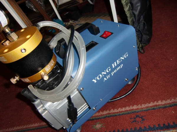

depends if you want a Yong Heng or a clone. They seem to all be made in small workshops in China somewhere. eBay- they run $200 and up, Amazon runs typically over $300 for the same compressors. Some looked on Ali Express, but all seemed to be in the $200 and up range.
I'd definitely buy from US Stock, don't have it shipped from China, as Returns are a bit difficult
Dam" to bad ya did,nt get the Tuxing with the big black head.They don,t seem to ever come up with the problems like the Hen's.If the hens goes to hell you can order a Tuxing head and piston assemble for $85 bucks that will eliminate all the plumbing and hoseing on the Hen.

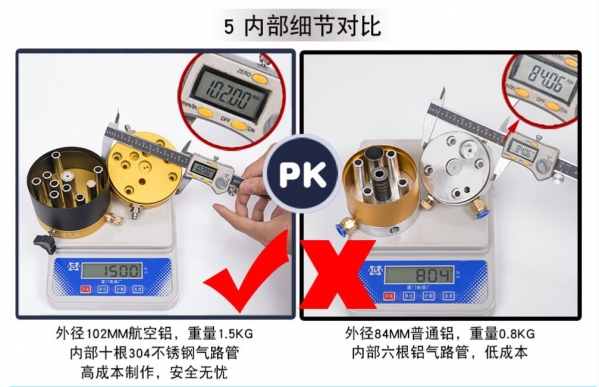

In China, they don't use the brand name Tuxing but Duge. It appears that there are Tuxing "clones" in the market. The following comparison is from the official on-line shop of Duge in China :
Genuine Tuxing ( Duge ) has bigger head, there are more tubes inside and they are made of stainless steel. Clones have less tubes and they are made of aluminium :

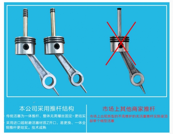

Genuine Tuxing ( Duge ) uses 2 ( lower end model ) to 4 ( higher end model ) 2nd-stage piston rings instead of just one :
