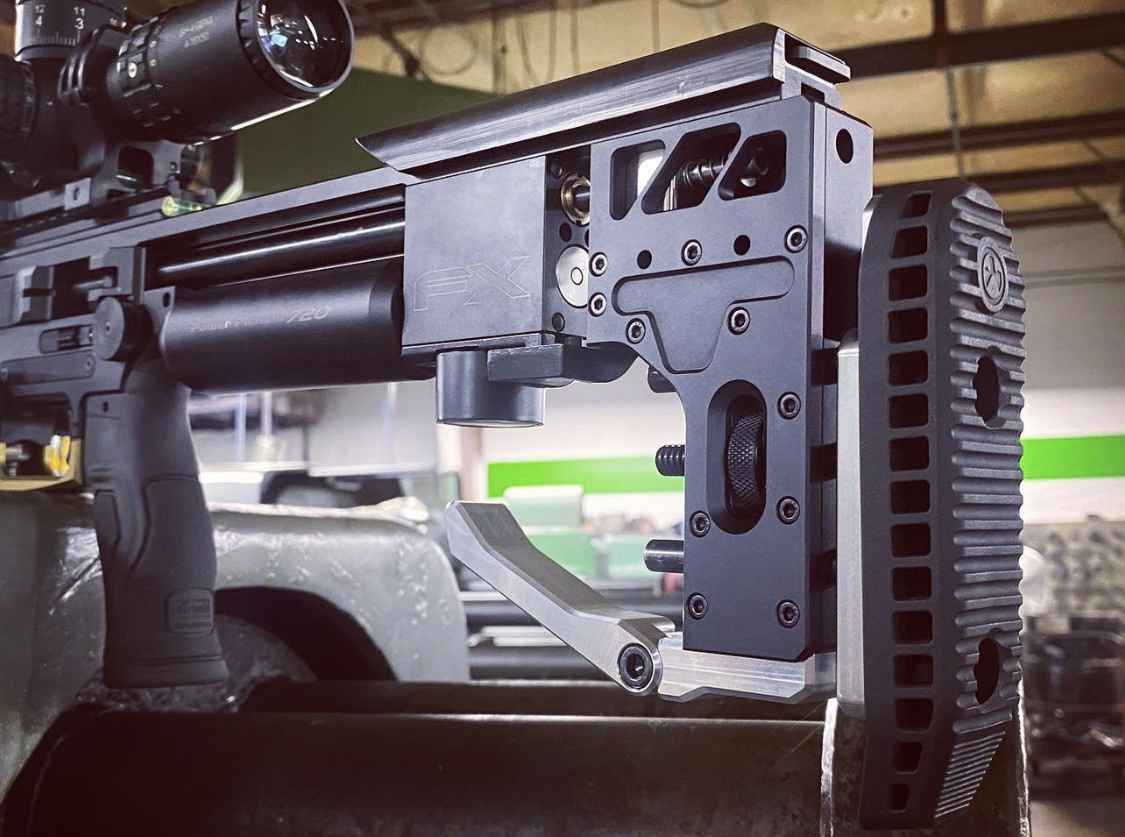

Cheek rest is not included. But you can see some empty M4 holes where a cheek piece will be added in the near future. Monopod is not included.
We couldn't make the magwell larger unless we released a mag at the same time, but something is in the works. But we did flair the magwell, much easier to load blindly.
There is a little more to it as the linkage for the probe carrier needs to be modified as well. Easiest option is to get a mag that has the extra space in it or grind some grooves.

Unfortunately the Impact's rear is not really designed to receive an L-tech probe without replacing the 2 side plates. It can be done with the oem side plates, BUT it isn't optimal thus we went with doing it the right way.

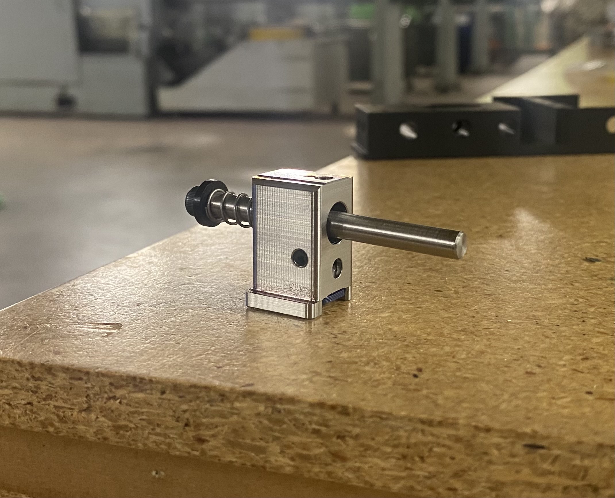

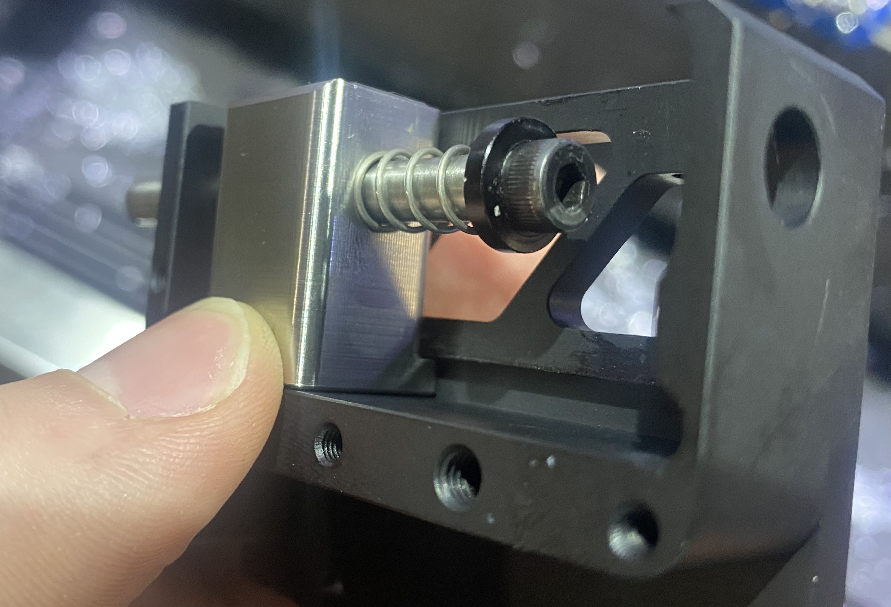

Here are some pictures of the probe carrier, notice the box way guide.
