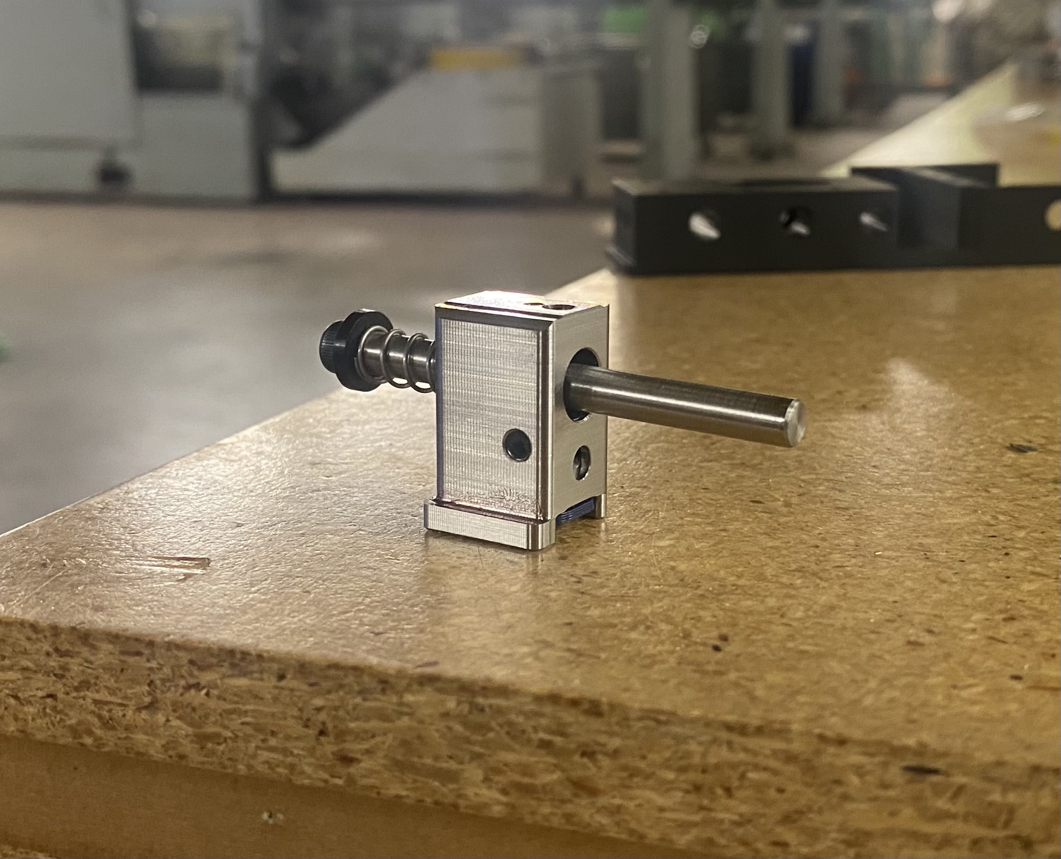

Here are some pictures of the probe carrier, notice the box way guide.
View attachment 326625View attachment 326626

I want to know the structure of this, how does it work? If the bullet has not moved into the correct position but is stuck or obstructed by something, will the probe pull back?
I'm not 100% sure if I understand the question properly, but it is a mechanical trip, so as long as you are able to cock your rifle and close the lever, the probe will snap back. If the projectile is stuck or say you jammed in a few rounds and it you cannot close the lever, it will not snap back. But at that point you shouldn't shoot it anyways.
If I put it on my hand and use my hand force, will I be able to push it back? I mean after the spring has been compressed, if I push in the direction of the arrow with my hand, will the probe snap back?
There is a mechanical mechanism inside the probe carrier preventing it from going backwards until the projectile is properly seated.

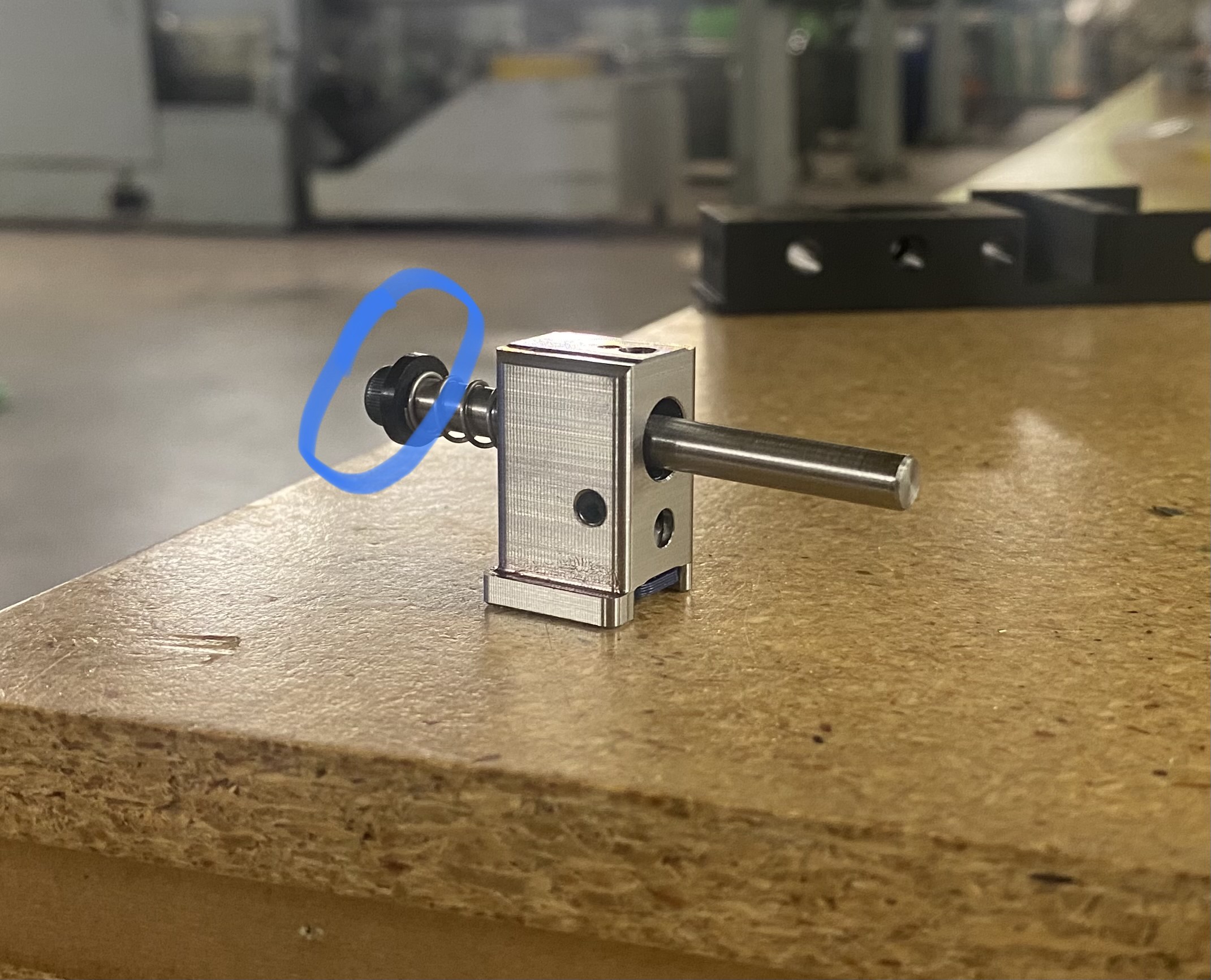

One thing I’ve experienced that owners need to pay attention to is this screw. Mine keep working loose. I put some Vibra-tite on the one last night. Hopefully this will solve the problem.
We're going back and forth about red or blue loctite. I'm leaning towards red but I was hoping to make it easier to swap out calibers.
When you tighten it down, make sure to use vise grips on the front to get a good amount of torque. The probe shaft is 303 so you can crank on it.
Getting into the weeds here but I'm going to experiment with a special Emuge tap that looks promising for a mechanical lock.
We got a sample tap from them but they accidentally sent the wrong M4 pitch and we ended up going with a standard tap on it.

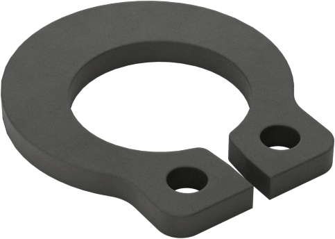

The other idea is a retaining ring. which would eliminate the need for a screw.
While the current design works, if we get something more robust in the future we will swap them out with everyone.
While the current design works, if we get something more robust in the future we will swap them out with everyone Disassemble all the details, I'm sure someone out there will give you some good advice.
