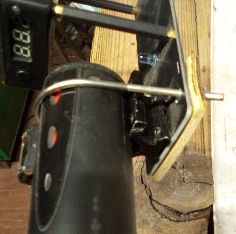

Thing is you don't know how each ones calibrated or algorithm used . The the pellet distance from the first led and so on .. so that little difference could be any small factor .. it's not like labs showing 800 and chinas showing 650 ..lol. to me that comparison and slight difference ain't bad at all .
Just using it the way it comes
I never tighten it too much. I’ve been using it since April. I’ve never heard a crack.
Ya.. that's a design flaw omho. I use it once on my gamo with that whisper baffle and took it right off seeing that it's more then likely going to snap the board.. no big deal cause I just rest the barrel in the yoke thing and shoot it off a old mouse pad cushion flat on the bench top.. just because it's cheap don't mean I want to bust quick..
I did think about a stiffing block across under the circut board to help take the pressure of tighting the ubolt causing over flexing of it . All ot takes is that one oops and snap..

Looking at the unit - depending on where & how the sensors are located you may have issues on hot days...

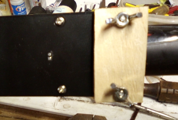

Movement of the barrel in the mount will probably be the biggest issue with this design. Use a bit of hard rubber between the barrel & the mount to stop movement. A small amount of movement (especially a springer) could throw the readings out a fair bit.
On mine I’ve covered the wire u-clamp with a length of electrical shrink tube to avoid any possible scuffing. Also lined clamp base with moleskin for same reason.

Interesting to note clamp base is just a Picatinny adapter repurposed for a base. Mine came with the other halve of the adapter barrel clamp as well as the wire u-clamp.
