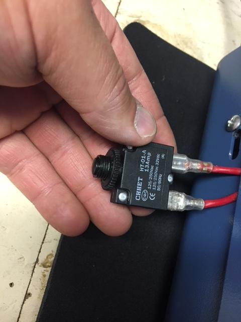

i have a replica / knock-off yong hen compressor. In general, it is working OK except it randomly turns off while running. I have determined it is caused by the wired-in switch shown here....
This switch seems to be flaky and keeps kicking it off. Can I simply eliminate it and replace it with a heavy duty fuse holder and fuse?
You need to check the full load amp draw on the compressor motor tag. Put an a clamp on amp meter on one of the wires while running to check actual amps being pulled by the motor. If you keep resetting the overload it will burn up and will trip more often. The only other thing to check is all the connections in motor circuit. If only one connection is loose it will cause high amp draw and will trip overload/ breaker. You will need to replace overload before checking for amp load on motor.

The problem was not the breaker/reset-switch. The reset-switch only trips at times when I try to start the compressor under load. When the relief valve is open, the breaker never trips.
I had the exact same issue when I received my Vevor compressor (thought I was buying a Yong Heng but didn't receive what I expected). The fuse would trip after 30 seconds. After checking every wire on switch and motor for bad connections, shorts, and not finding anything...I had a hunch the fuse itself night be faulty. I've read other people's experience with all models of Chinese compressors over the past 6 months and found that it's well within possibility to have poor quality electronic components in these compressors that don't perform anywhere near the rated spec that's printed on the part (relay, switch, and in my case fuse).
To fix my issue, I bought a higher quality fuse and replaced the one that shipped with the compressor. The fuse used in the compressor is a 125VAC/15A fuse and I changed it out with a NTE branded fuse with the same rating. NTE is a reputable manufacture of components. You can buy one from Amazon here:
https://www.amazon.com/dp/B002SR1U02/ref=cm_sw_r_cp_apa_NpdqBbHMV1ZEP
Installation is straight forward with no modifications needed. The factory wire connectors plug in to the NTE fuse, and it's mounted the exact same as the factory fuse. If the suggestions other people have you don't pan out, consider swapping the fuse like I did...but don't hotwire it and bypass the fuse completely. It's not advisable to f**k around when you're dealing with mains power at 110v.
