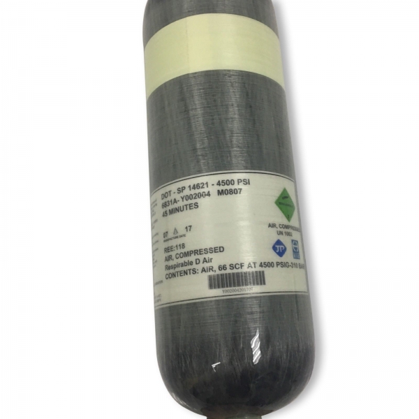

It appears that Acecaretech (a Chinese CFFC tank manufacturer) is now getting some of their tanks certified DOT (DOT-SP14621-4500psi), and making the neck threads compatible with our standard 7/8"x14 threads. See the link below for $360 - 6.8 liter (66 cu ft - 45 minute) tank. An SCBA tank valve can be purchased used on eBay for about $30. This throws a wrench in the "reconditioned" tanks that are now being sold by a few vendors through the LE (life extension) program...

Simple, maybe dumb, question.... Do you trust them to truly be US DOT certified? Lots of good Chinese companies, but lots are also good at 'clones' (appearance wise). A label wouldn't be difficult to replicate and I did not research the certification. I don't do everything I should with/for my tanks but I do feel comfortable that I started with a good product. I've been bored and hot while sitting in parking lots today so maybe I missed something....
That label looks quite real to me. Has all the right info, even a barcode like they have now. I looked up the SP # and found the DOT stuff on the company. Looks legit from here.
