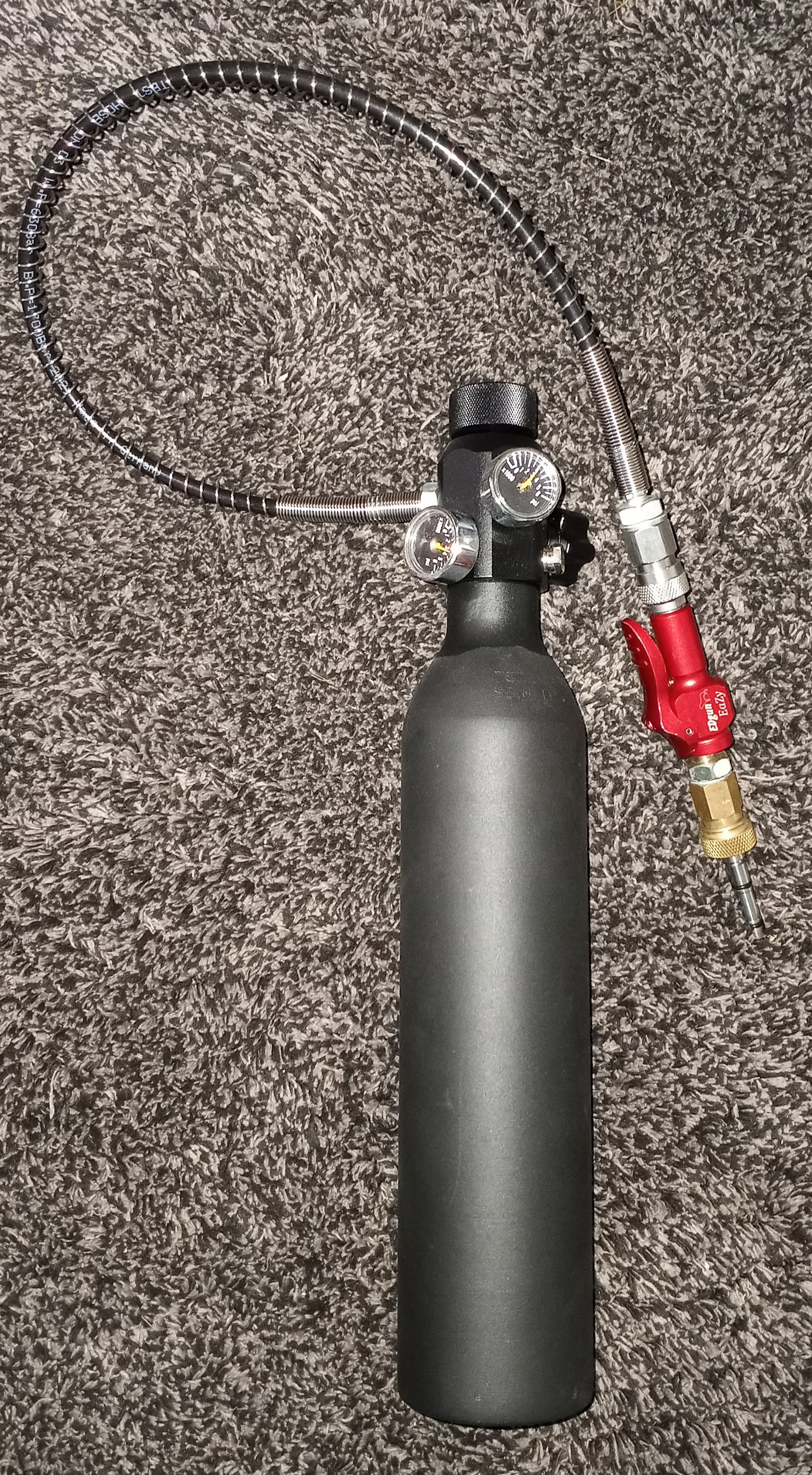

350cc tank, been holding 4k with no issues.
