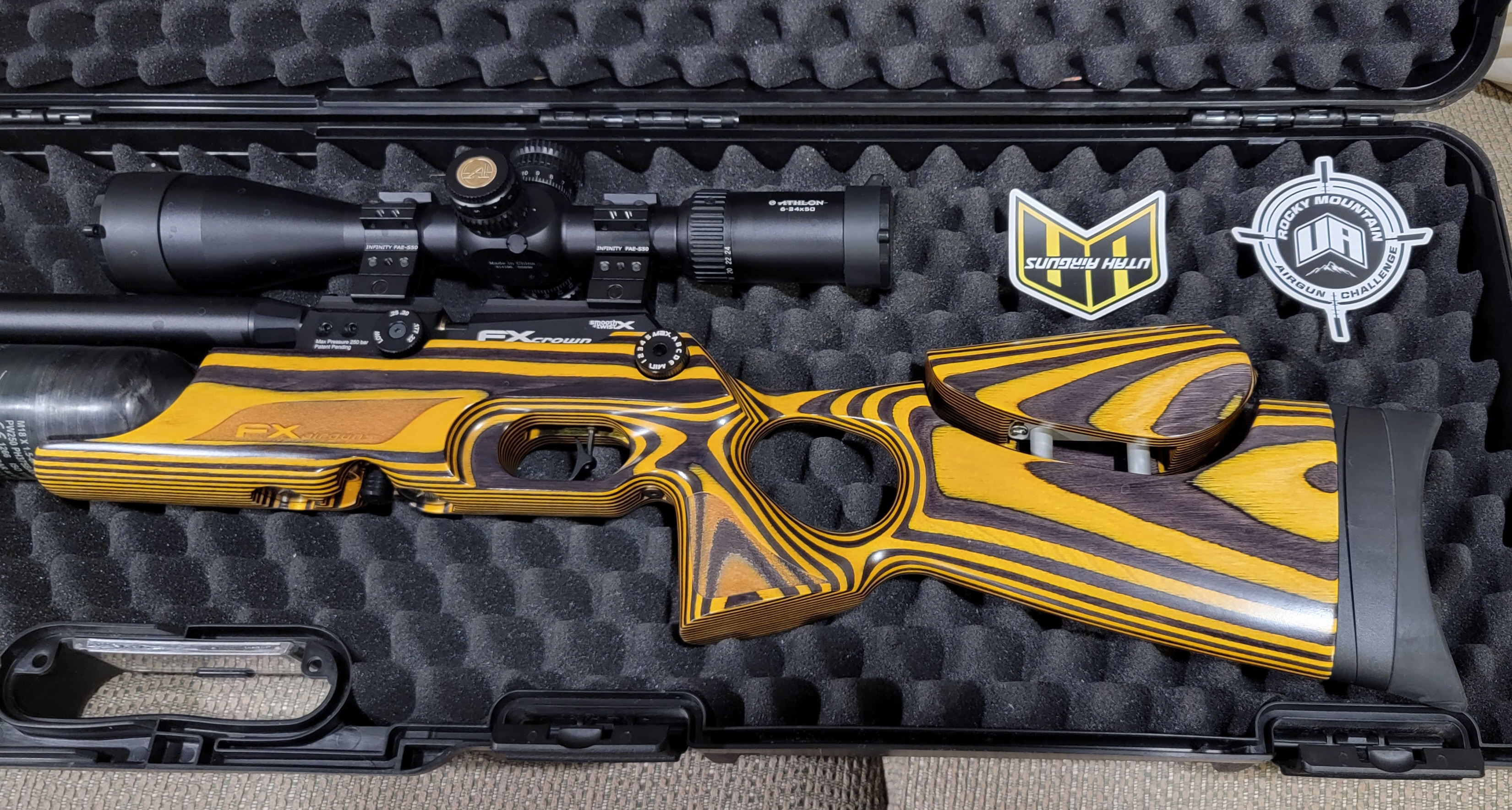

I went with a well cared for used gun. Still expensive but came with a scope ammo and accessories, for little less than the gun alone brand new.
It is currently more accurate than all of my guns including the Kidd custom 10/22.
