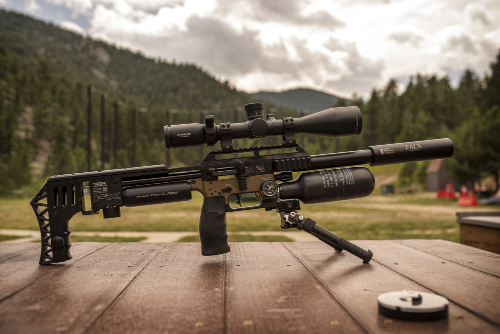

Went with the STO Falx myself.
Liked the thought put into the noise suppression with actual baffles compared to just felt and washers. I also liked that I can buy separate baffle stacks when improvements are made.
Sound suppression is very good at 30 fpe that I am shooting right now out of an FX Impact M3 Compact .22. Once I tune up the power for slugs, I'm sure it will still be very quiet.
Reactions: Impact701
Looks great on that set up

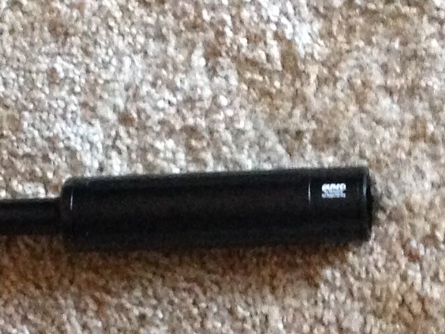

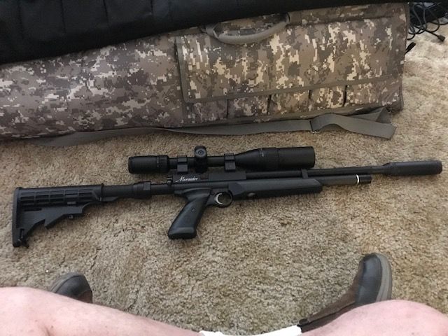

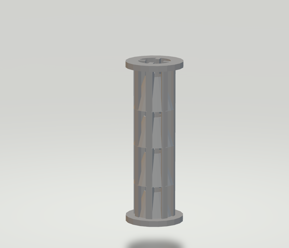

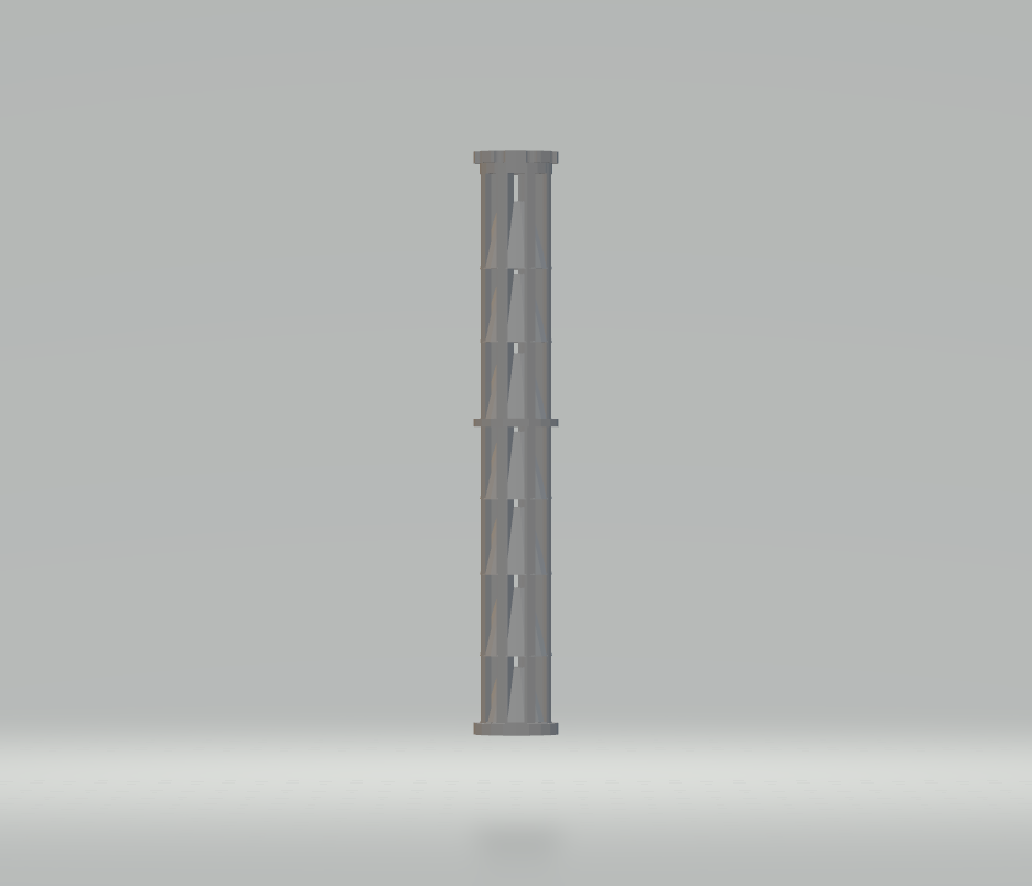

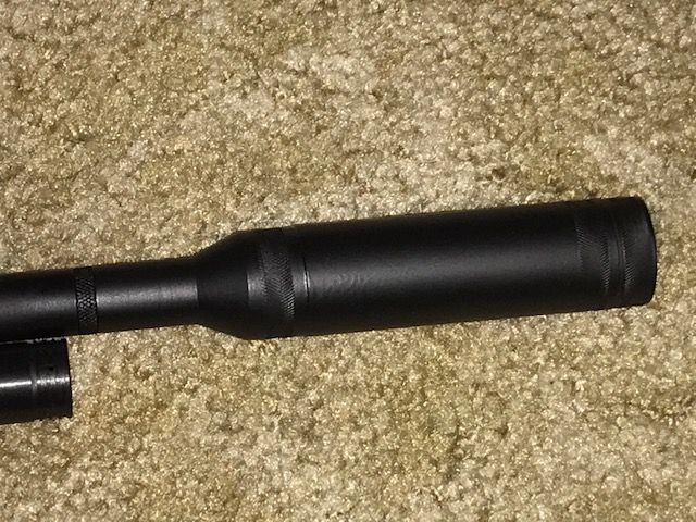

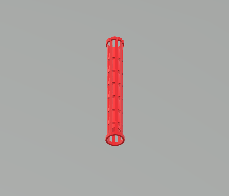

I like DonnyFL Sumo and Ronin, but I also make my own and have had better results with Baffles and Moderators, I designed a 3D printed Baffle for Flash and Flashpups that replaces the original baffles and makes the guns as quiet as having an added Moderator, and made short 4" long Moderators with the 3D baffle that makes the guns sound like a "Puff", Tested around Game at about 25 yards, Quail and Dove, the shots were in the dirt next to the birds and they didn't even flinch, so quiet the birds had no Idea pellets were buzzing around them....
you can find these Baffles on Tinkercad....
wrap with felt...
