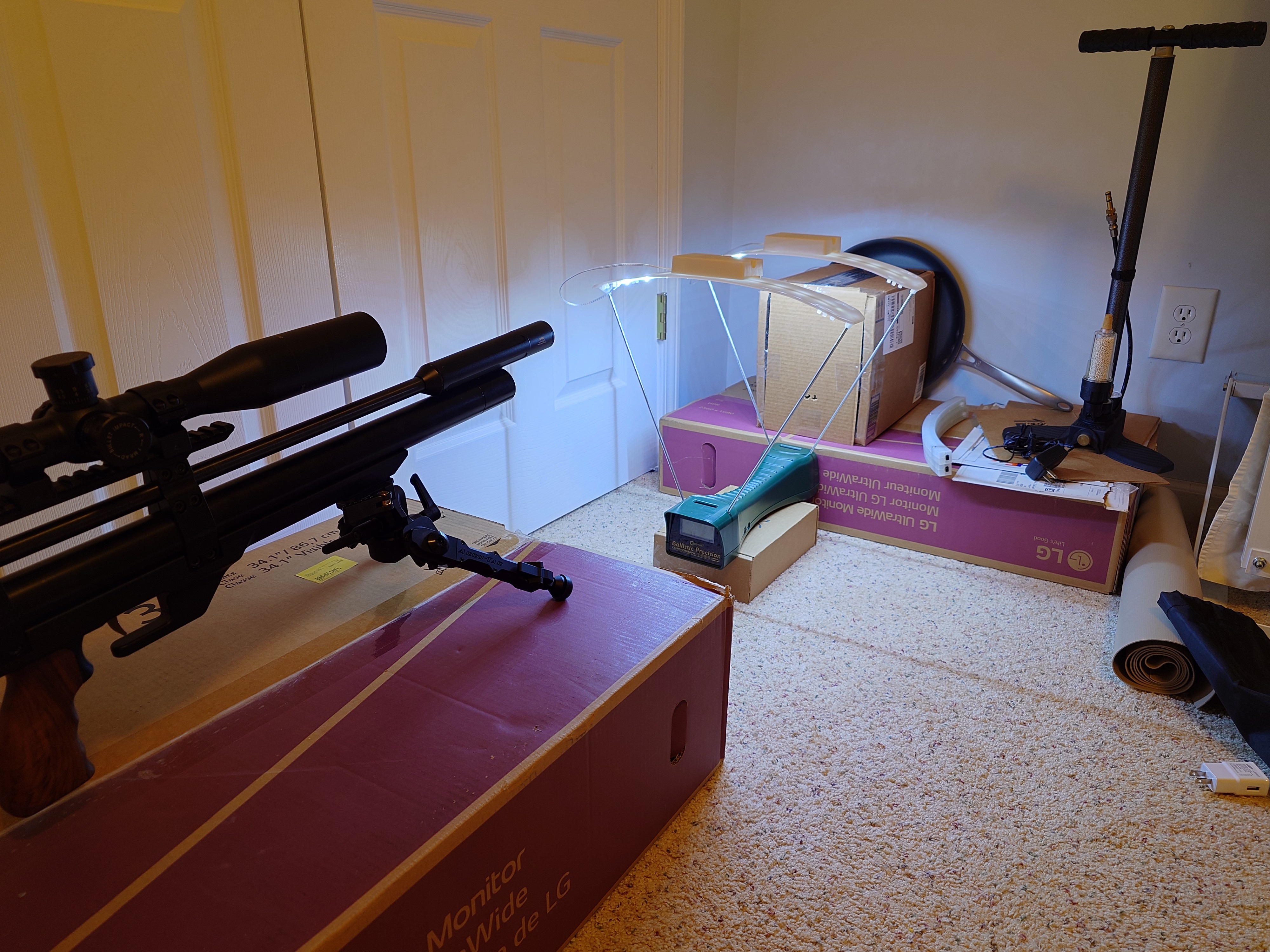

Just an update. I installed some LED light strips on my Caldwell chronograph and it works very well. I know they sell lights meant for this but the Caldwell ones are $67. These lights were $16 from Amazon.
Actually, I already have a set of Caldwell lightbars that I bought years ago (you can see it right beside the pump). The version that I have though only came with an AC adapter. I know the newer models come with a battery box that you can use instead of the AC adapter. I thought about getting a battery box for my Caldwell lights but what confused me was the AC adapter on mine says that it outputs 24v. A battery box with 3 AA batteries is only 4.5v.
I like to do this kind of stuff in the dark at night. My neighbors are cool but I just want to keep gun stuff on the down low. I just put this out in the middle of the woods at night and no one's the wiser. That's actually one of the main reasons why I even thought of buying a radar unit in the first place... so that I'm not dependent on daylight. For how little I plan on using this, I think this is an acceptable solution for me.
FYI, when I do this at night, I'm well within inside the window so the muzzle report of a moderated 31 FPE .22 gun from the outside is very minimal. Also, I'm only shooting 5 shots, max 10 shots, once in a blue moon, so I'm not out there every night firing the gun all night long keeping everyone awake.
Did the same but used cheap roll of 12vdc IR leds. Mine hated the white local lowes leds.
