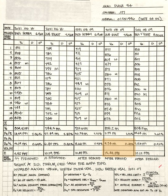

Here's one of my typical data sheets - which I use for jotting down other relevant information as you can see. Running new strings occasionally is a useful "check up" on component wear, new batches of pellets, etc. I've kept these sheets for many years and frequently refer to them. This particular Diana 34 llikes the JSB 7.9 Exact best.
