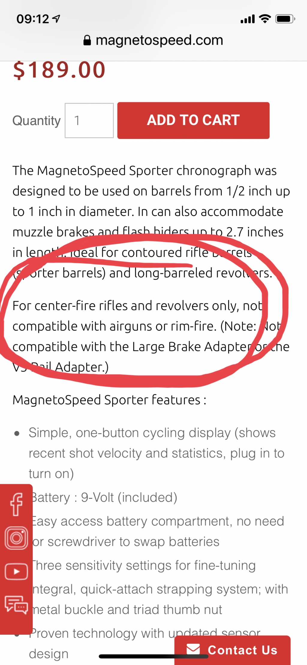

I've got one. Works great and have used it on several powder burners with bull barrels. Shot it over a Caldwell pro chrono and results were similar. Those two set at the moment and my go to is my Lab Radar. Had the FX and mine was inconsistent shooting it over any of the others so It went bye bye.
