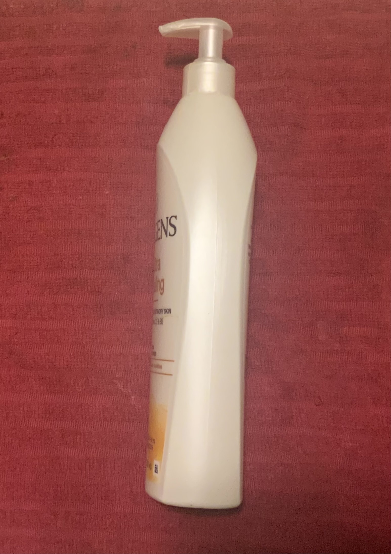

Daystate Cleaning a Revere 22 barrel?
The straw in most of pump action lotion bottles is a smaller diameter and much stiffer than a soda straws.
I’m an Avid PatchWorm user but can’t find a straw small enough to fit the end of my Revere. Any suggestions are welcomed?
