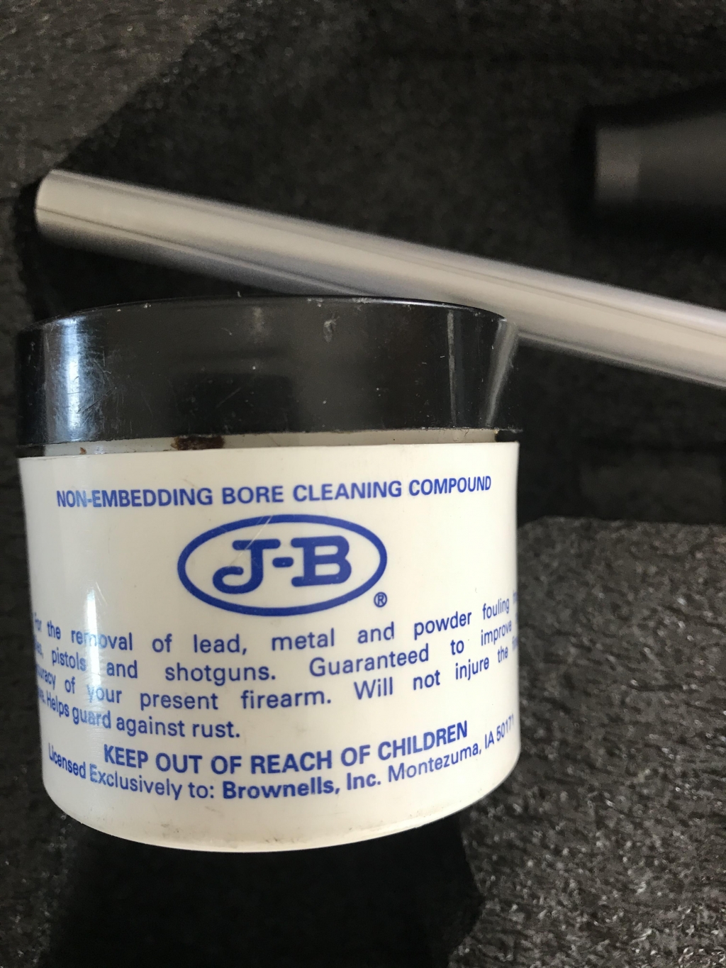

I used JB Bore paste after about 100 round
s in my new FXImpact STX. Pulled lots of lead flakes out of the rifling. Accuracy is awesome post cleaning.
