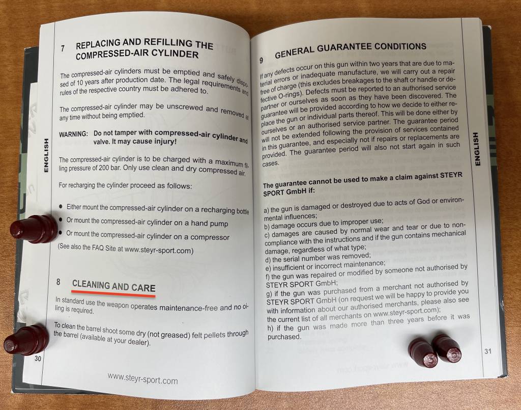

Please explain the bolded part better.
They do come out dirty. I always liked to run a patch through with oil. But, my Steyr Pro X manual says to only use felt pellets.
