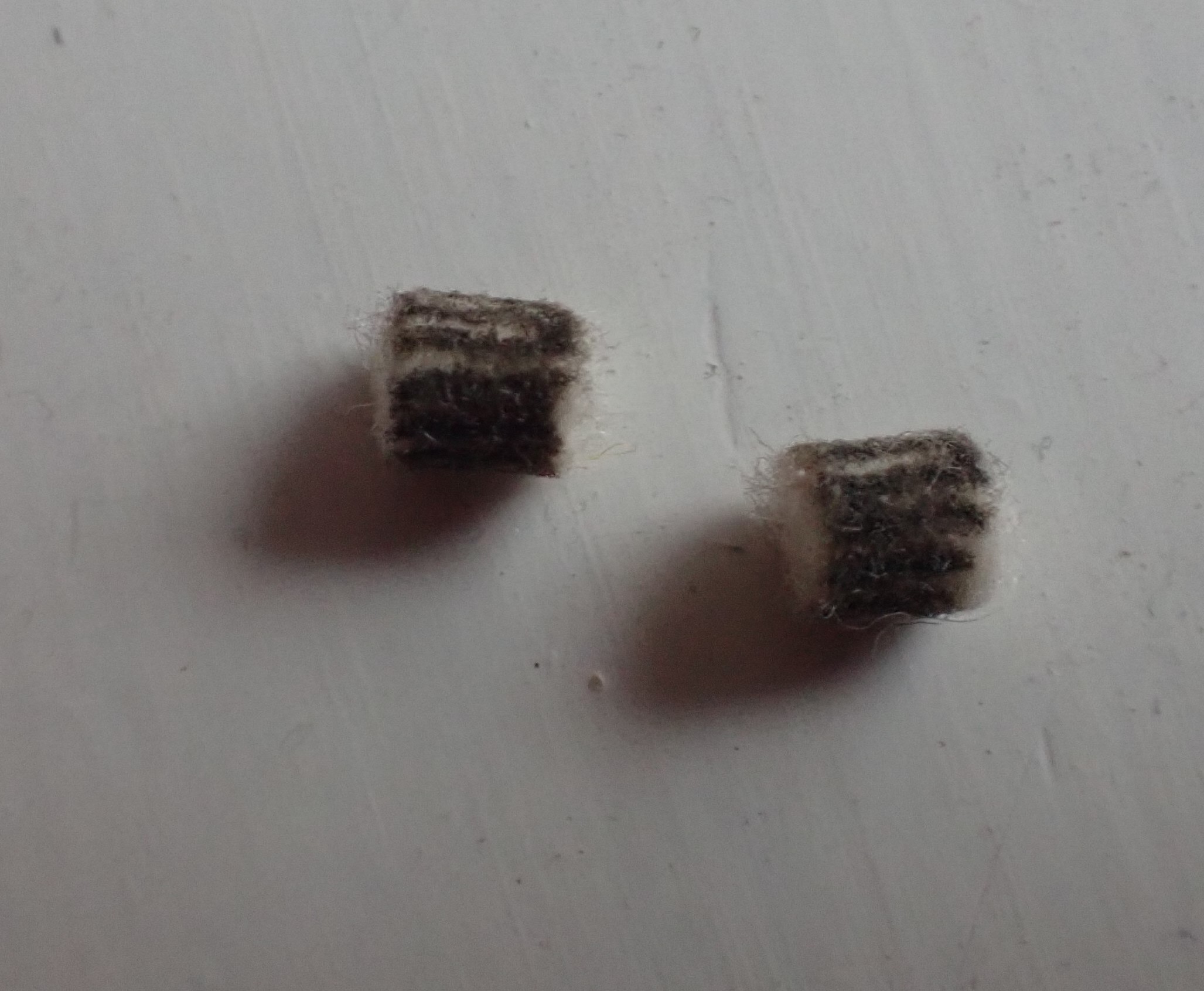

I mostly pull patches, either dry or soaked in either oil or solvent. But I also use cleaning pellets when needed. You can't pull patches on many older guns, such as my BSF S54 Match. There, I load two or three cleaning pellets and a lead pellet and shoot.
These cleaning pellets were shot through the BSF. You can't tell me cleaning pellets do nothing.
Because they came out dirty doesn't mean they are effective. Of course they are going to come out dirty. It's a dirty environment. There always loose lead dust and oil residue.
I don't think anybody said cleaning pellets do nothing. They're overpriced and unnecessary is all. You can use a q-tip in a .177 barrel being pushed by a pellet for the same results at 1/10 the cost.
