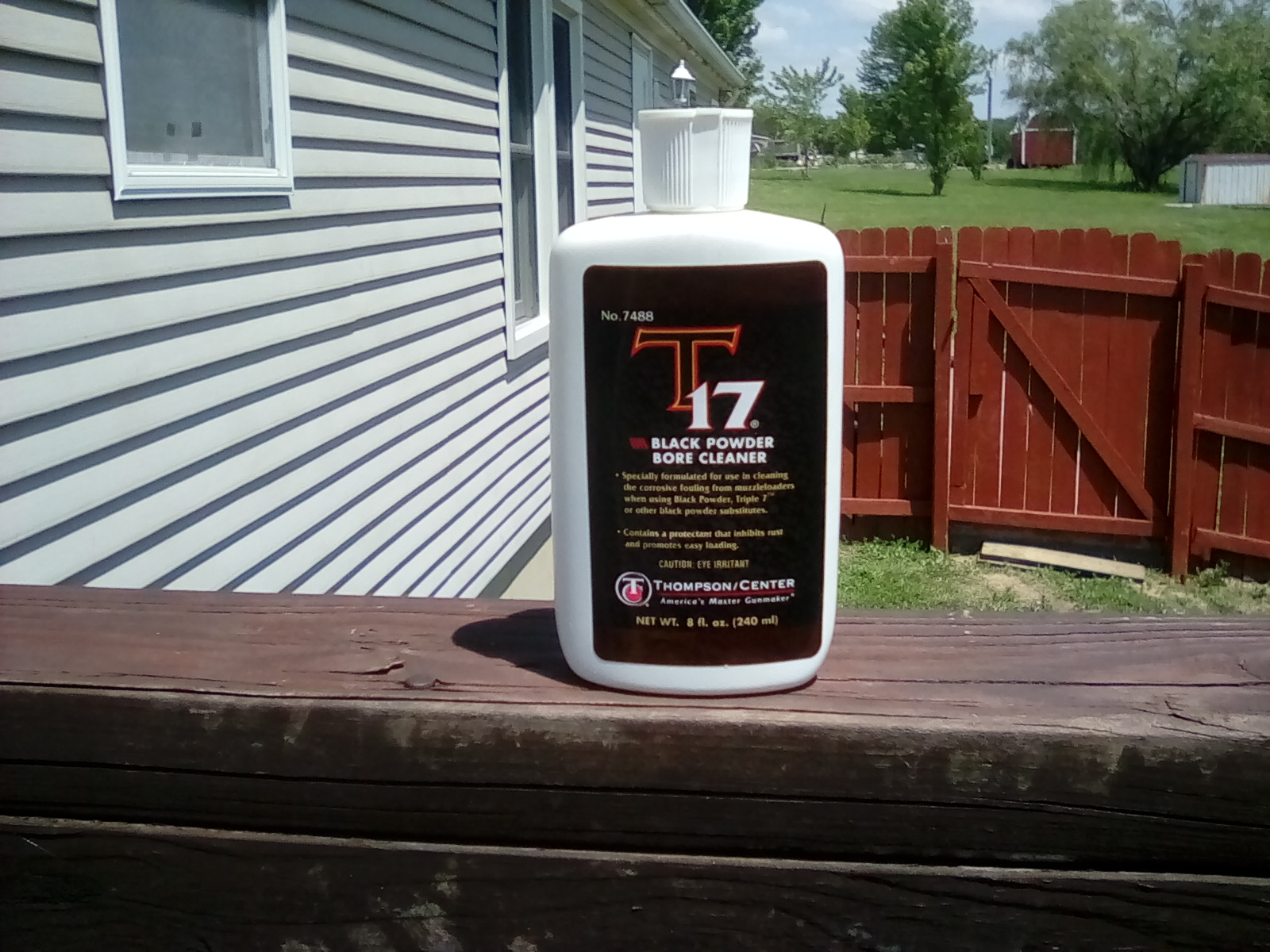

I've always heard you should use a non petroleum based cleaner and lube in air guns. I also shoot black powder guns and they also require a non petroleum based cleaner. So lately I've been using this T17 Black Powder solvent in my springers with very good results.
I have not had any dieseling. It also leaves a protectant in the bore that prevents rust.
