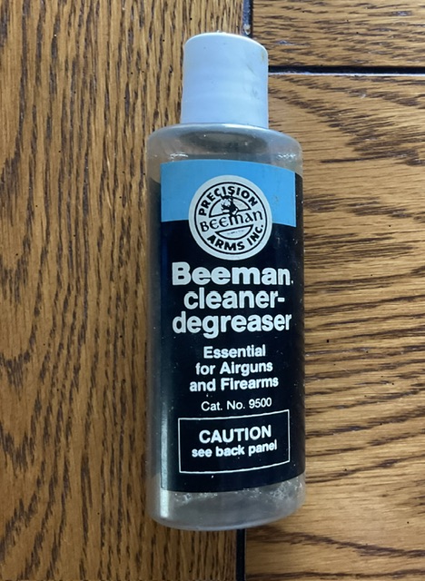

When Dr. Beeman was in business he sold cleaner.
It was nothing but dish soap.
I would recommend any good grease cutting liquid like, Dawn.
