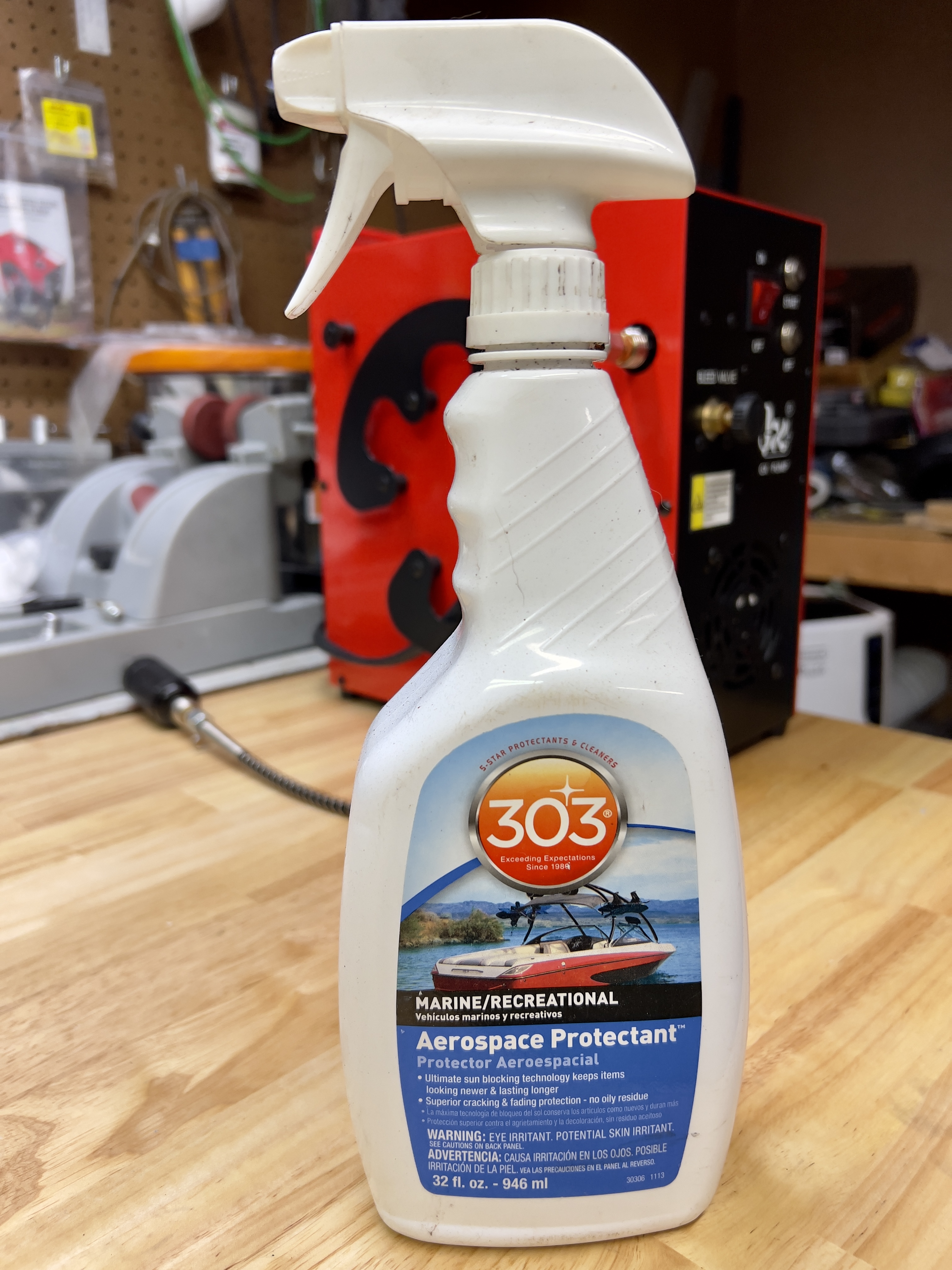

This is what I recommend to use after cleaning, I’ve been using this stuff for years, it works on any kind of plastic, vinyl, etc. I use it on my Harley’s, autos, kayak and anything plastic or vinyl, it works Awesome…..I’ve got a 1992 Toyota pickup I bought brand new and I’ve been using this stuff on it for years and the dash and interior in it look brand new.…it’s got almost 400,000 miles on it and I still drive it every now and then and it still runs like new…:)
Reactions: Sanctify7
In my opinion, if you use the 303, I wouldn’t use the Ballistol also, I think it would defeat the purpose of using the 303. The 303 is thin with no odor, you saturate a small cloth with it and wipe it on and let it sit for a few minutes and use a clean dry cloth and wipe it off, it has no oily residue. After a couple of treatments, the plastic will retain its color and will not bleach out and become splotchy looking over the years. 303 makes a lot of different products, you have to make sure and get the Protectant instead of the cleaner.
