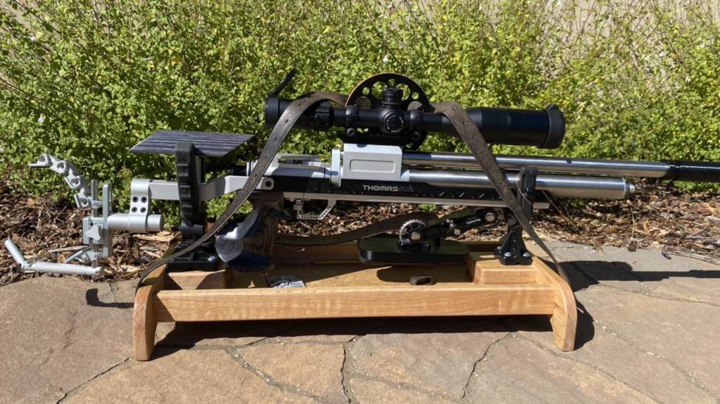

The back ordered Rowan hamster finally made it here just in time for this weekend’s match, Pepe is all dressed up for tomorrow!

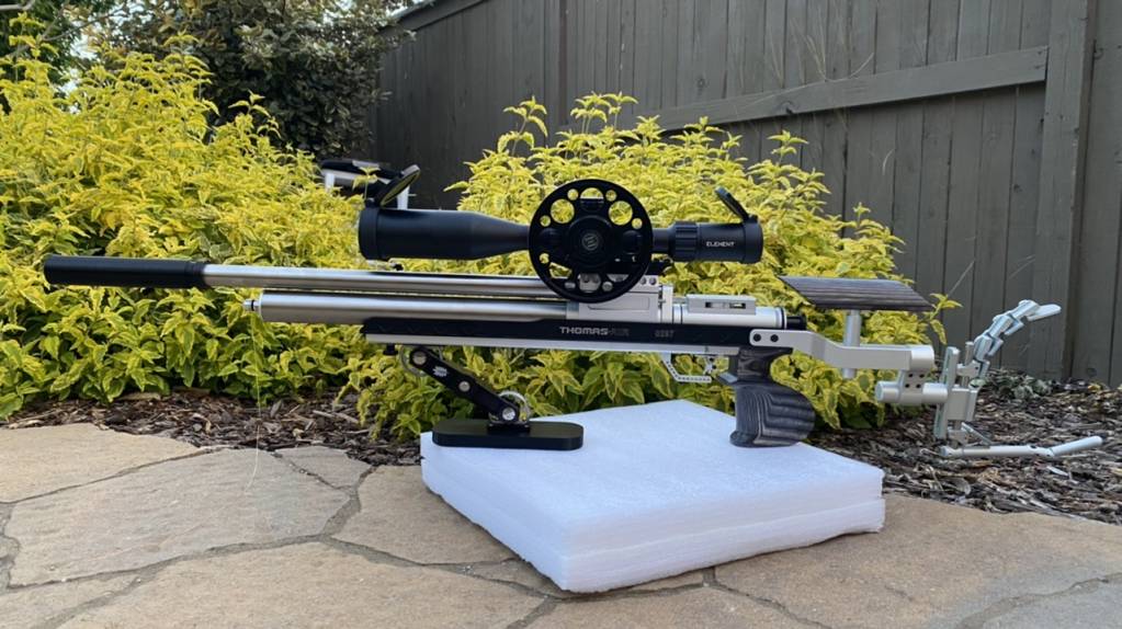

Finally another update:
Shot it at a few matches and the gun obviously did it’s part so all the misses were on me. Of course I have to blame the scope and found a good deal on a beast of a scope!! It’s OMG clear so hopefully I can do a touch better as between 45 and 55 yards the poor little helix was struggling a little and I have to be really on top of it to range correctly in low light or shade.

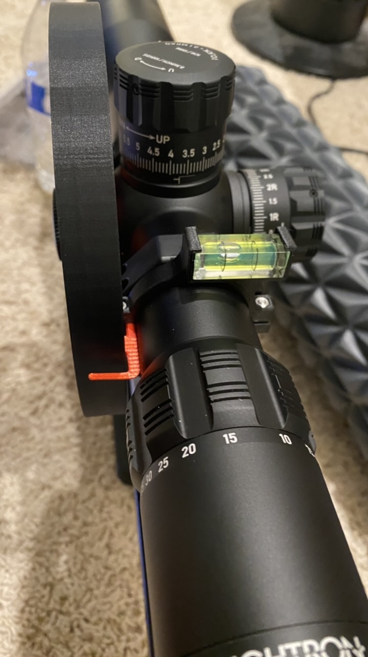

So what do I do when I get a new scope? Shoot it? Obviously no! Doll it up of course, who takes their shiny new truck to the dirt? It’s all about looking cool so I went to work with my 3D printer.

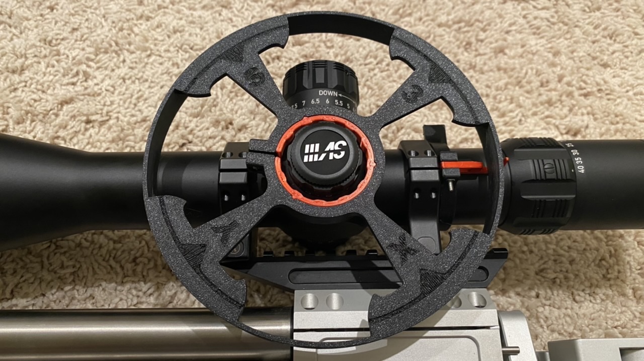

Printed a big scope wheel and yes I’m a Tesla fanboy!
Couldn’t find a 40mm bubble level so I made one with a modular scope wheel indicator/marker

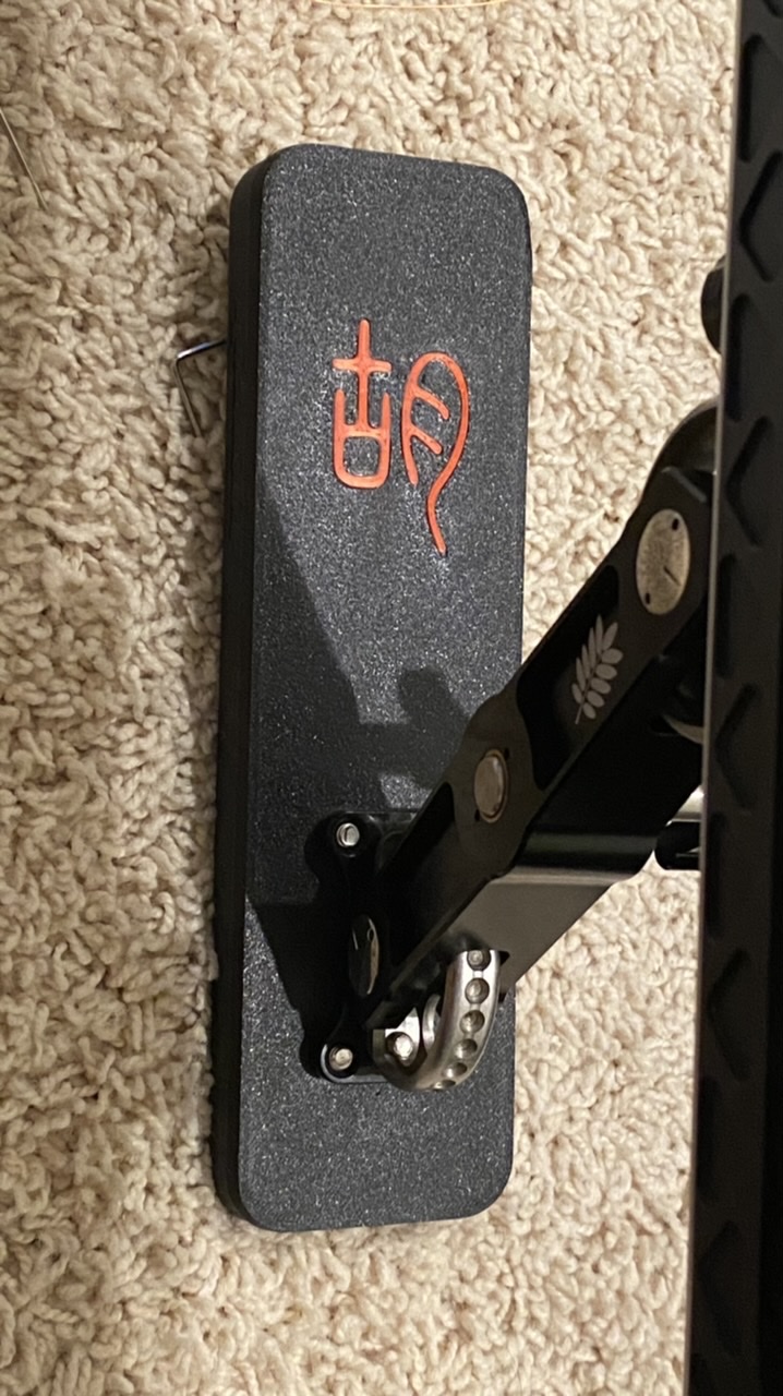

The. Some bling for my palm shelf

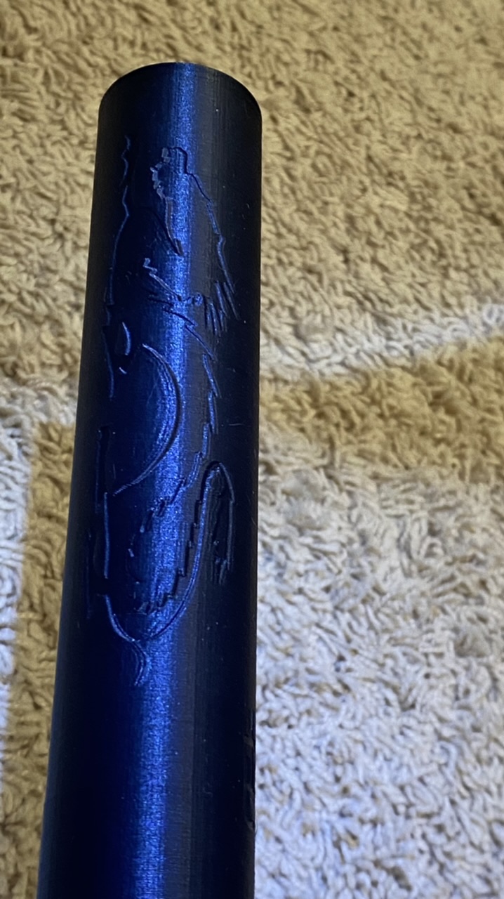

Then finally jazzed up my moderator with a bit of graphics because I was born in year of dragon.
Not is all purtty I’ll try to sight it in tomorrow and mark the scope wheel with yardage so I can shoot this Sunday’s club match…..,if I messed up the yardage at least I’ll look good!!!😅
