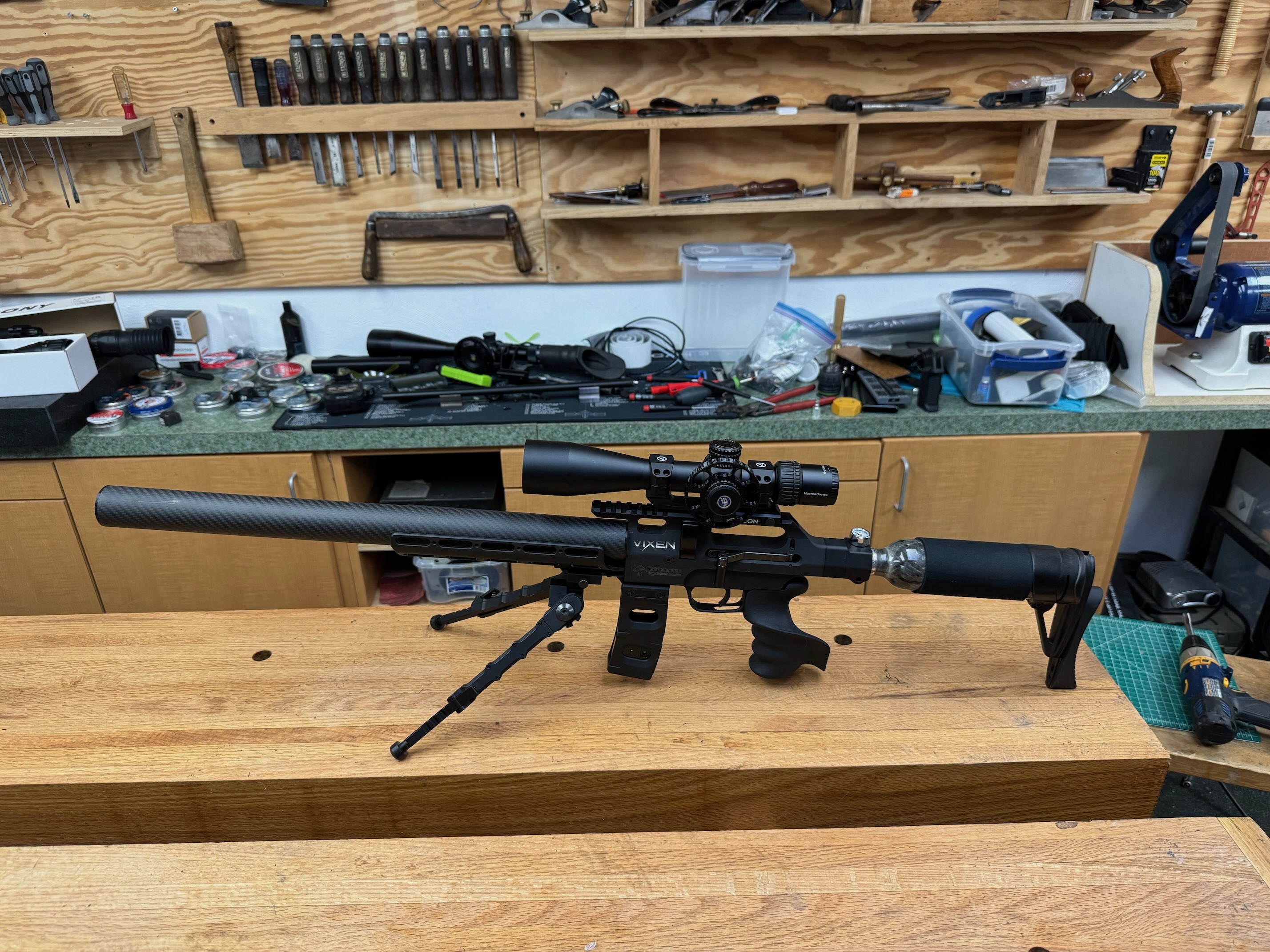

This is the new shroud I just finished for my AGT Vixen Long in .177. It's about 60mm longer than stock. It is dramatically more quiet.
