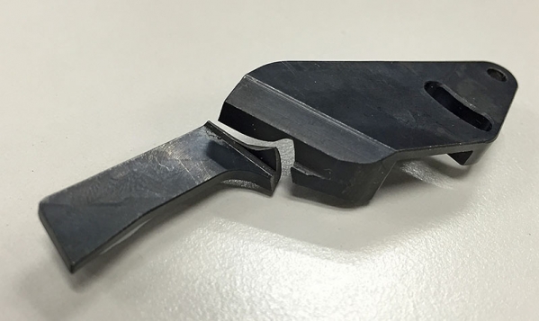

Can such failure be avoided by switching to other well established brands ? I take it with a grain of salt. Just a couple of days ago, a forum member has reported a connector exploding and that was on an Air Venturi hose costing $60-70 . I have got an Air Arms FTP900 rifle which is among their top-line products. Everything looked extremely well made but a steel sear snapped just after 10 shots. They sent me a free replacement and told me that it was likely due to defects in the material meaning that it's not something totally under their control.
1537673380_10105043425ba708a4250ed1.79217817_broken parts 1 low resolution.jpg
