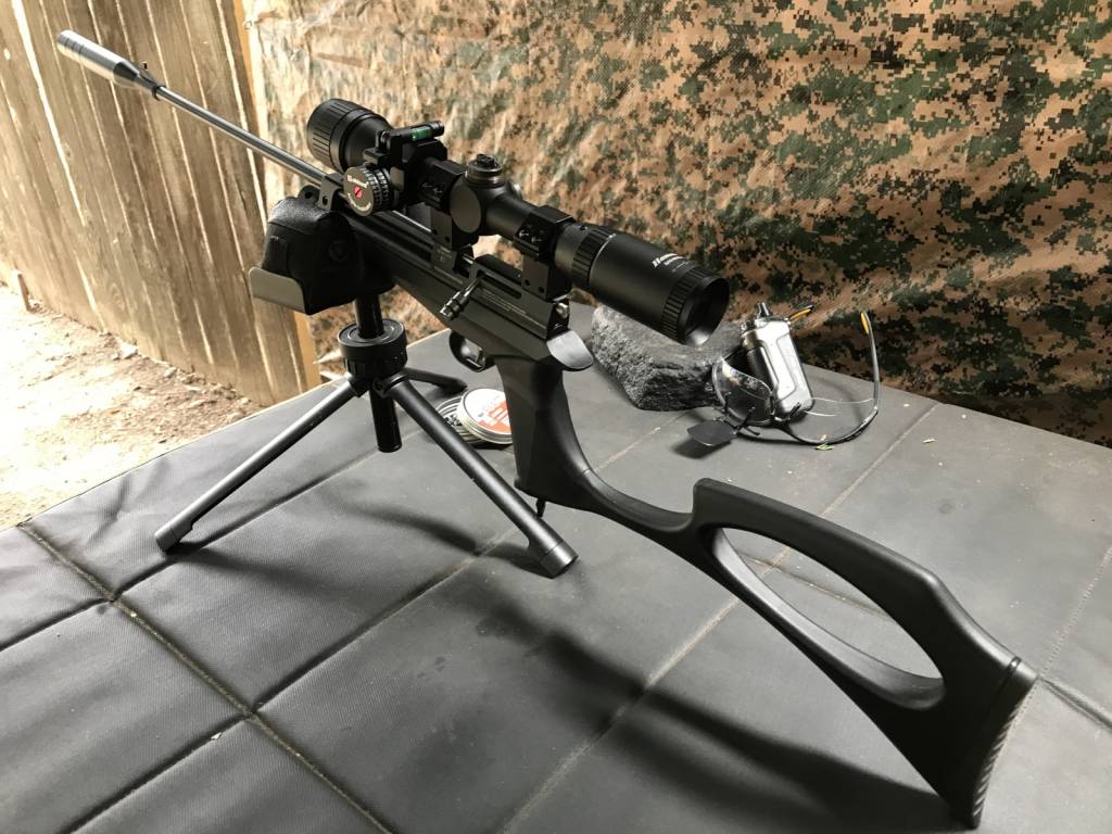

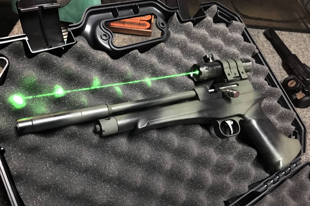

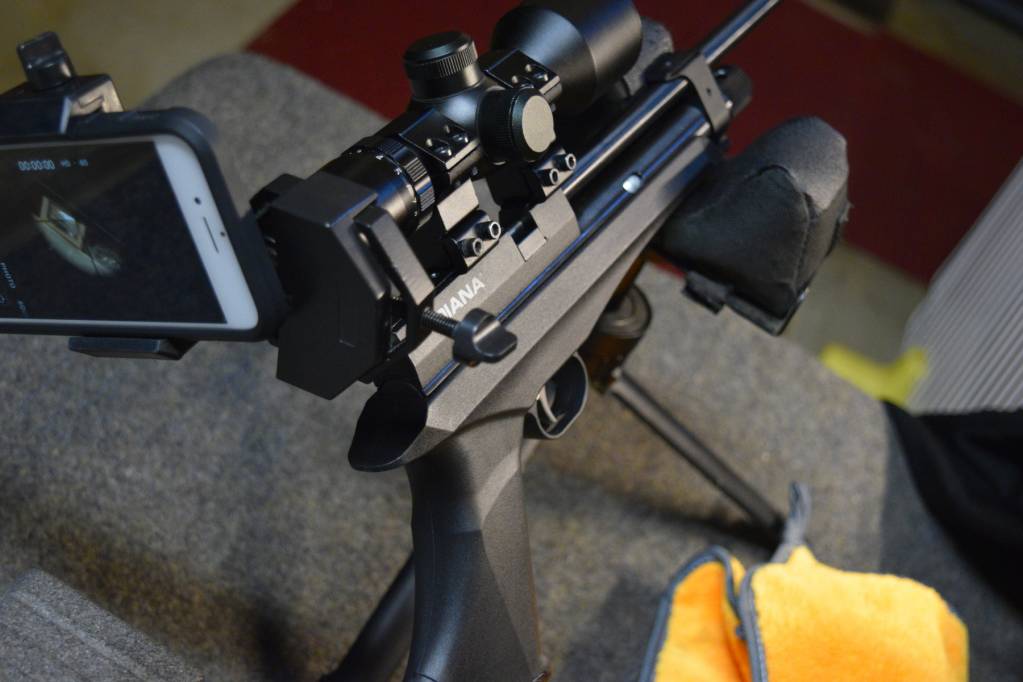

after much thought, oh, 40 seconds... Of all the co2 rifles i've owned, not a bunch, but a few, i'd pick the Diana Chaser over all others.
so much one can do with it. readily available, lots of configs and a few mods. very accurate, pistol or rifle, either barrel. only takes x1 co2 cartridge, which is a plus to me. packs a wallop for a lightweight co2 plinker. single shot or magazine. .177 or .22. trigger isn't bad with some fine tuning. takes all of five minutes to convert to a compact pistol.
and it's a handsome gun in that sci-fi sorta way. :)
