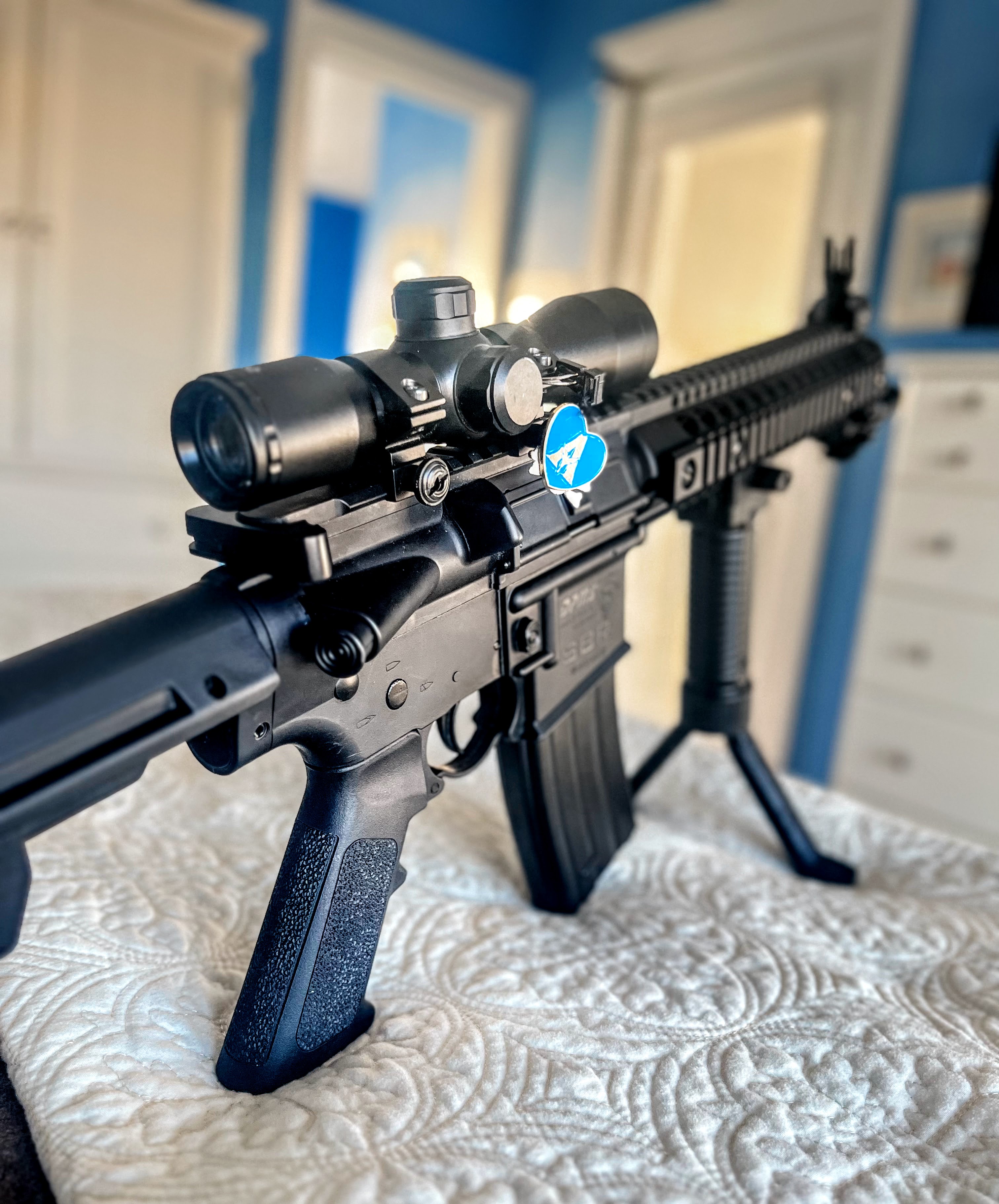

Y YellowDemon Member May 4, 2024 3 0 May 4, 2024 Add bookmark #2 May 4, 2024 Add bookmark #2 I heard lubricant and possibly wrapping teflon tape where the co2 gets punctured in the magazine… help!! Upvote 0

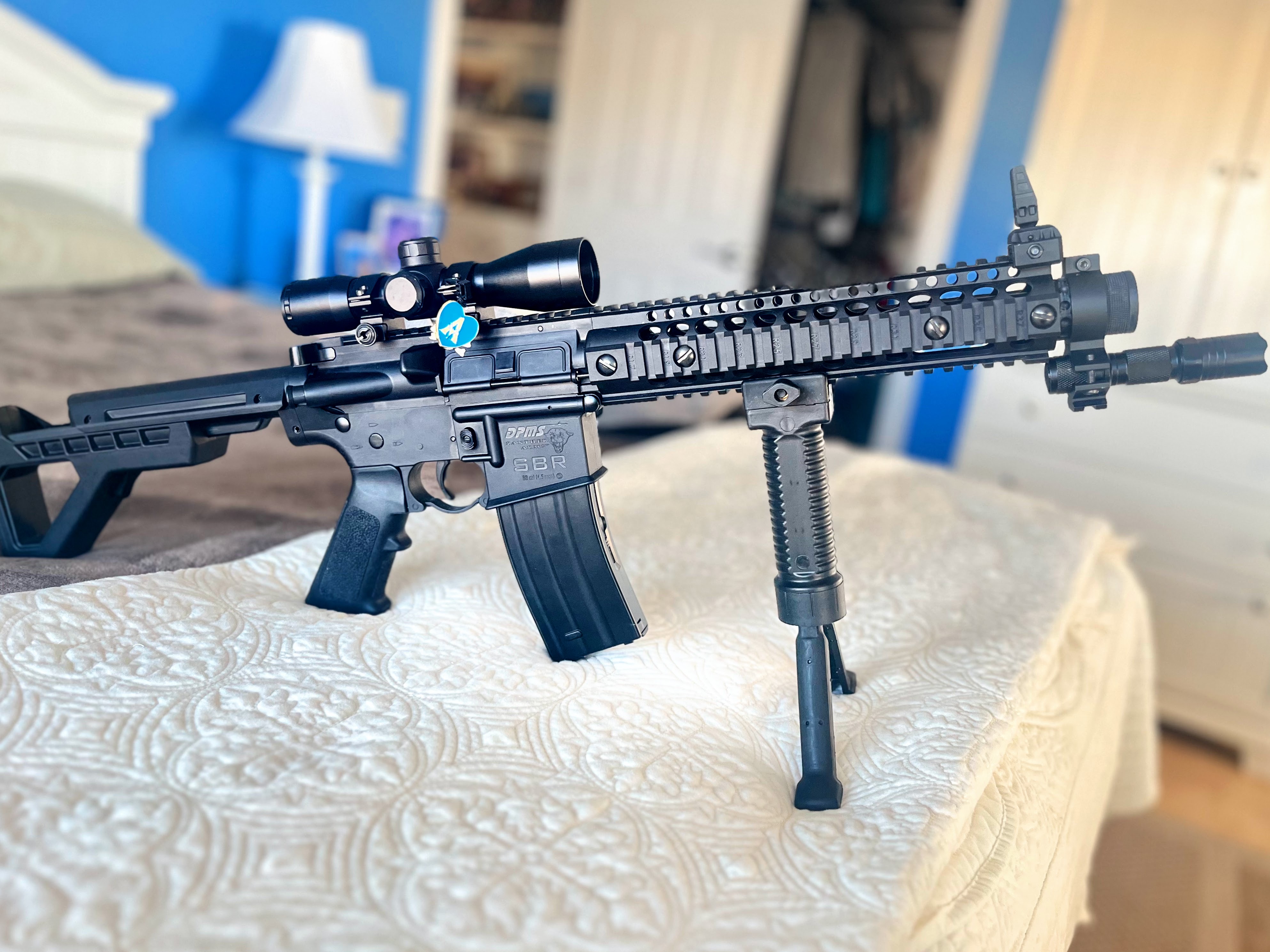

Y YellowDemon Member May 4, 2024 3 0 May 4, 2024 Add bookmark #3 May 4, 2024 Add bookmark #3 Another pic Upvote 0
Airgunmann Member Jun 2, 2018 2,914 1,065 Minnesota, United States May 4, 2024 Add bookmark #4 May 4, 2024 Add bookmark #4 A couple drops of silicone oil can help Upvote 0
Septicdeath Member Sep 27, 2019 3,353 5,252 Pacific Northwest, United States youtube.com May 4, 2024 Add bookmark #5 May 4, 2024 Add bookmark #5 It depends on were the co2 is leaking from. However in my opinion a person should just change the seal. There is no quick fix that is going to last. need umarex green seals X2. If it's leaking from cartridges Last edited: May 4, 2024 Reactions: JimBentley and nervoustrig Upvote 0
c_m_shooter Member Nov 4, 2016 1,201 644 TX, United States May 6, 2024 Add bookmark #6 May 6, 2024 Add bookmark #6 New seals are $3 for a pack of 4. Transmission stop leak is the "quick fix" and cost $10 a bottle if you don't already have it. Reactions: Septicdeath Upvote 0
