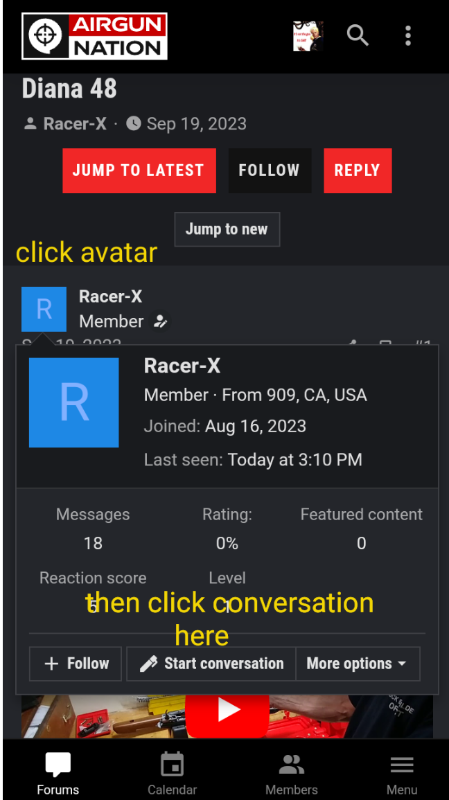

Racer, I'm trying to PM you but I can't see how to do it
Click his avatar then the pop up pops up then click start conversation and the pm text box thing pops up .
