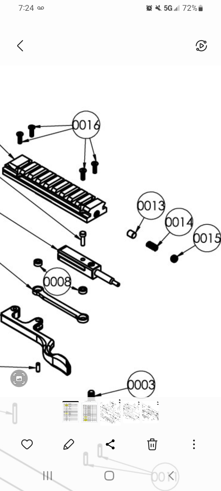

There is a detent pin and spring in the breech above where the bolt probe comes out. That's the bolt tensioner. It has a set screw that can be accessed from the magazine well. You'll see it if you look in the mag well towards the rear of the breech.
Parts 0013 0014 0015 is what talking about. Adjust that set screw 0015 out a bit should relieve tension.

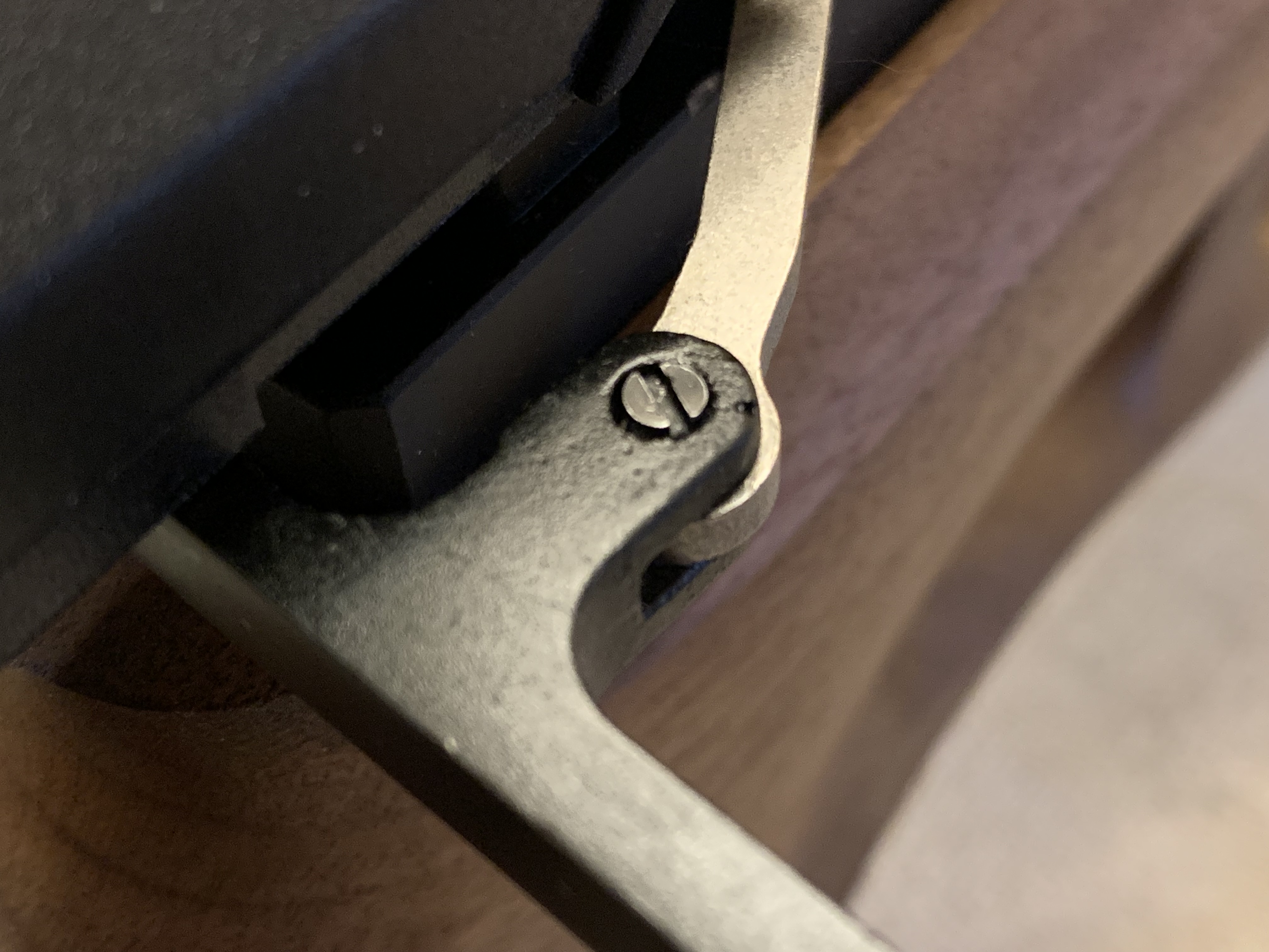

I would file the head and maybe the tip of the flat screw down some to reduce its height before the bolt closes when cocking the rifle. Then use locktite when you replace it. Like you, I’ll do almost anything to avoid sending it back as you never know what new problem to expect.
As mentioned below the detent spring/screw may need to be adjusted. Mine was set so far outside that I couldn’t insert the mag.
