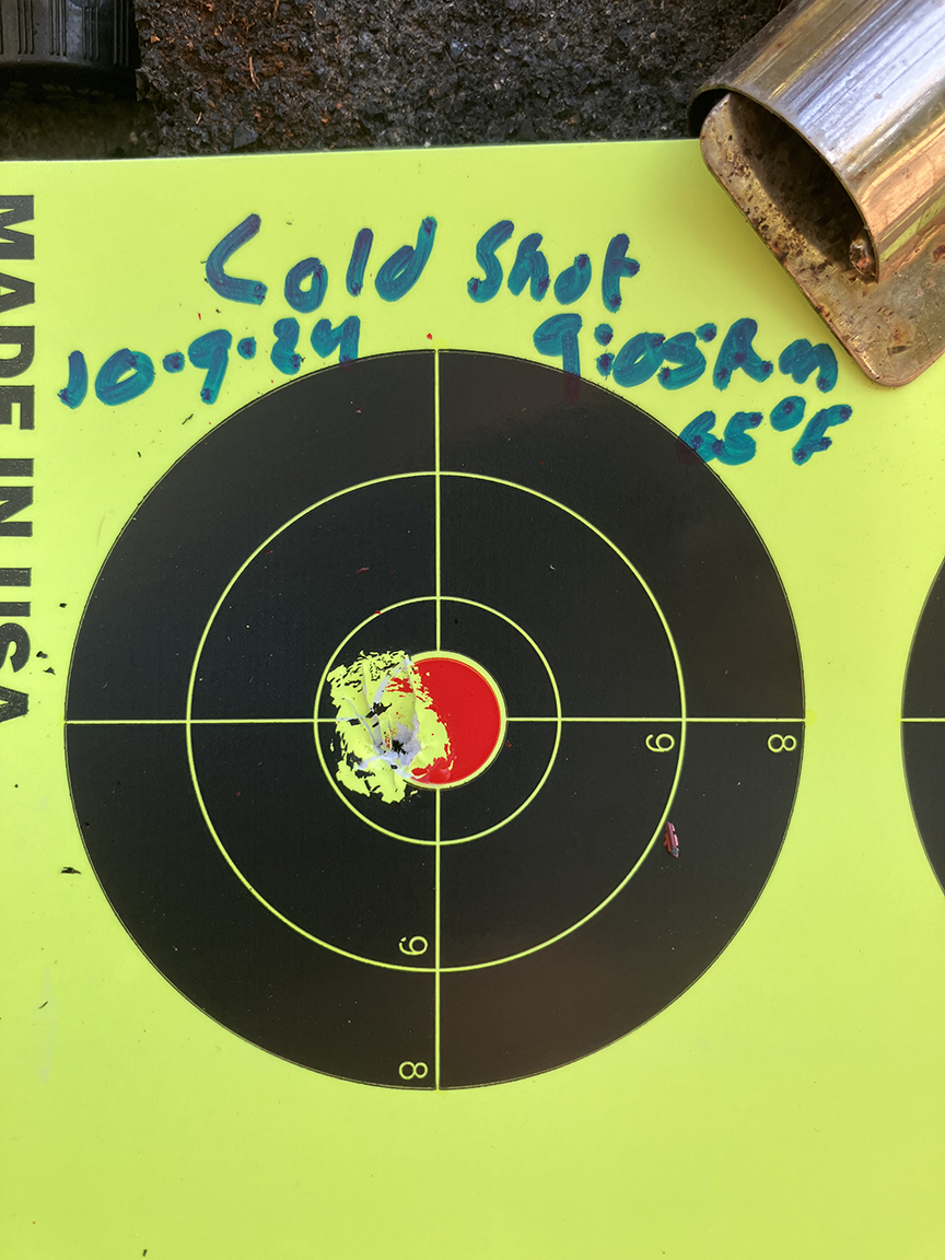

Cold shot #1. No site in or dry fire. Just load a pellet and take the shot.
Time, date and tempreture logged on target.

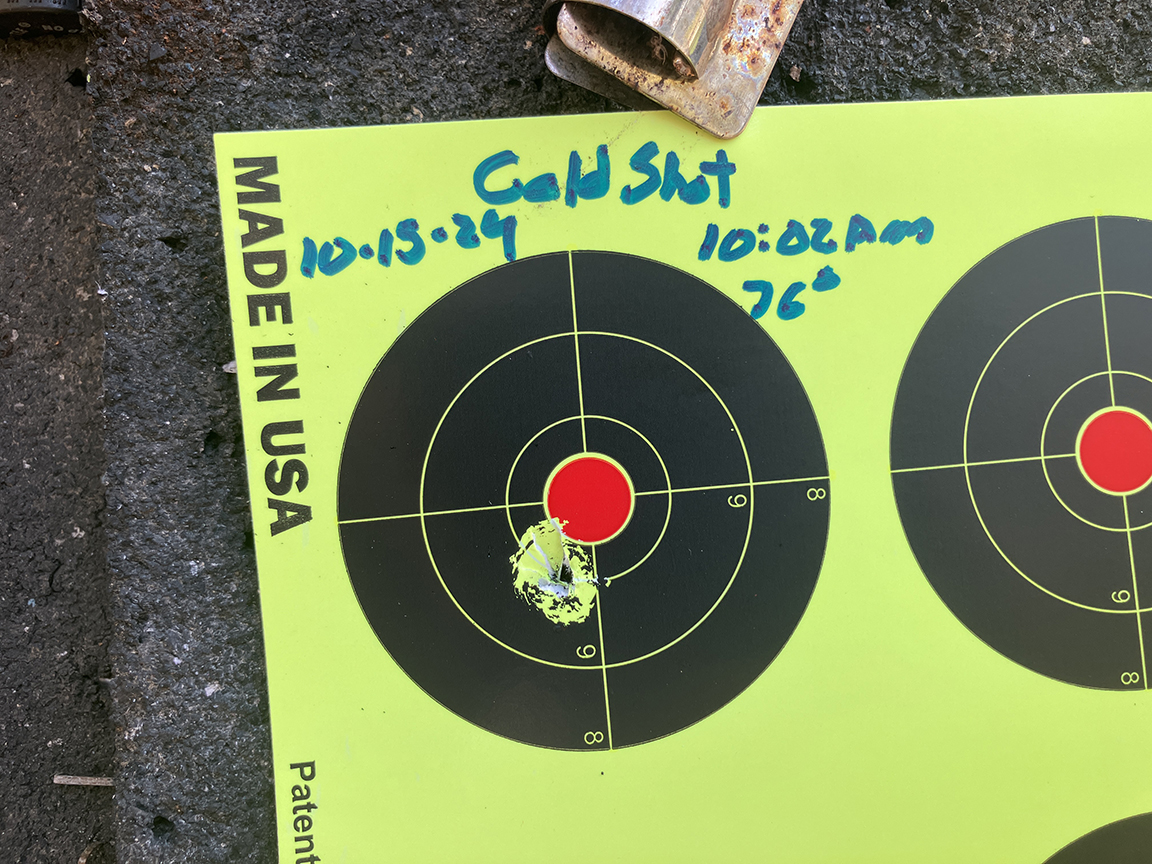

Cold shot #2

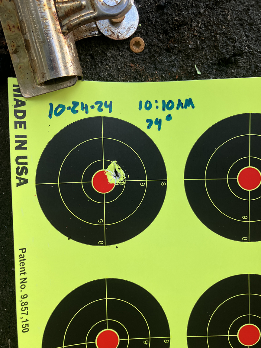

Cold shot #3

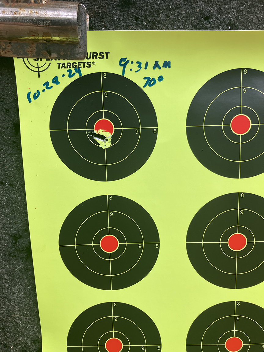

Cold shot #4

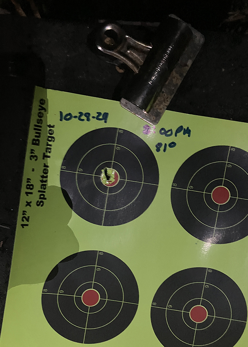

This was this morning and I was going to wait until I got back next week for the fifth shot, but then I thought about why I would be taking a cold shot in the first place.
I am not a hunter, but I did buy my first serious PCP to deal with raccoons that were killing my chickens after the sun went down, so I decided the fifth shot would be after dark.
I do not have a light on my Prophet, so I brought out my TalonP along with it for illumination.
and this is cold shot #5 from just a few minutes ago.
Yes, there are some very minor incosistancies between cold shots, but enough to be a problem? Not for me.

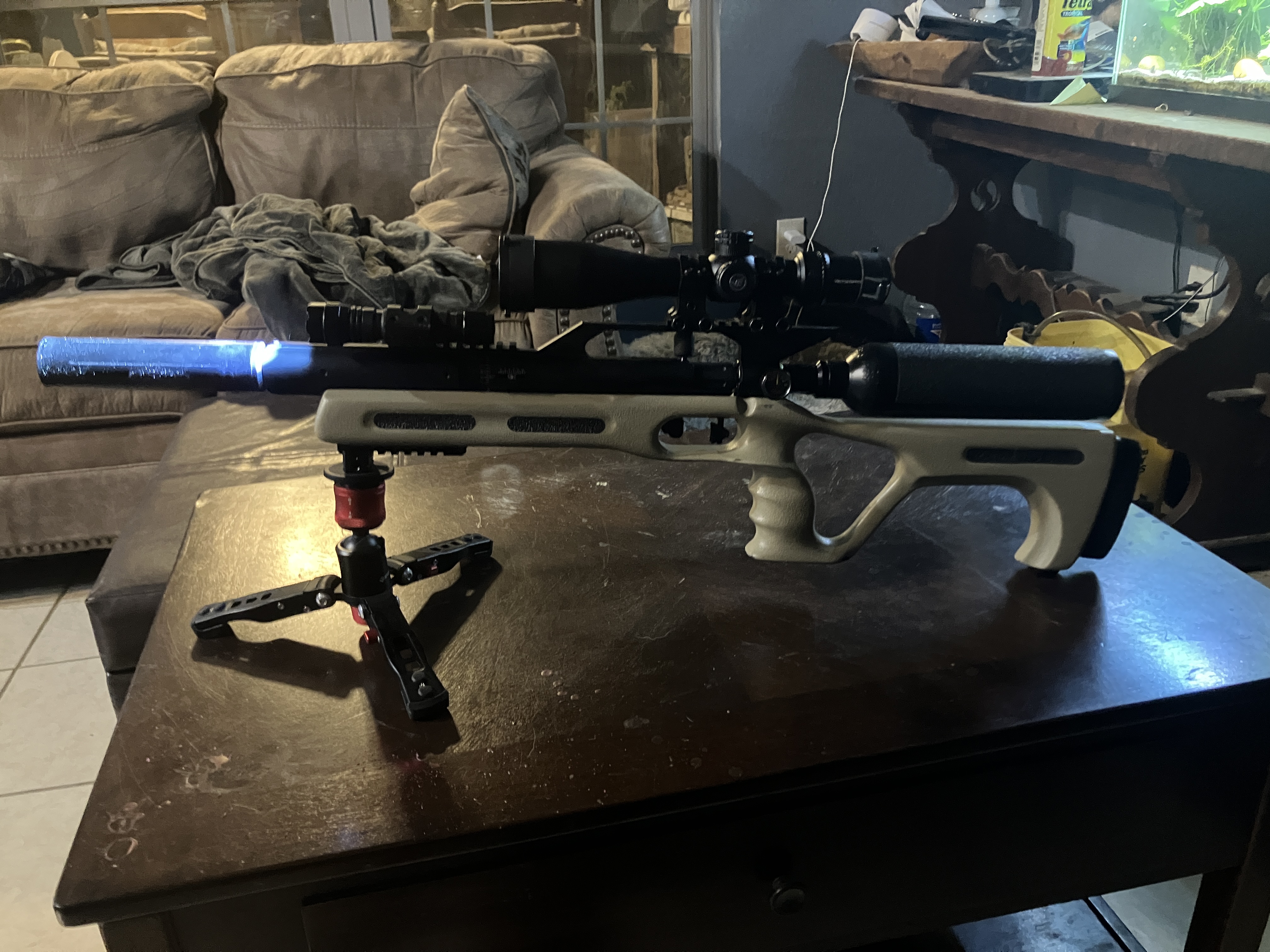

My 0.177 caliber FX Impact M3 tuned to </= 12 FPE, stayed in the van last night with a low of 30°F.
The indoor range was 65°F, it took me 45 minutes to set up. Gun temperature at first shot was 52°F (average of 3 readings at different locations).
Bottle/1st Reg/2nd Reg Bar pressure was 195/160/90. Normal first shot is 200/120/70 respectively.
Checked my plenum pressure dope and increased the Mico 3 clicks as required.
First shot (no sighters) was a 100, on an ARA Pro Target, indoors at 20 yards.
The first 5 shots were all in the 100 ring. Before the 6th shot I reduced the Micro 3 clicks.
After 25 shots (no sighters) the BAR pressures were 200/120/70.
Bottle pressure increased due to temperature increasing.
Plenum pressure decreased due shot count.
It appears, once the plenum pressure dropped to 70 Bar the air volume/pressure between the regulators was all I was using.
I didn't think there was that much volume between the regulators.
The Air valve/Macro/Micro settings are 3/1/1.5 respectively. I haven't checked velocity in a while.
