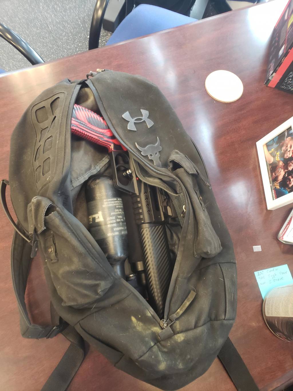

I second this, I have the 300cc bottle on my L2. I always fill to 250bar and I get 6 mags of stopping power. Mine is also a 25 cal and I use mine exactly the way your describing you will carry yours. I always have all of my medication and supplements with me in this bag and then my L2 stores nicely in there.

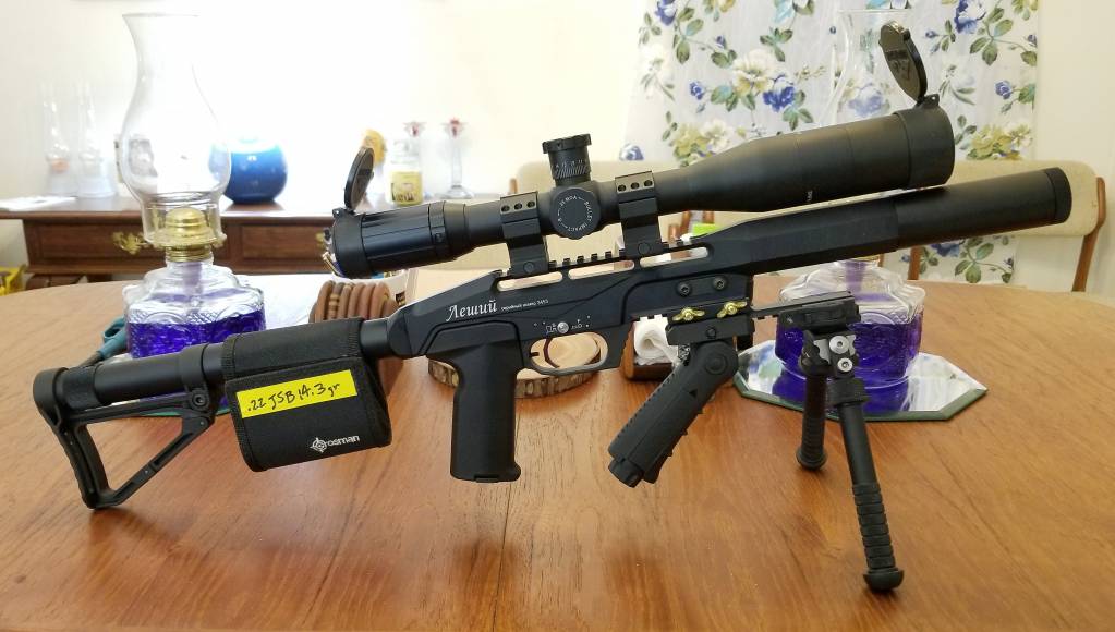

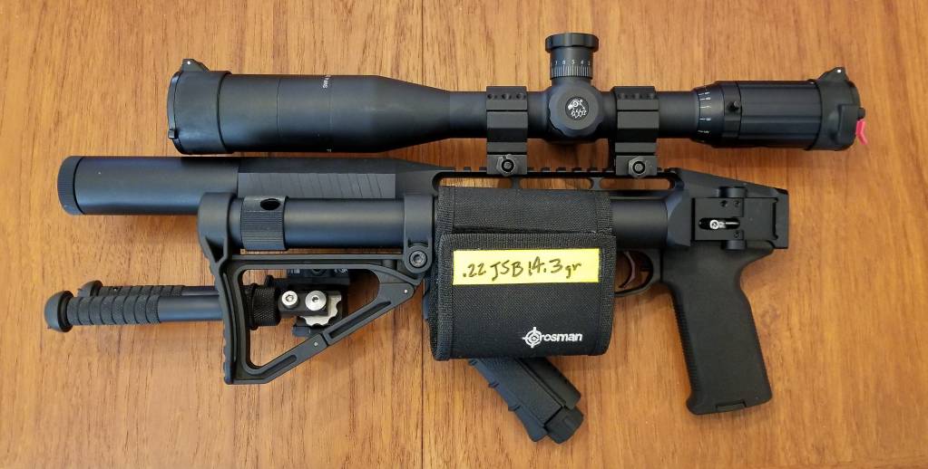

Great pistol, my favorite setup is 350mm barrel, .22 cal, hammer spring 14 clicks CCW ( from full CW stop position, click detents), JSB 14.3 gr pellet @ 865 fps.

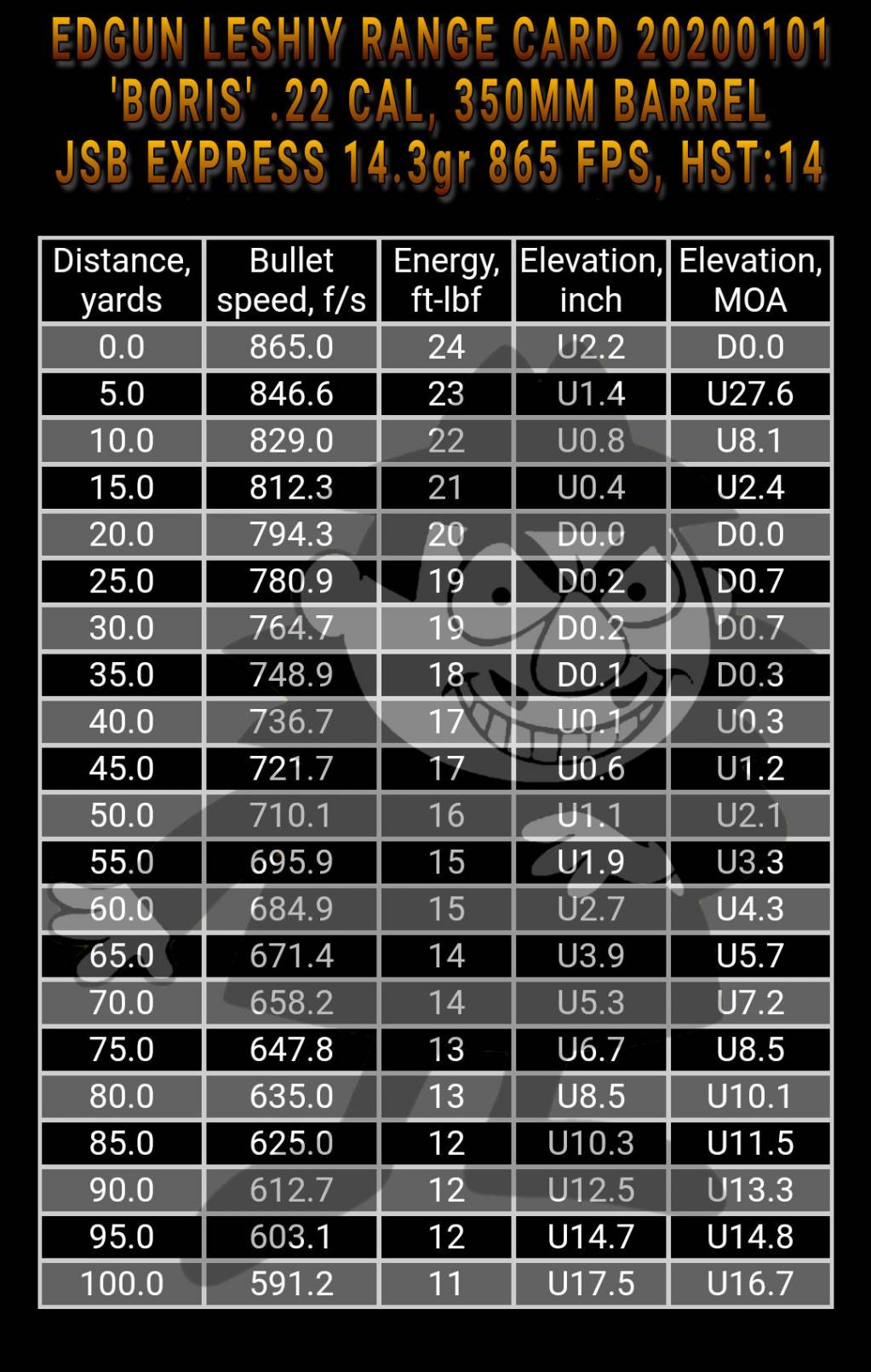

Here's my range table, generated by Strelok pro. Using an SWFA 3-15 scope with high tactical rings, MOA quat reticle. Zeroed at 20yd, see the right-hand column, pretty much point and shoot 20-40yd using center crossing aim point.
