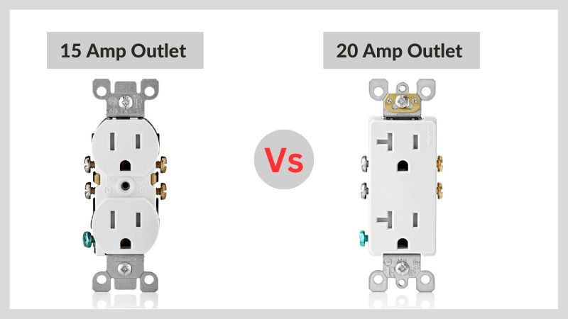

Would the filter tower require additional load, amp draw above 15 amps? Just wondering if this could be the reason Coltri/Nuvair choose a 20 amp circuit and 2 hp motor with the MCH-4 4 110v compressor?The current “Leggero” has an MCH-6 pump unit.

You can order a Coltri MCH-6 with a 110v high current motor, buts it is not a good choice in the USA as it requires an uncommon electrical outlet. Less common than the 220v outlets. If you need a 110v compressor, get the Daystate.
That compressor requires a 20amp 110v outlet. Not the most common, but not all that uncommon in the USA. So it delivers a proportionally faster charge rate, which has nothing to do with the filtration.Would the filter tower require additional load, amp draw above 15 amps? Just wondering if this could be the reason Coltri/Nuvair choose a 20 amp circuit and 2 hp motor with the MCH-4 4 110v compressor?

If it’s a 15amp compressor, adding a filter won’t make it exceed 15amp. The blowoff valve will vent and prevent the compressor from exceeding its design load, regardless of any restriction (plugged filter/line or overfilled tank).The filter could add more of a load of it plugged up but otherwise it wouldn't have really an effect on it
I agree, all the information about the units is accurate, although I think 110 is a bad choice if in USA unless you absolutely can not get a 220 socket installed. The 110 15 amp is pretty standard in the USA. If your contractor was the over engineering type, they might be 20 amp. not only does the high amperage of the 110v model strain your electrical system it is not quite enough juice to run the motor efficiently and more importantly effectively. If you call Nuvair and talk to one of their reps, they can explain it better than I can. I already had a 220v socket in my garage, but if I didn’t I would have installed one. It wouldn’t cost a fortune to have an electrician come and install a 220 outlet, and I think it would be all around better in every aspect. Again, I urge you to talk to Nuvair, they aren’t going to try to up-sell you if you call. In fact, Mitch talked me out of a few things I thought would be useful and steered me in a better, more wallet-friendly direction.The current “Leggero” has an MCH-6 pump unit.
Thank you. I am trying to help out a friend that wants to stick with 110.That compressor requires a 20amp 110v outlet. Not the most common, but not all that uncommon in the USA. So it delivers a proportionally faster charge rate, which has nothing to do with the filtration.
In the USA, 110v circuits are 15amp or 20amp. When you have multiple 110v outlets on a 20amp circuit, they should be 15amp outlets. A single 20amp outlet is used on a dedicated 20amp circuit.
If you want to run off any 110v outlet, get the “Leggaro”. If you have a dedicated 110v, 20amp circuit and want a little higher throughput, that “MCH-4” might be a good choice. If you want the highest throughout and have a dedicated 220v outlet, get a 220v Coltri MCH-6.
