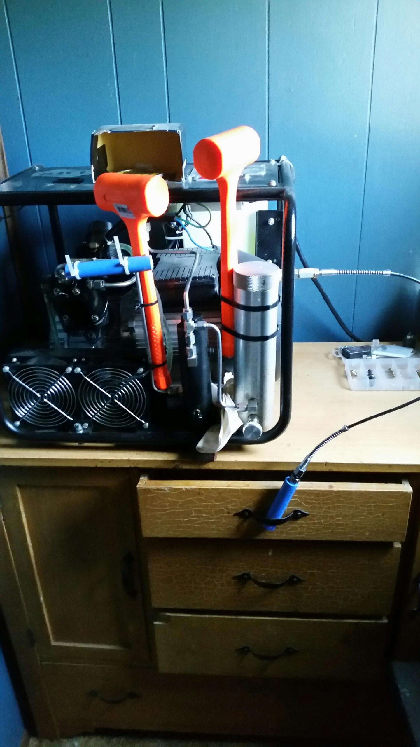

Anyone have a photo of the filter setup? I need to get a filter and thinking of buying maybe using one from Coltri.
Ther is a double filter bracket, steel line that goes from the water separator tower to the final drier filter. Very easy to install,and the air is wicked dry. Nuvair has the kits. 250.00 price but I think it’s worth it.
