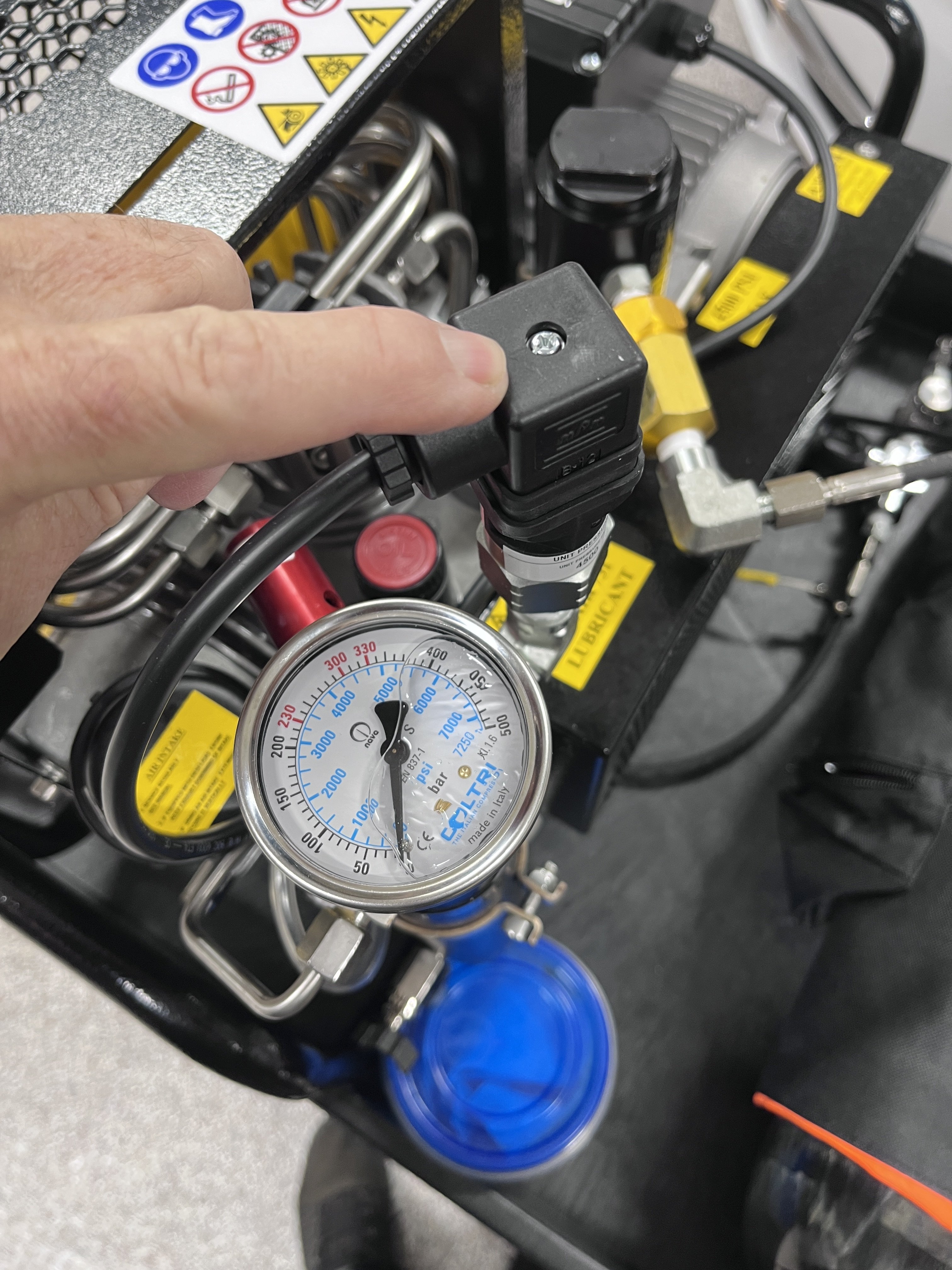

Does anyone know if the pressure at which the automatic shutdown kicks in can be modified? I'm not talking about the safety valve but the optional automatic switch.
The unit should shut down at 300 bar according to the specs. When I got my compressor 6 months ago it shut off at 310 bar (which is ok for me, after a bit cooling down it's about 300 bar). But recently I've seen that the pressure has gone up. First 320 bar, today 325 bar. So does anyone know a reason for this shift? And how to bring it down again?
also: my compressor is inside the house in an area which is not heated a lot (a shed). The floor on which compressor and bottle are is rather cold (room 15 degrees celsius, the floor about 10). So in the autumn and summer it's warmer in my shed. Could this influence the auto shut-off pressure?
