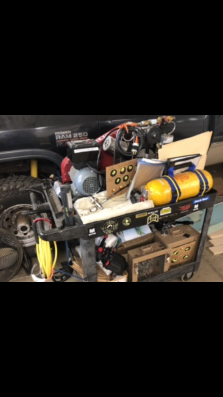

That's a great tip. C'mon you Coltri owners, lets see some pics.

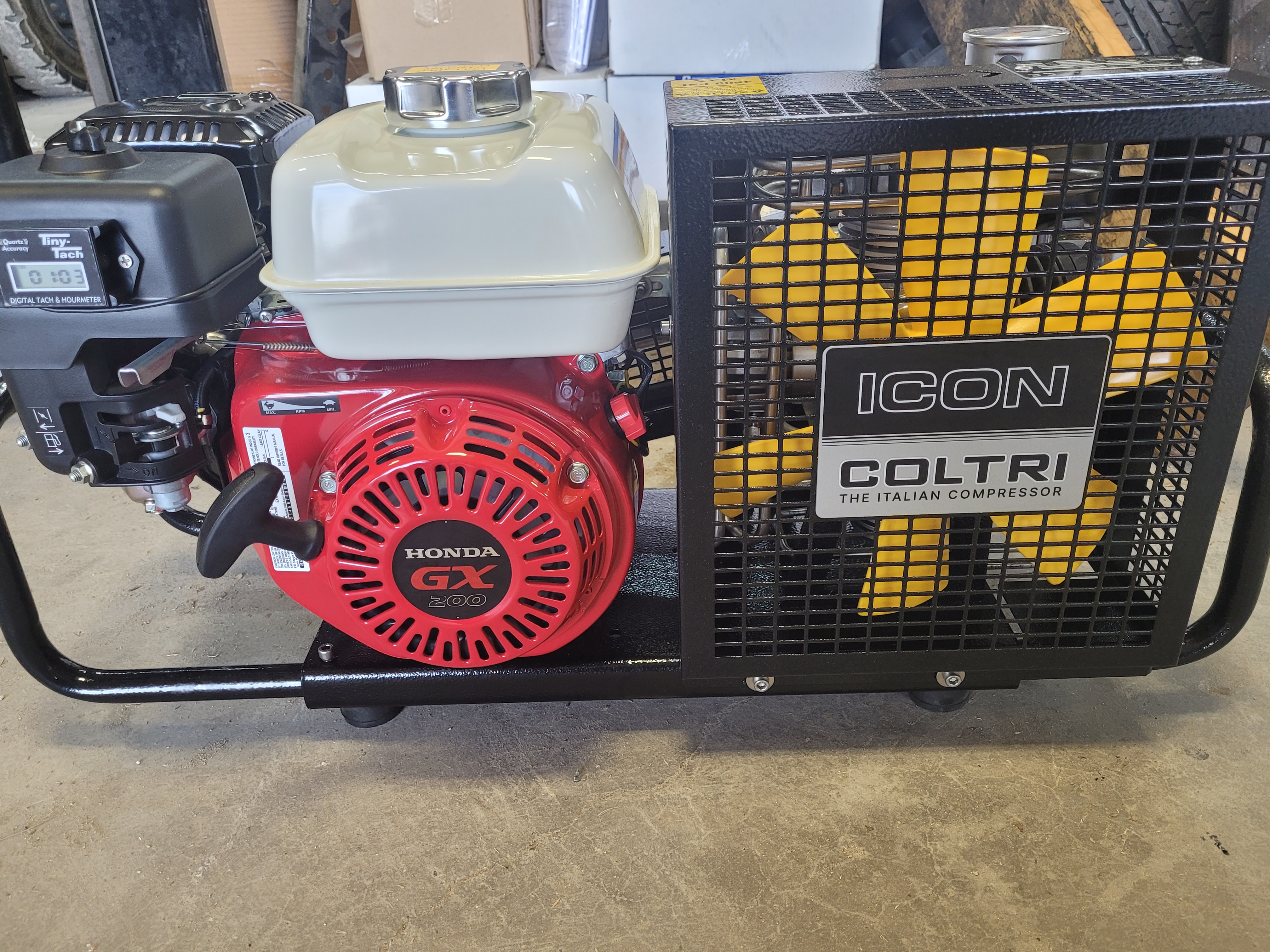

Must have been a mistake ?
Some good looking "old stock"
