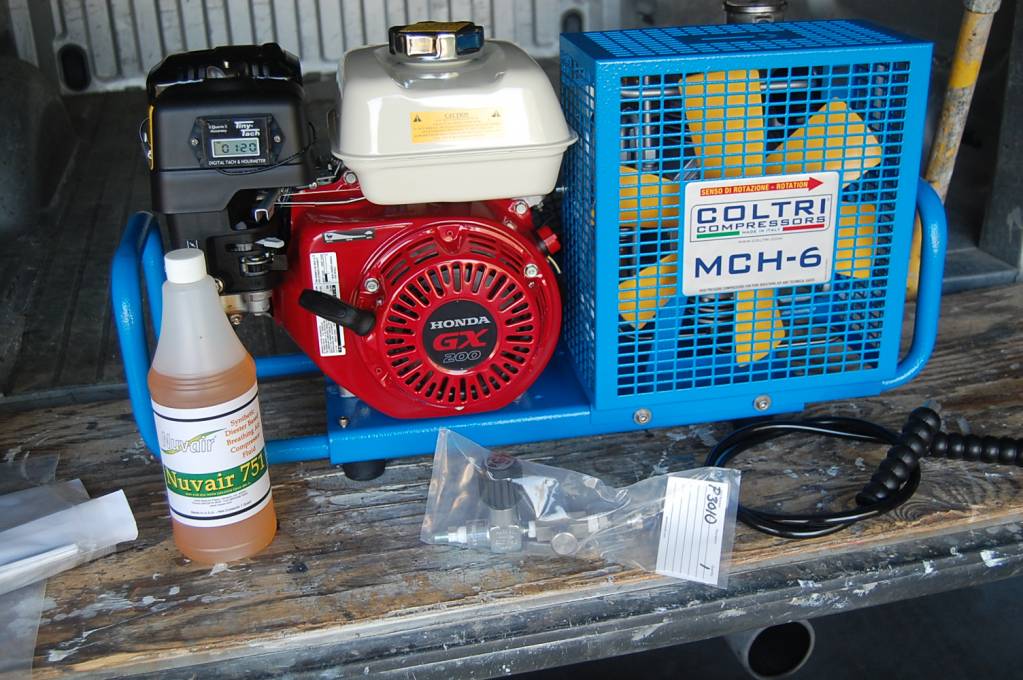

Something I have noticed is that there are almost no complaints about the performance of the Coltri MCH-6, on this forum. Also, it remains on sale in the US- in the gas powered version. I will admit, I am partial to this platform, as I have one and have used it since 2014 with no issues other than oil changes.
Also- I have noticed that Daystate stopped selling their ‘Type 1’ version of this compressor, and now only sells the high end ‘Type 2’ version. Airguns of Arizona still lists the ‘Type 1’ version, but it is not in stock.
For actual Coltri MCH-6 users- have you had any significant failures that required a rebuild?

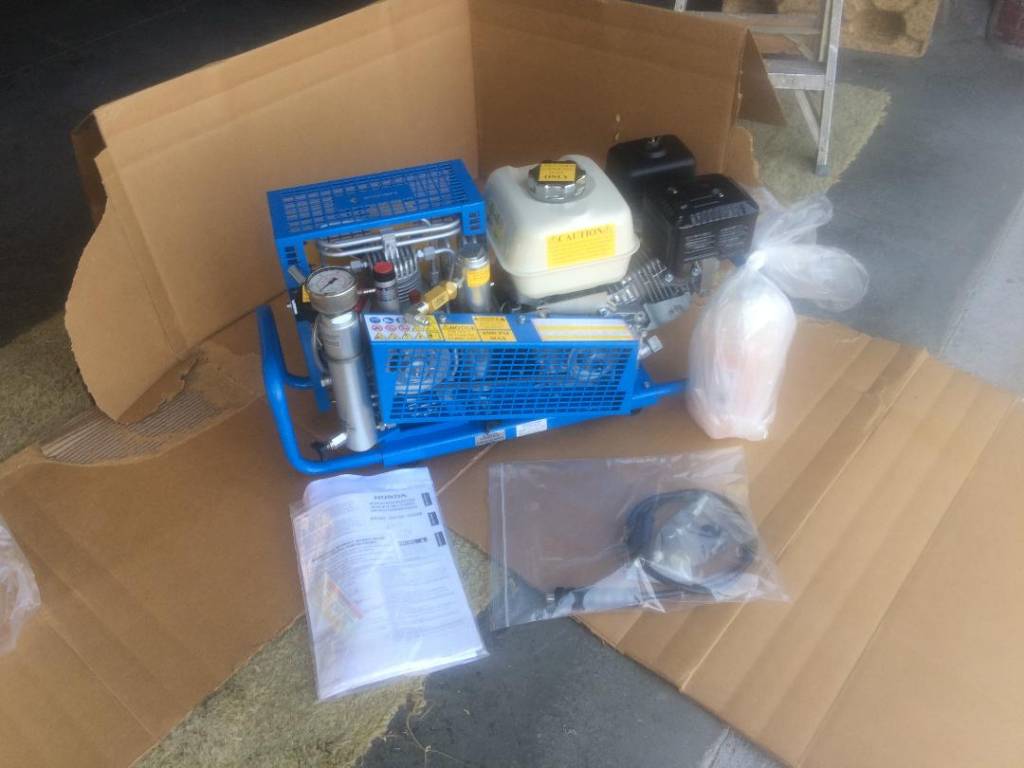

I have had mine for about 1 year now, I have NOT had a single problem or worry, I get face cramps from smiling. I should go do my 1st oil change. I don't have the 50hrs run time yet but I am a firm believer in annual oil changes for machines that do not get to the hrs of run time to need more frequent oil changes
I have not read of any regrets about buying the Coltri MCH-6, I am very happy with mine

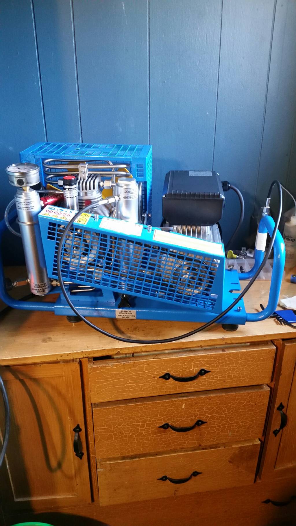

I have MCH-6 two years now. Had some problems with gun so have not used it much. Less than 10 hours. Electric 220v version. I had the gauge leak all its fluid out for some reason. I called coltri, they said this happens all the time. The rubber plug fails and leaks the oil, the gauge still works perfect without any oil. They said I have to buy the new gauge at $65.00 because I was 2 months out of warranty. Kinda surprised about that, because the girl told me it happens all the time. Disappointing for sure. I will only buy a new gauge if I ever sell the unit, it works fine. Love mine the times I have used it.

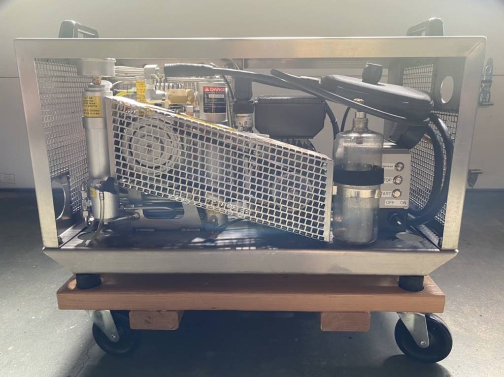

My advice would be remove the cage completely when changing the oil, apart from that the DAYSTATE unit (which is not exactly the same as the COLTRI original) is brilliant!
The owner of DAYSTATE and the owner of COLTRI are friends hence the competitive price of the DAYSTATE unit which has extra features over the COLTRI original, the COLTRI distributor here in the UK could not match the price of the DAYSTATE badged unit even though it has the extra features, a first if I ever saw one!
