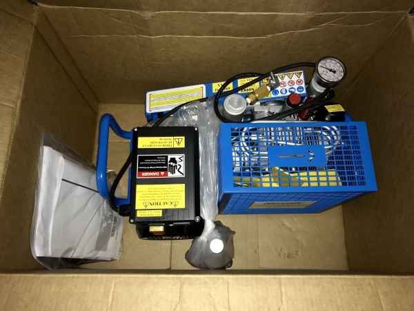

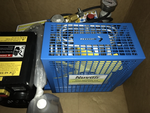

After a great deal of research, along with many answers to my questions provided by you, my Coltri/Nuvair MCH-6 compressor is here. This is the 220 version (8014) and is actually less expensive to buy from Nuvair than the similar Daystate model, that was just released. Additionally, the Coltri/Nuvair is a true dive compressor, set up for breathable air. Should we ever want to sell, potential buyers include the entire dive community, in addition to air rifle/air pistol shooters.
During the purchase I spoke to the good people at Nuvair (Craig, mostly) repeatedly. They answered all of my questions, and gave me many different options. In the end, my compressor was configured exactly to my specification. I found it very important that Nuvair test runs all of the compressors they sell, before they are shipped. Shipping was fast, and acceptance of the delivery, easy.
I selected this model, over the Coltri Compact/Daystate type 2 based on Craig's recommendation. Basically, the Compact/Type 2 is designed to travel in the back of a vehicle on a regular basis. This model is designed to be stationary, costs less, and is easier to service as there is no cage to remove each time service is needed.
Rather than upset my spouse, by sharing her clothes dryer outlet, I am having a dedicated 220 line installed next week. A full review will follow.

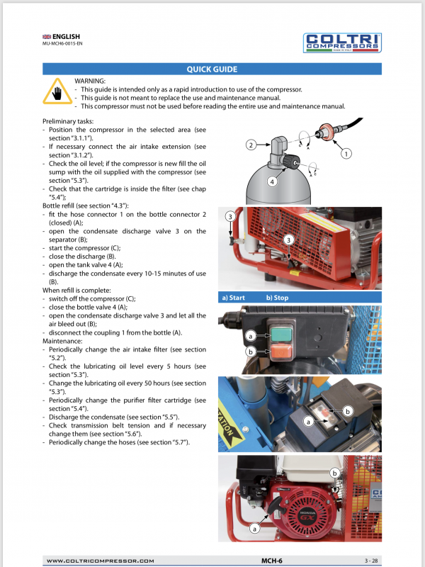

Finally, what I have to offer-
The compressor is really quite simple to use. I am very glad that I did not spend extra money on the automatic condensate drain or the automatic shut off. They simply are not needed for most routine fills, that are not from empty. I find that I can hook up my tank, start the compressor, and fill each tank in about 5 minutes. (I am filling from roughly 150 BAR to 200 BAR.) Once I reach the desired pressure I open the condensate drains, close the valve to the tank, and shut off the compressor. Then I simply purge the air relase valve at the tank, and I am ready to go. It really is that simple.
I am attaching a photo of the quick reference page I hung up in my work area, which explains this process.
As a recommendation, I simply would not waste additional funds on the auto drain, or the auto shut off. If you are using this compressor you are probably like me, and you will stay beside it until your tank is full. Also, Nuvair is a big enough company that has the knowledge, and know how, to provide support for this machine, in North, and South, America for years to come. That means a great deal, to me.
