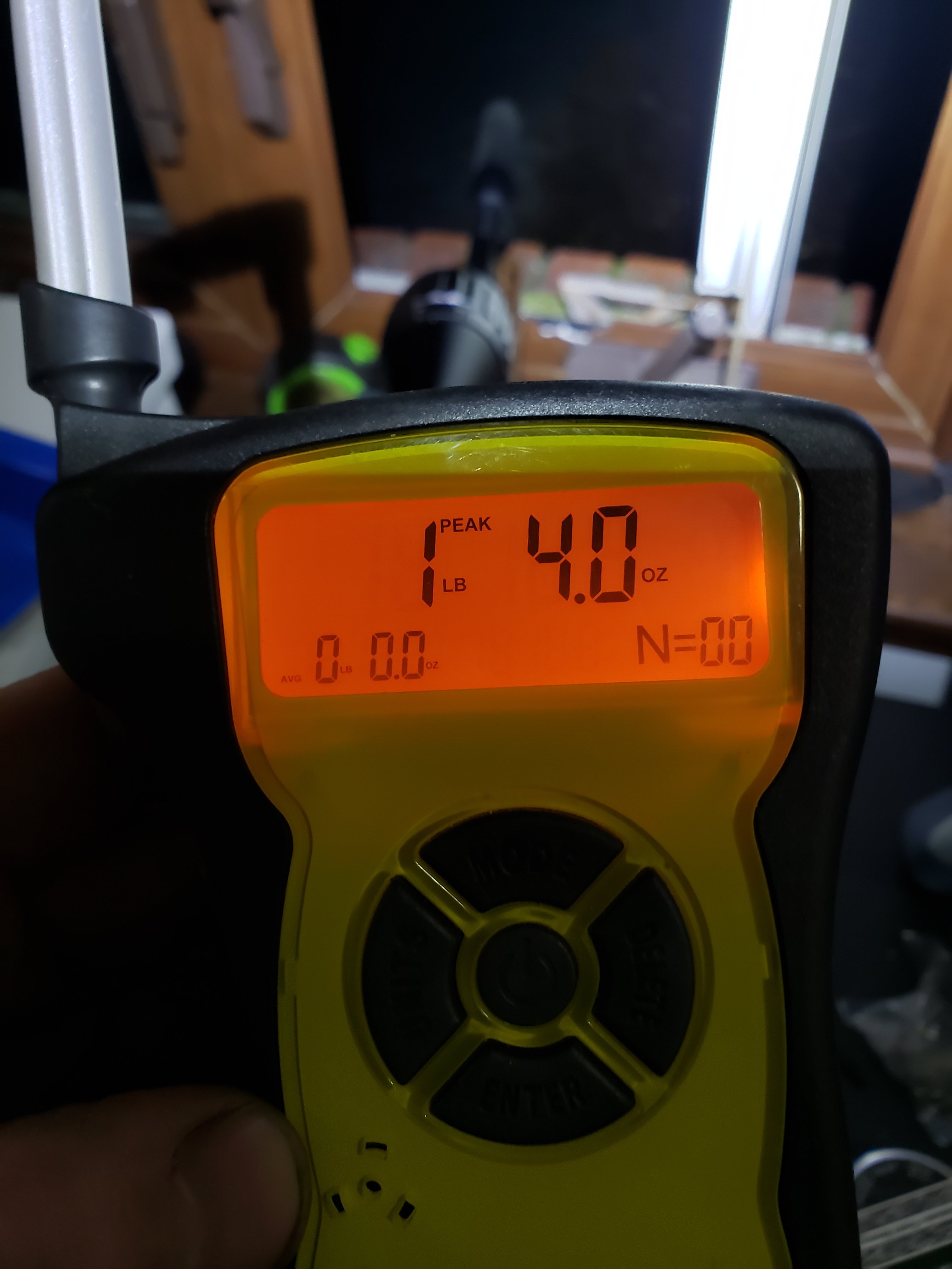

The gun cocks easy with a great two stage trigger
Jon from Keystone air did a get job tuning. really liking the gun Cometa brand a diamond hidden in the rough!
P.S. this has maybe 50 pellets thru it so far.

The 400 triggers are decent and can be adjusted to a predictable wall with a clean break at about 1.5lbs out of the box. That being said they're definitely not the cleanest pulls and if you're looking for a Rekord out of the box, this isn't it. In all fairness though most of these guns are under $300 (some options closer to $200) which is pretty budget friendly all things considered. I like to think of them as great beginner guns/low cost plinkers or even better as lightweight woods walking guns.
