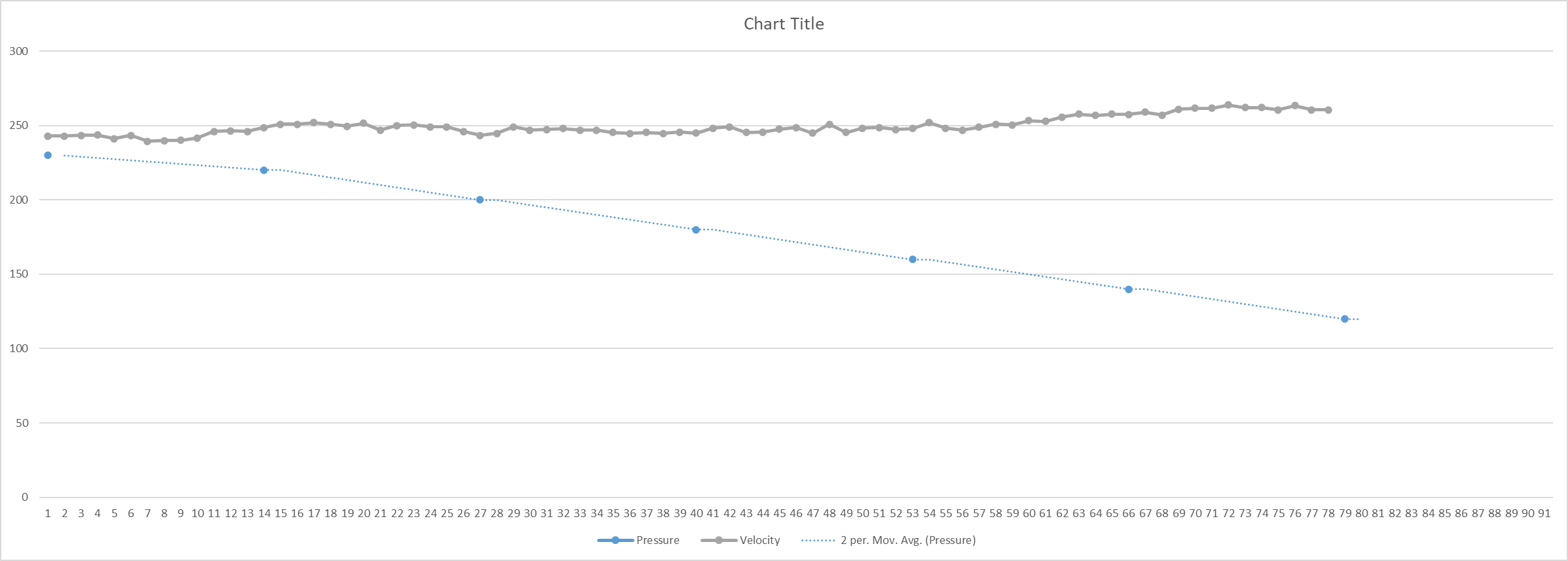

Tuning with hammer spring tension only gives about 60 good shots at this speed then when the reservoir pressure reaches around 140 bar the velocity starts going up (resulting in changing the point of impact, and louder sound)
Given the relatively small tank volume (330 cc) and the maximum fill pressure of 200 bar.. I was hoping to increase the working pressure range to reach under 100 bar

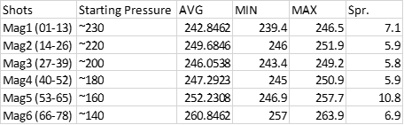

Update:
Here is what my cronograph readings look like with current tune.. Best accuracy acheived @800fps
The pellets are directly out of the tin so some variations must be due difference in pellets weight
