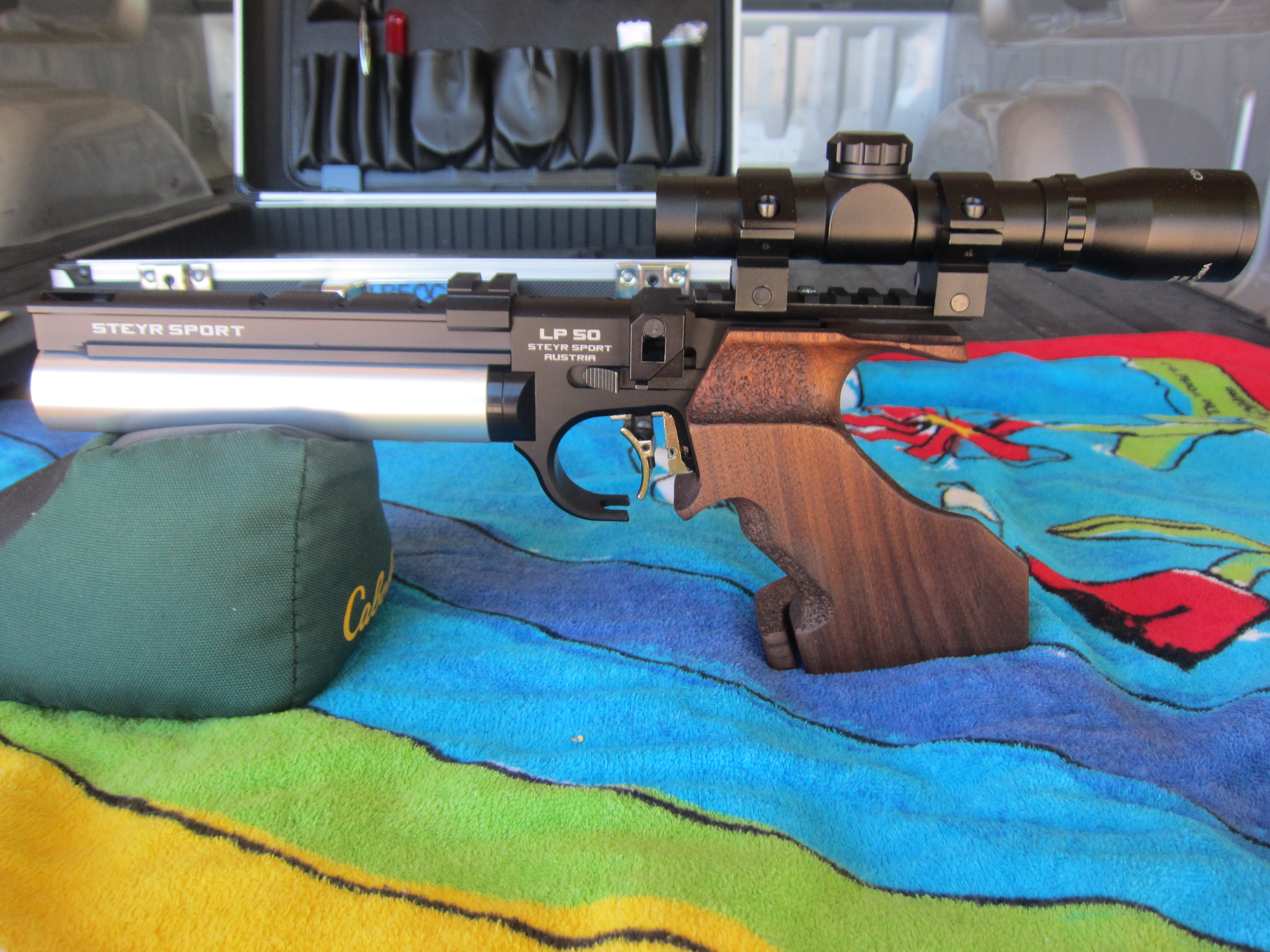

This is a mount I made for my LP50. It is about twice as long as the Maple mount. I can't remember which scope this is but the position would be similar on your pistol but probably have to be a little further back. You can also see the weaver mount I linked to on the barrel shroud. You have to remove the front sight to slide it over the shroud. Imagine two of them holding the scope rings.
