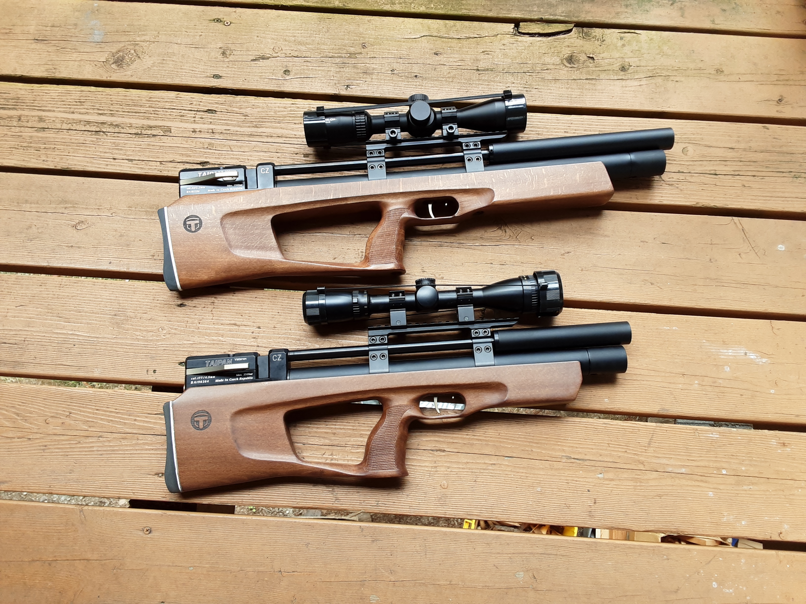

Kalibrgun Cricket 2 45 OA length of 27.7" it will give you 130 shots shooting the 15.89gt oellets at 860fps and it has a max power of 40-41fpe ( which will give you about 55 shots)without messing with the regulator. You can easily adjust the power with the HST on the back. It will shoot pellets phenominally and light weight slugs 17.5gr NSA just as good and even better at longer distances. My one con of the gun is that it has a slight ping to it. If you're used to guns with no ping, it may take a bit to adjust to it. Also mags are cheap, compared to every other high end gun, at about $38 and in .22 they hold 12 rounds

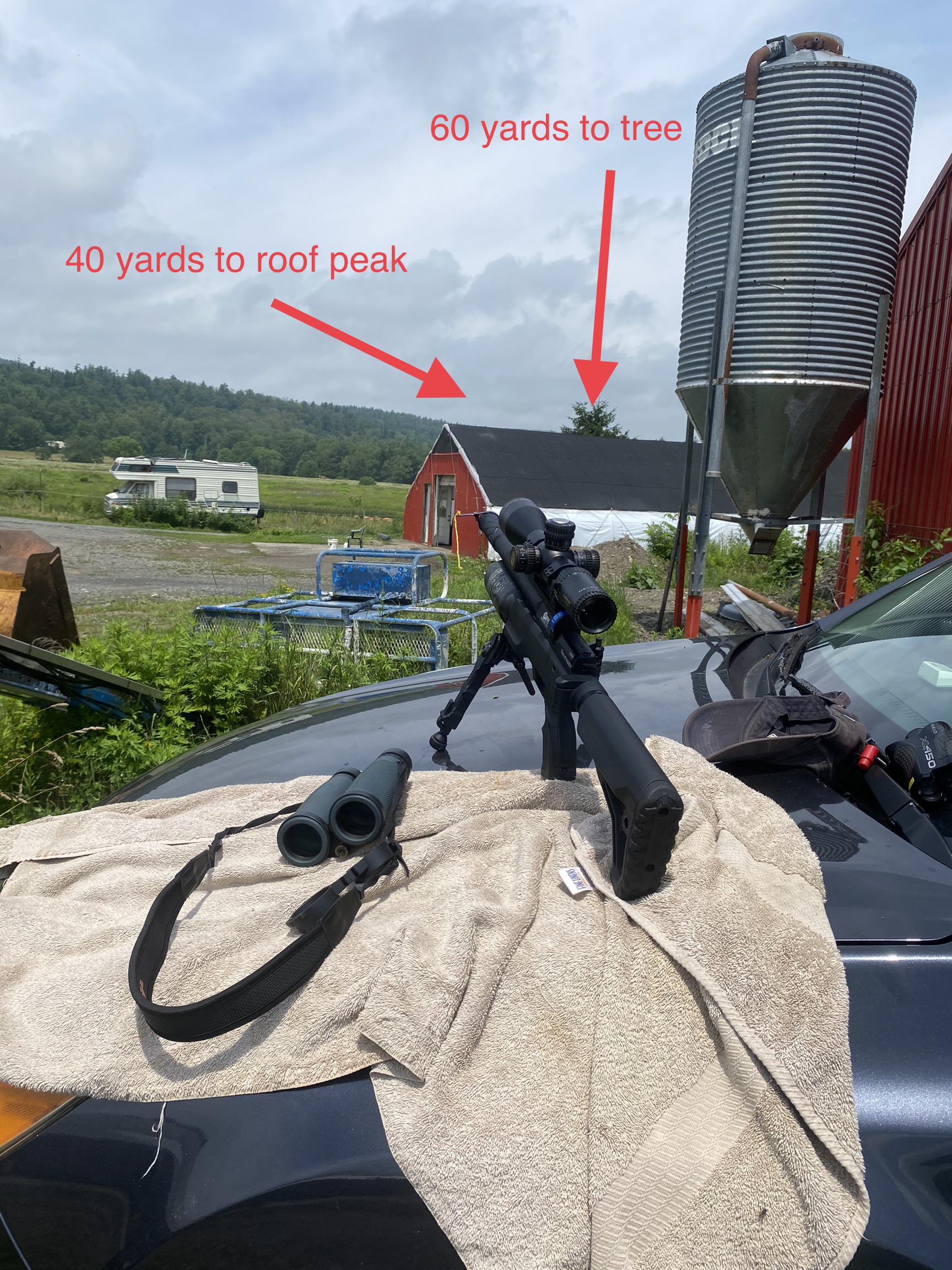

Either one of these. The compact in.177 gets shot more when I'm just plinking . The top is .22 cal and around 34 fpe . Great triggers and you can't double load even if you try .

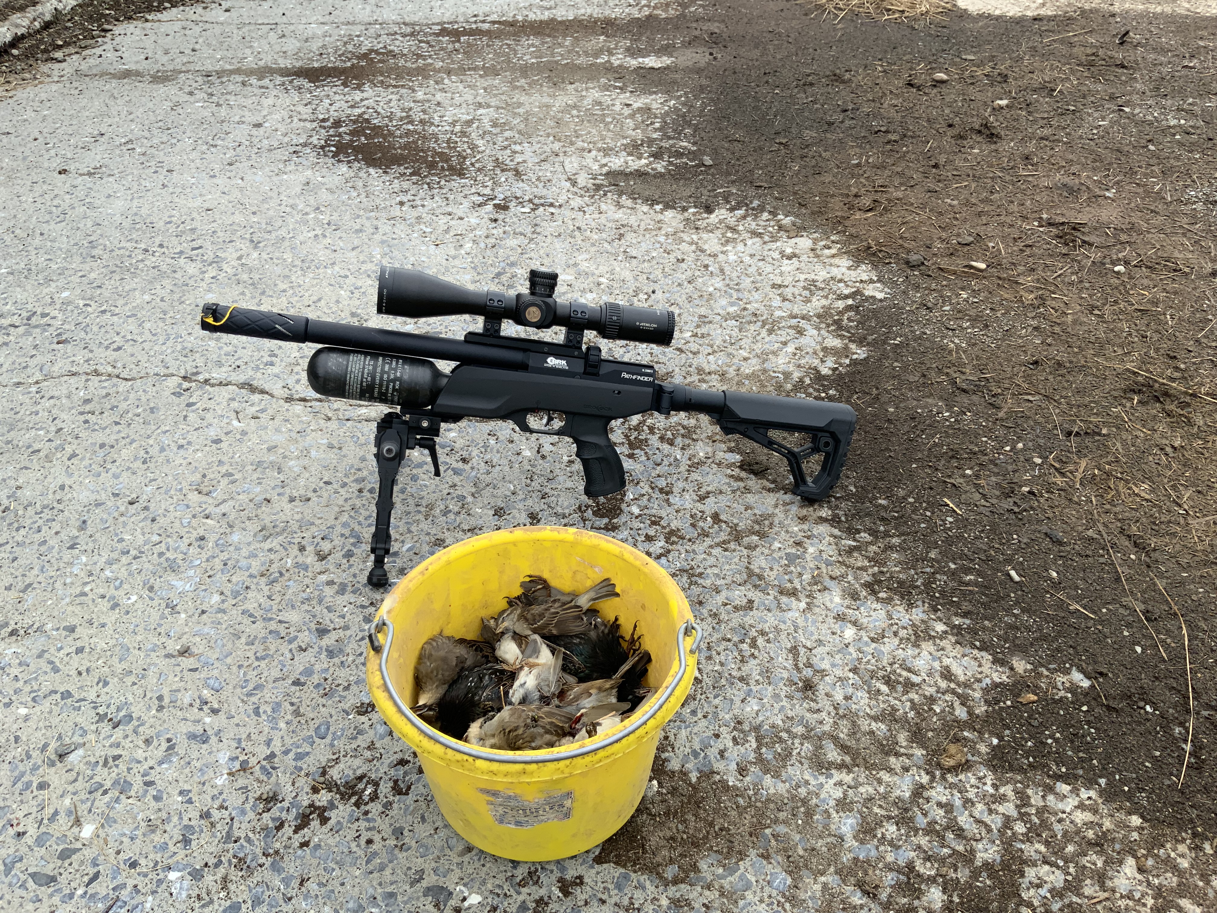

Have you considered a BRK Pathfinder? Its a superb little gun that ticks off a lot of your requirements… I plink and pest with mine.
