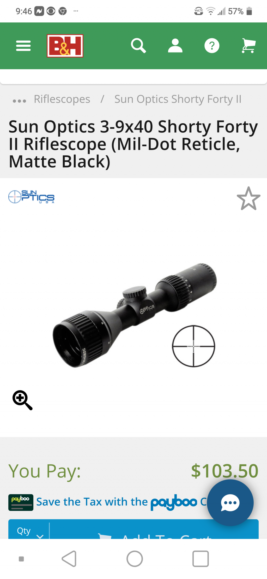

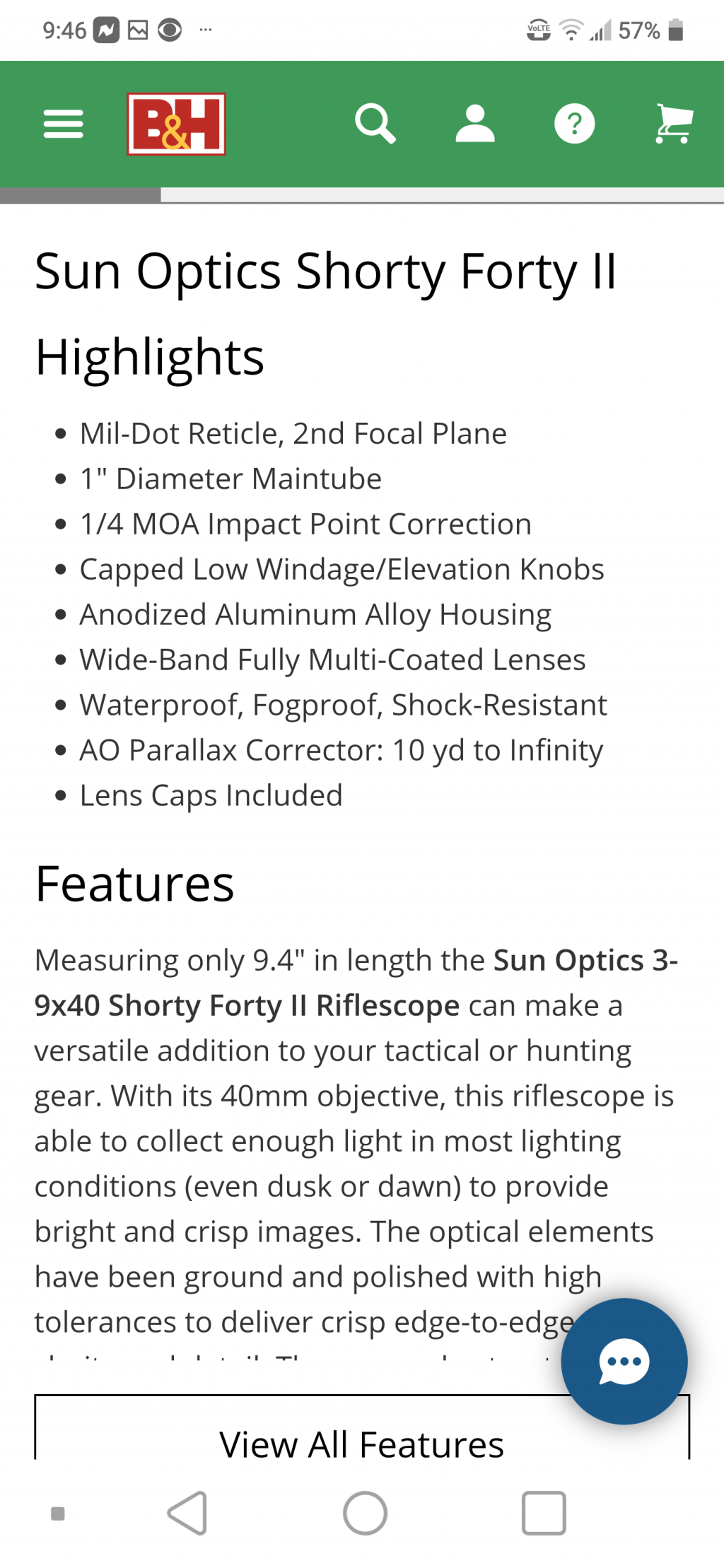

Dillon, check out the shorty forty ll. Big 40 obj to let light in. I like. Tommy

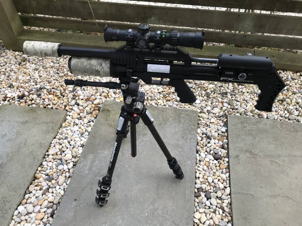

The Athlon Ares ETR UHD 3-18×50 has spoiled you so not sure you'll be happy with any of the suggestions so far. After glowing reviews, especially the one by Chuck, I bought an Athlon Ares ETR UHD 3-18×50 and mounted it on my edgun. Yes, it's a very heavy rig but it's set up to shoot prairie dogs from a bench. Wouldn't consider carrying this setup afield. I like this combination for my specific needs and can't wait to get it on some prairie dogs.

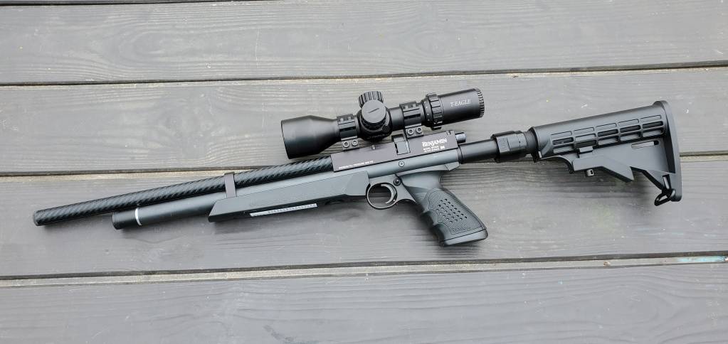

Recently acquired a cricket mini carbine to replace my ranchero carbine for my pesting needs. Wanted glass that was on par with the Athlon Ares ETR UHD 3-18×50, with a similar reticle (I like the APRS6 reticle a lot for my needs), lighter weight and an Illuminated Reticle option. Found out this is a lot to ask for. I ended up with the Hawke Frontier 5-25 X 50 with the new H7 optics. It's SFP vs. FFP, is basically the same length as the Athlon Eres, has a similar reticle, and only weighs 2/3 of the Athlon. I've only sighted this combo in and started to mark my side wheel but so far I like the glass. Oh by the way, if you want a sidewheel, it will have to be custom made. Eric Sanders made mine.
