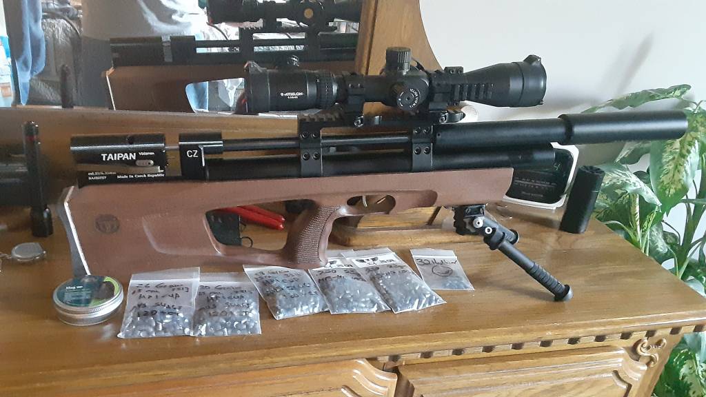

I received an Athlon Helos 2-12x42 from Camerland this week. They are in stock. The scope fits perfectly on a Taipan standard. I am not a fan of lighted scopes, but I like this one. No huge battery “hump.” One does not need to turn the illumination on, either. Reticle is very compact and straight forward.
Looks great! What rings do you have on it? I actually just ordered one from Tyler at MK Machining as I get all his goodies for my scopes anyways. Had 5 in stock. The height looks pretty good on yours at least clearance wise.
Dairyboy- “Looks great! What rings do you have on it?”
Those are a Vortex version of Seekin Precision’s PMR rings at .97 inches high. (Seekins makes these rings for Vortex and the two versions are identical, except for the ‘V’ or ‘S’ logo on top.)
The 42 mm bell of the scope does not completely clear the rail, which is okay as the the eye relief is perfect for me. If one wanted to be sure to clear the rail, using the PMR rings and the Helos 2-12x42 scope, I would suggest they pick the 1.26 inch height scope rings.
