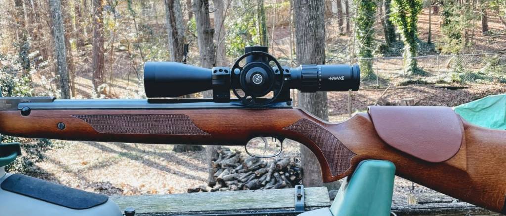

Hawke 4-16 x 44 mm IR, SF compact on HW95L using Hawke Tactical 2 piece medium rings leaves less than 1/8" clearance for objective lens.

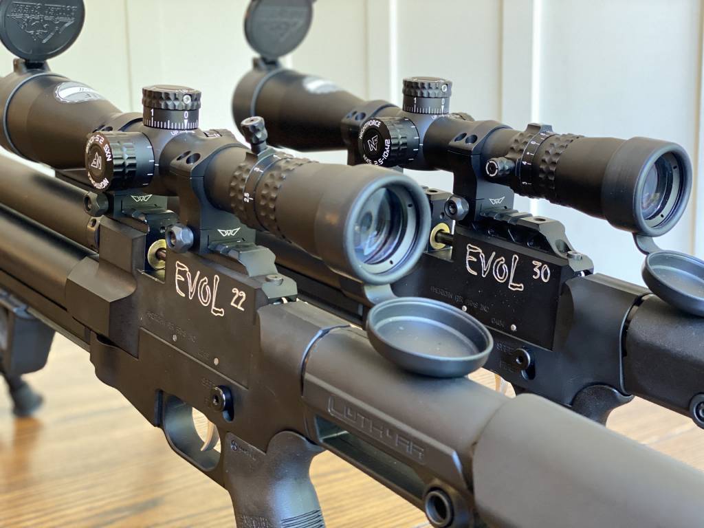

I eventually bought a 2nd Helos G2 2-12x42 DMR.
This is a scope I always want on hand because it's crazy versatile.
It's not a benchrest scope but it is capable of so much else.
I have mine on the rifles more suitable for pairing with. The main being Steyr PRO X which it seems perfect for. Great for shooting fast on small steel in offhand since the reticle is on the thicker side.
I've used them on other airguns even past 100y and find that on normal sized steel there is little disadvantage compared to 6-24's or similar because my airguns aren't moa capable most of the time anyway.

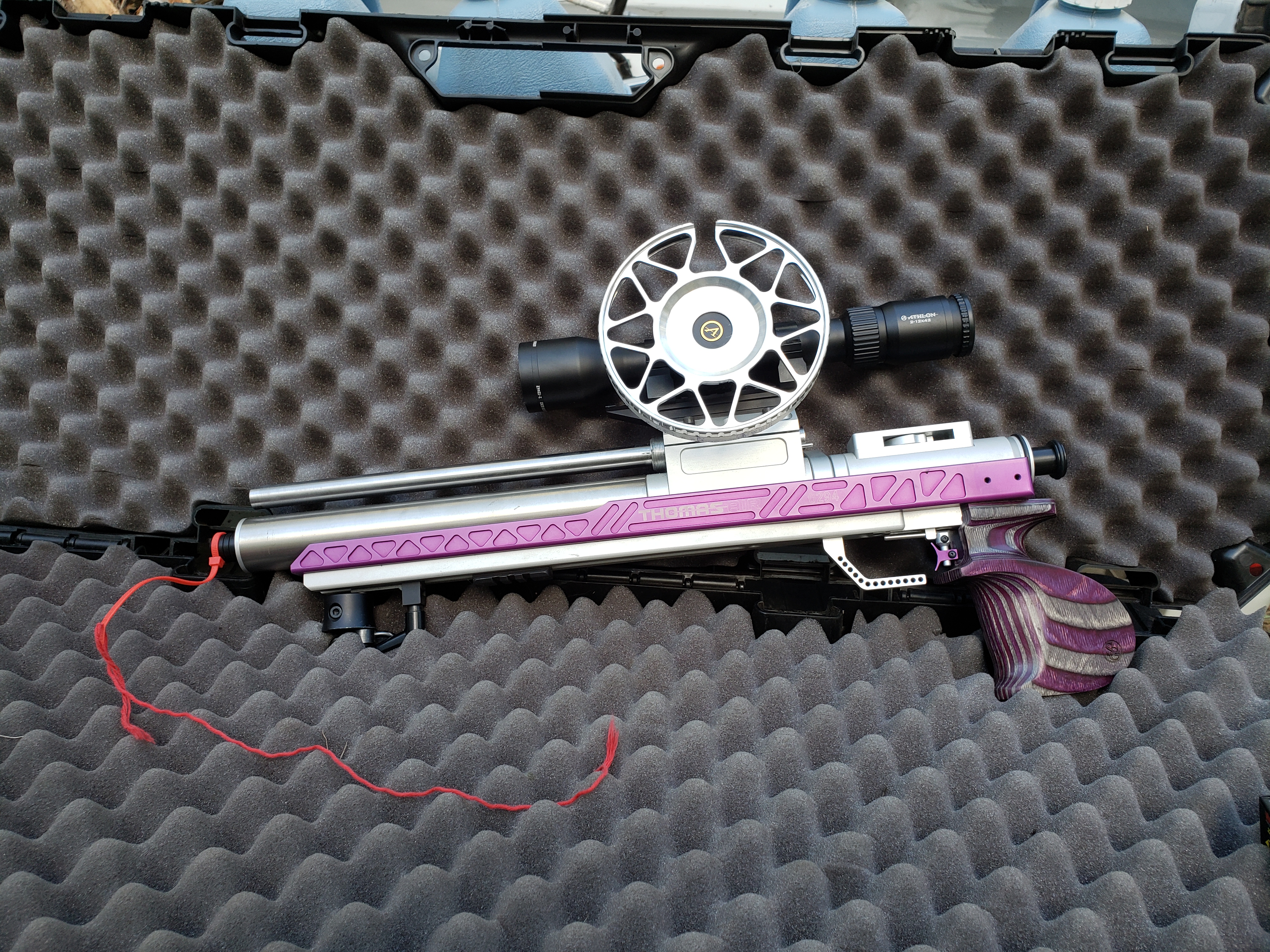

Recently I put one of these on my converted Thomas PFT pistol for the AZ state match. It was so awesome for this event!!! An easy to see reticle and the scope ranges darn good. It helped me win the event.
I named this pistol PRP/Purple Reign Pistol. Or The PERP which is also short for Perpetrator, lol.
