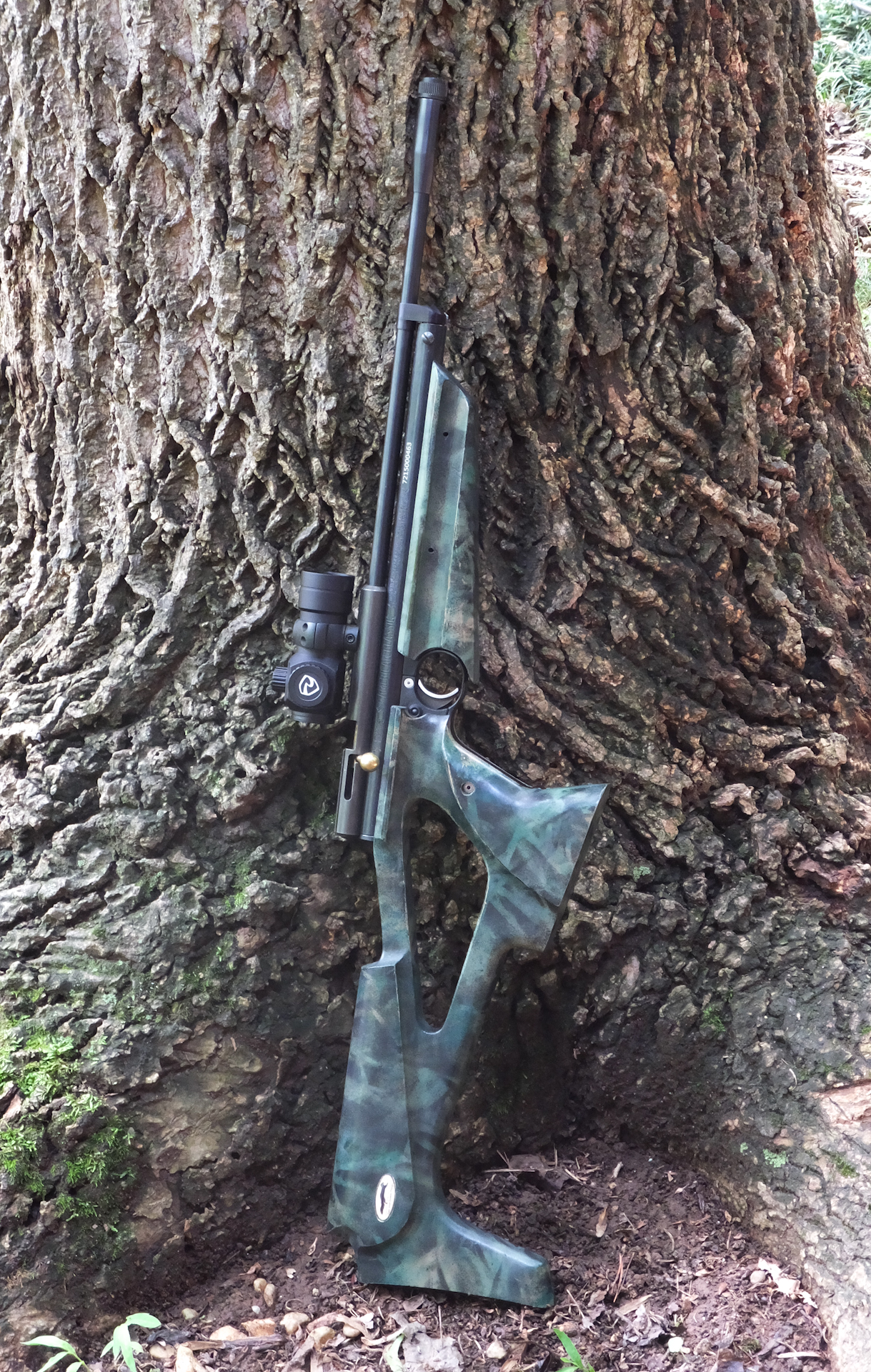

My 1322 has a riton 2moa red dot. For the cost, I can't find a better red dot sight.
Also have one on my Grand Prix as well. I used ohhunt low 30mm scope rings... these rings in particular have been hard to find recently. They clamp from both sides onto the rail, unlike most scope rings.

My 1322 has a riton 2moa red dot. For the cost, I can't find a better red dot sight. View attachment 382022
